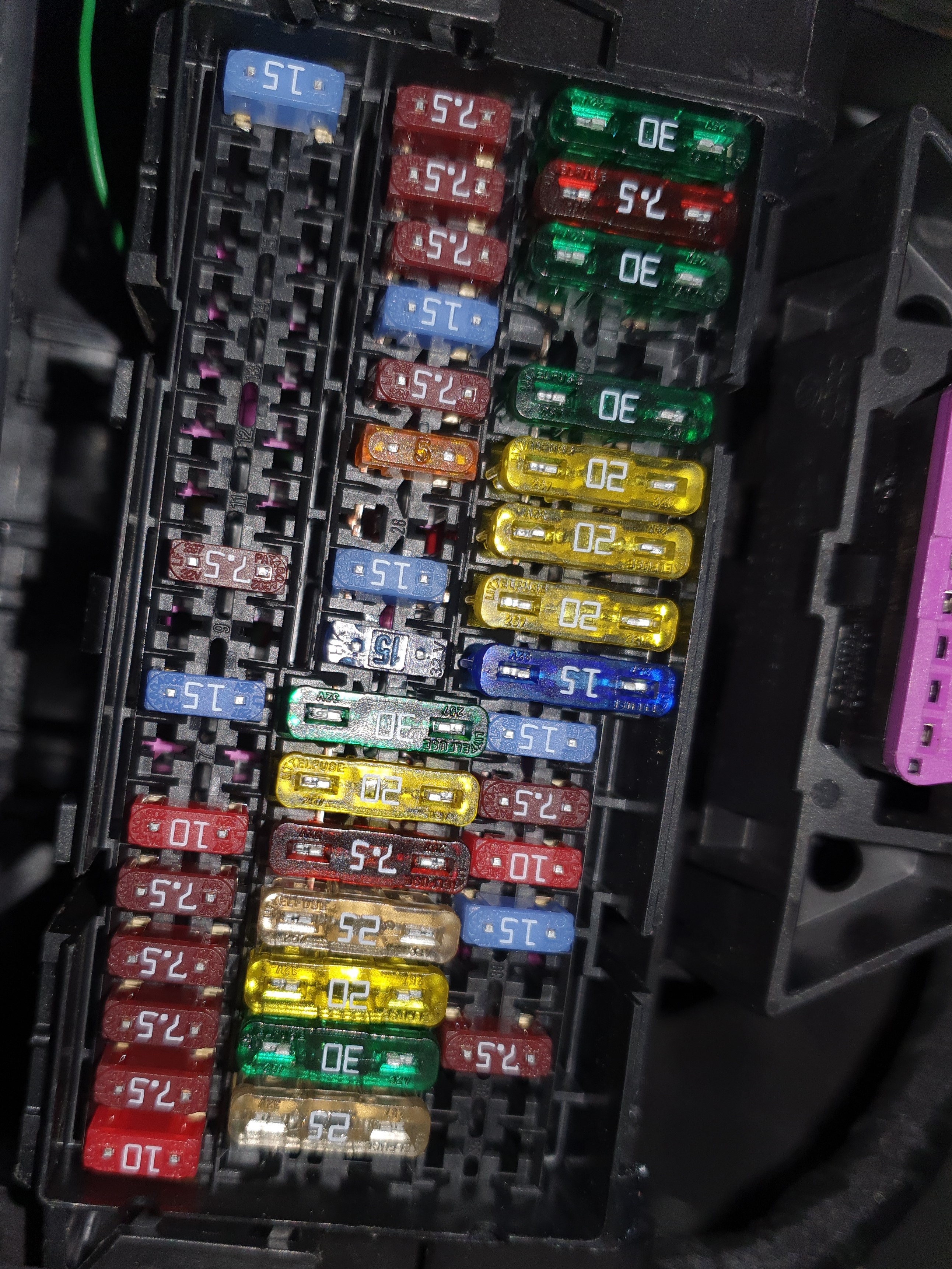

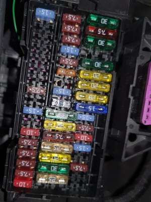

Hi. My name is Mateus, I'm from Brazil and I have a Up! TSI and I'm trying to install cruise control. As most of one knows that the Up and 6R shares many of components, I bought the ccs wiring for polo on aliexpress and I have installed in the car, but before I change the Long coding on BCM and ECU appears these errors. I'm using the pin 45 on ECU. The switch ON/CANCEL/OFF doesn't send or receive signal according to VCDS but RESET and SET buttons are working appearing actived when I press them. Someone can help me?

I've used this diagram to install the CCS with diferences at terminal fuse, that was inserted on a terminal that was ready to use but without any fuse so, I put the pin and a 5A fuse on terminal 28 or 29, I don't remember well, and the pin on ECU before what you told me to do. I removed de locking mechanism before to insert the pin and put back and checked if it was locked. Before to install the wiring, I have tested the continuity and it was working. This is more difficult that I was thinking.

If you want, take a clear photo of your fuse box and show it here.

I don't know how I can take this information about the signal. You can teach me how to do that using a multimeter?
That was the best photo that I could take at the moment, but if you another one, I can try to take at the day with more space
Posts: 8837
Your fusebox image edited with the crap from Windows 10 tools. :lol:
Two wires reach this fuse SC5, one is black (INPUT - SC5B -) and the other is black-gray (OUTPUT - SC5A -) and you must connect the CCS power wire to the output wire (SC5A).
A or B should be engraved on the plastic on the back of the fuse box.
This fuse is dedicated to powering the reverse light switch (for future reference).
I think it is a good place to connect the CCS power, the other first four fuses are occupied by various important devices or connectors.

ciclo wrote: Sat Mar 28, 2020 6:01 am Your fusebox image edited with the crap from Windows 10 tools. :lol:
Bad news. I put the cable in the output wire and... nothing has been changed. The values still the same and the main switch continue to not response as in the vídeo. A man that was helping me with this told me that I need to take a license to active the function via ODIS and another man told me that my software version won't be able to activate the function and because of this I will need to copy the software from a Up! that have cruise control enable from the factory to use the file to change my ecu. I'm sad about it, but I think that I will buy this universal cruise control https://loja.onmotus.com.br/produtos/throttle-up-vw-up/
Do you think what they told me may be correct? Thanks to all the help anyway.
