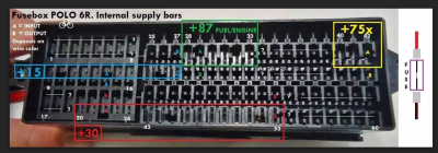

Re: Polo 6R 09 1.4 85KM
It's really easy, you just have to wire your current slip ring correctly. (G85 --> 6R0 959 564)
They are 5 wires:
+15, +30, Ground, CAN H, CAN L.
Use the following images as reference (from other user - govindsharma - read here pg 2 & 3 ):
T41 ---> 6,5,4,3,2
CAN lines (powertrain ---> in your case, for example ---> OLD/ORIGINAL IC CAN lines)
In this way the BCM will know the steering wheel angle to automatically activate the SCLs on each side (once the BCM has been coded for SCLs).
Note:
-It is likely that with your VCDS cable Address 04 is not visible in your future autoscans, however Address 04 must be activated in the Gateway installation list.
T41 ---> 6,5,4,3,2
but I don't know which fuse to connect to t41 / 6
