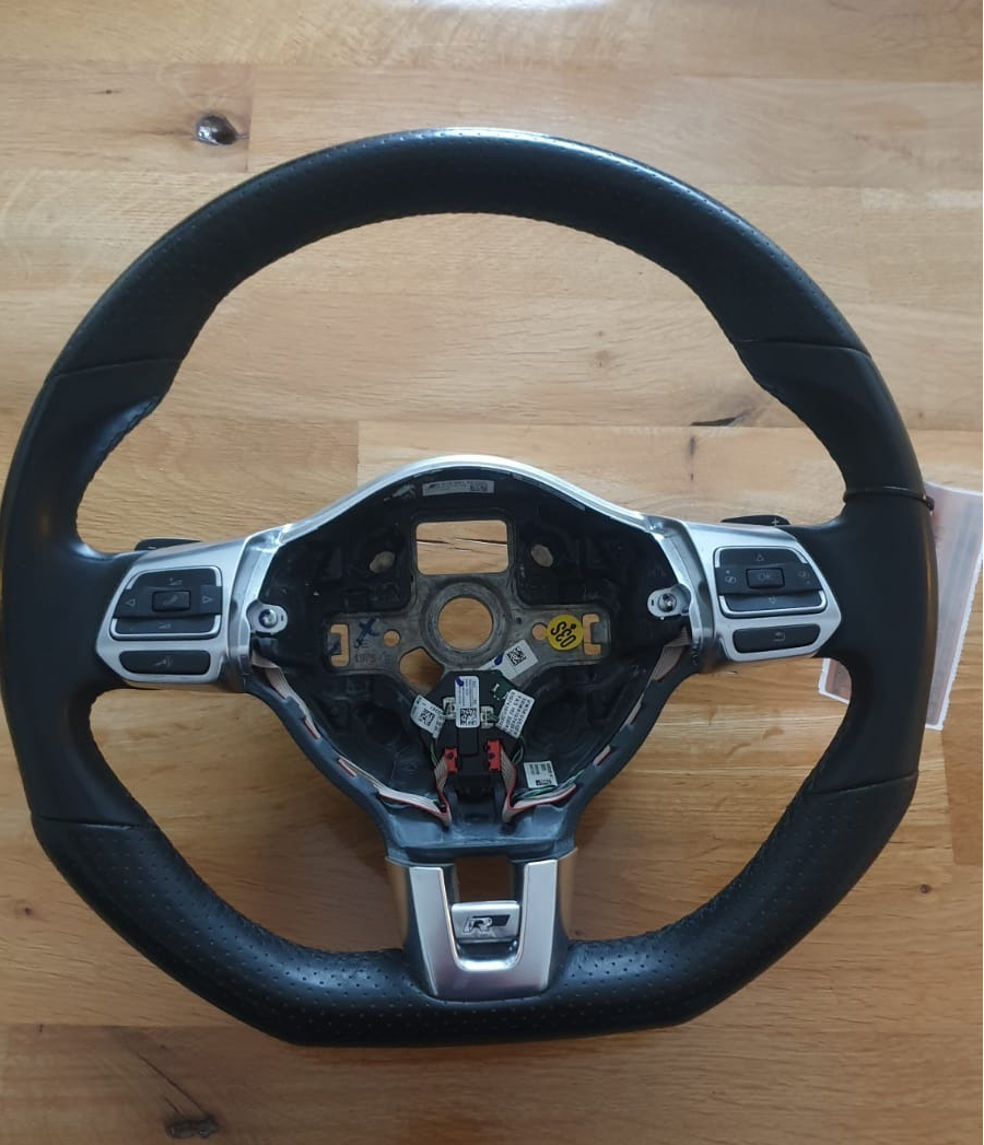

Goodday everyone,
I would like to change my steering wheel to one with steering wheel controls and paddles.
Now I have one in view of a Golf 6 GTI.
However, I am not sure if it will work without upgrading the BCM.
I know I have to put the 2 wires to make the buttons work
And I have some more questions.
When I have built in the steering wheel.
what do I have to do to get the paddles working?
Can someone tell me if the Polo 6r airbag fits in a Golf 6 gti steering wheel?
I would like to hear from you :)
My polo is a 6r 1.2TSI DSG from 2010

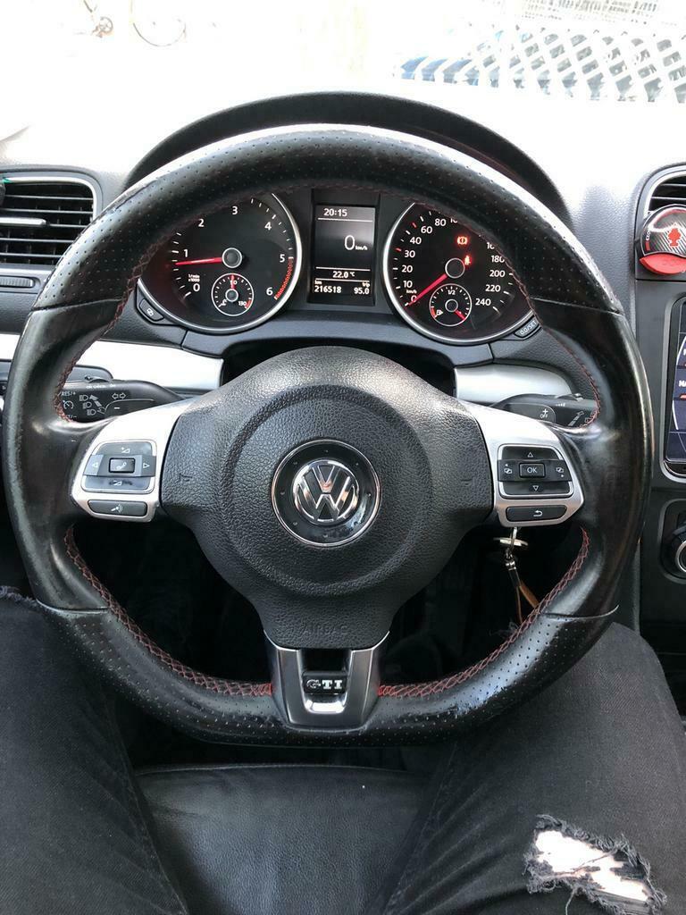

I also added 2 photos. 1 from my steering wheel and one from the seller
Golf 6 GTI
Golf 6 GTI
Polo 6r
Polo 6r

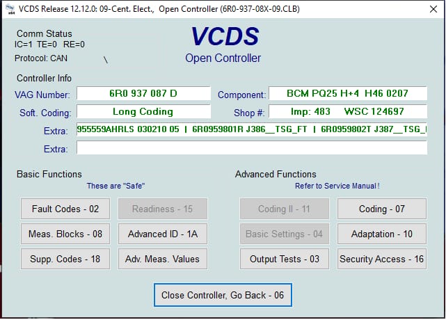

iichel wrote: Fri Apr 24, 2020 8:35 pm Well if you can tell us what bcm you have, that would be helpful
Do you prefer an actual picture of it.
Of is an screenshot of VCDS enough?
But it the first thing im going to do after work xD
Posts: 6687
Re: MFSW steer swap
Vcds autoscan is goed
cypress
Posts: 14
Joined: Thu Apr 23, 2020 7:01 am
Drives: polo 6r 1.2tsi DSG
Location: netherlands
Re: MFSW steer swap
Post by cypress »
iichel wrote: Sat Apr 25, 2020 7:17 am Vcds autoscan is goed
BCM polo 6r 1.2tsi 2010
Here by an picture of the BCM :)
I hope its enough/usefull :)
Just in case
Vag number: 6R0 937 087 D
Component: BCM PQ25 H+4 H46 0207
Edit,
If i use the"long coding helper" im able to enable MFSW.
I dont know if the right one for an Golf 6 GTI steering wheel :P
Posts: 6687
Re: MFSW steer swap
It's all the same, Polo 6R wheel, Golf 6 wheel. Doesn't really matter, it should work. And get yourself a recent VCDS please, 12.12 is 8 years old.

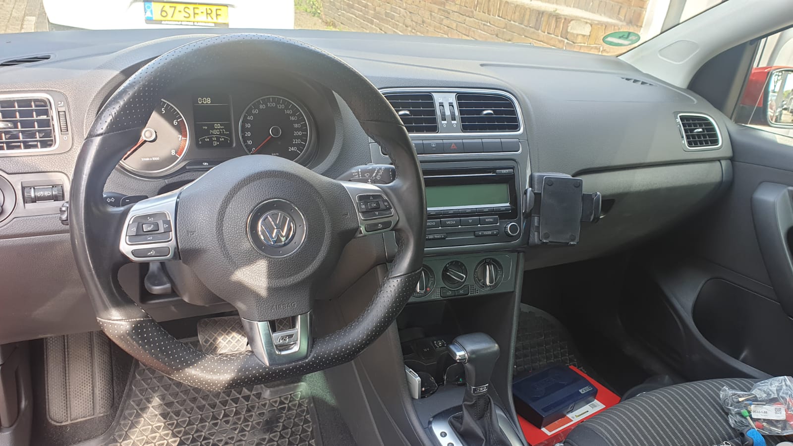

It took a while, but the steering wheel is in it! and works perfectly!
Super thanks !
Now the next project is a rear view camera in the VW emblem.
I had already made a post on facebook, and I was nicely helped there. but it got quite difficult and I couldn't get it anymore because of it.
I feel like that person doesn't like me anymore. :O
Posts: 6687
Re: MFSW steer swap
Good job, looks nice :)
