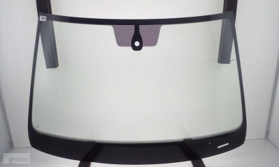

Hi, thank you Fernando for the instructions, I will try to do it and show the result :D :D I don't have automatic lights yet, because I don't have a twilight sensor yet :P
Which windshield is the right one for the sensor?
Thanks you iichell,ciclo :D
Re: Polo 6R 09 1.4 85KM
If you want a heated windshield, there is also an option.... ;-)
You can take either of those for your Polo 6R.
Top one: 1K0 rain sensor, 1K0 auto dimming mirror
Bottom one: 5K7 rail sensor, 3G0 auto dimming mirror, 7E0 HBA mirror (only with automatic lights, 7E0 BCM and wiring)

ciclo wrote: Sun Dec 13, 2020 4:24 am Nice improvements, ... although the windshield and RLS are still missing. 😊
Hello :) Coming soon RLS :) Does the 6C polo windshield fit the 6R 6C0845011NVB ?
I already have :)
5k7 955 559 B
3G0 857 511 E
Posts: 9037
Thank you for your quick comment (December - April) ... 🤣 (just kidding)
Yes, the 6C windshield is compatible with the 6R frame.
