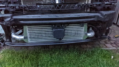

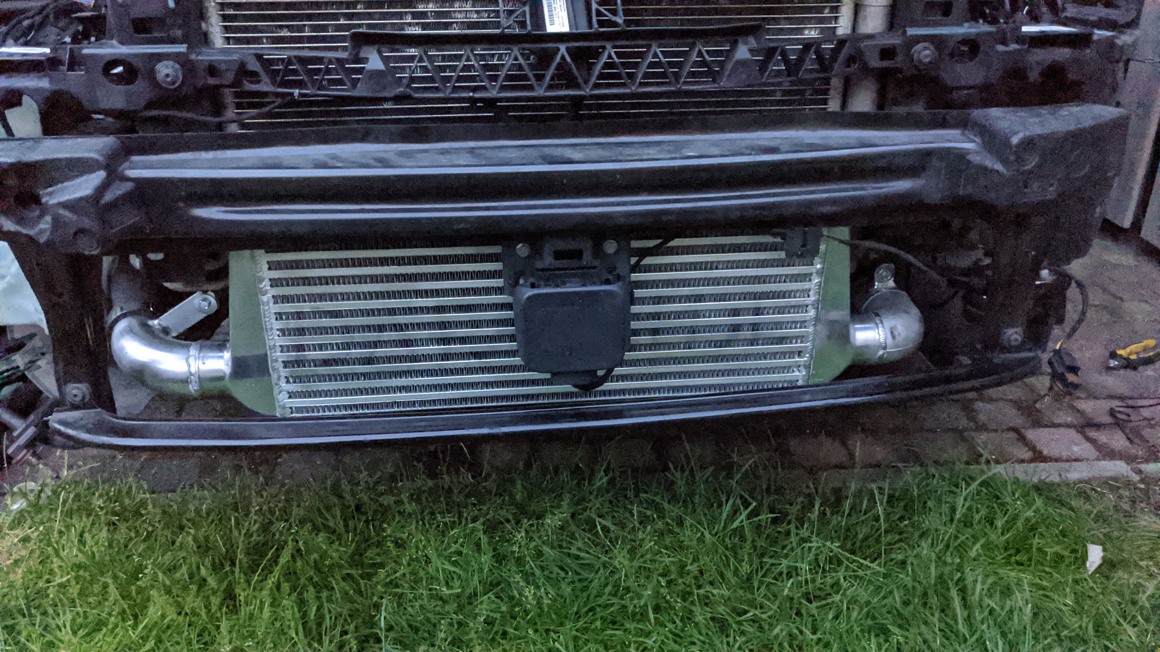

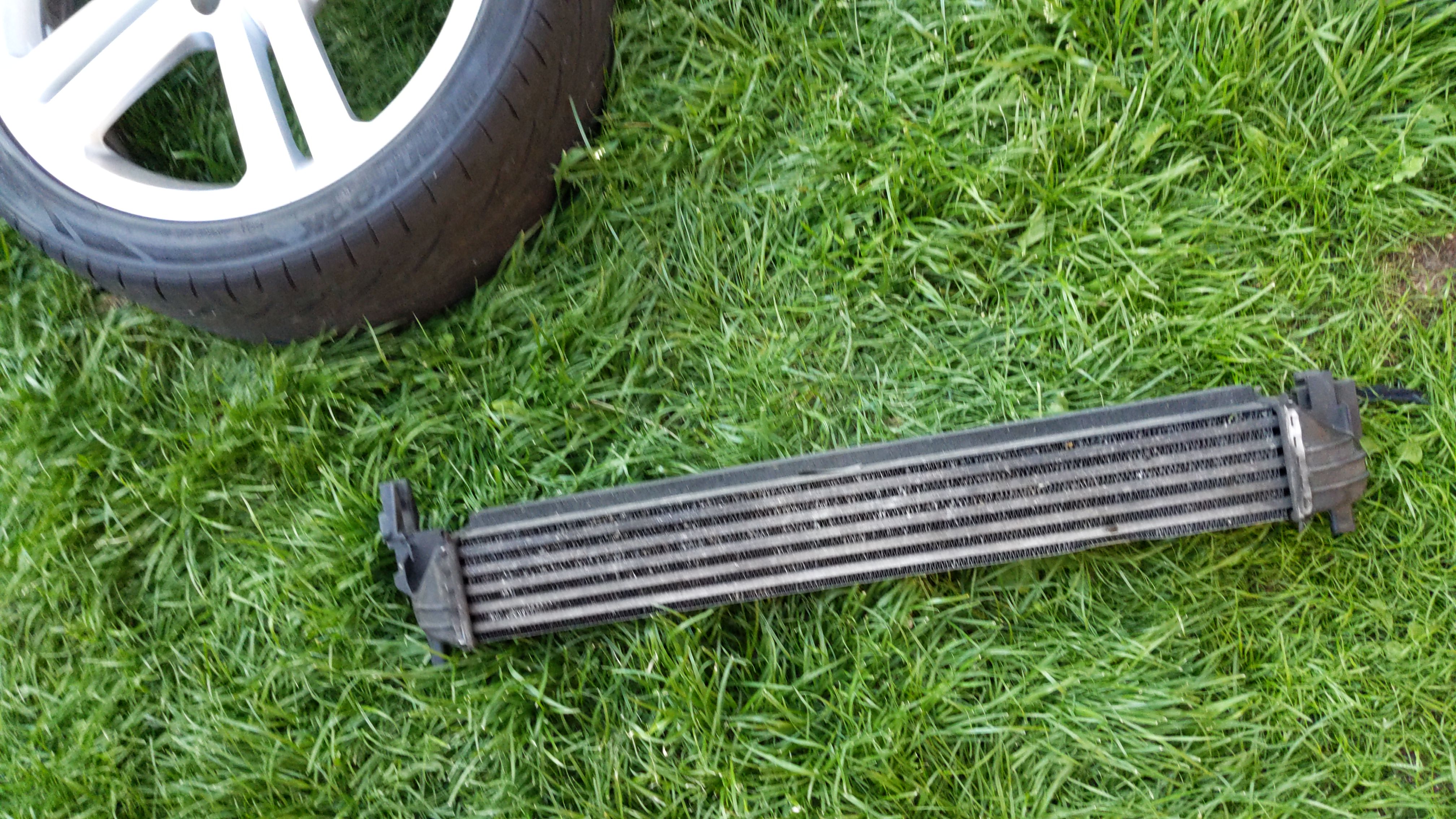

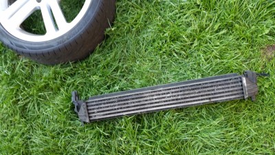

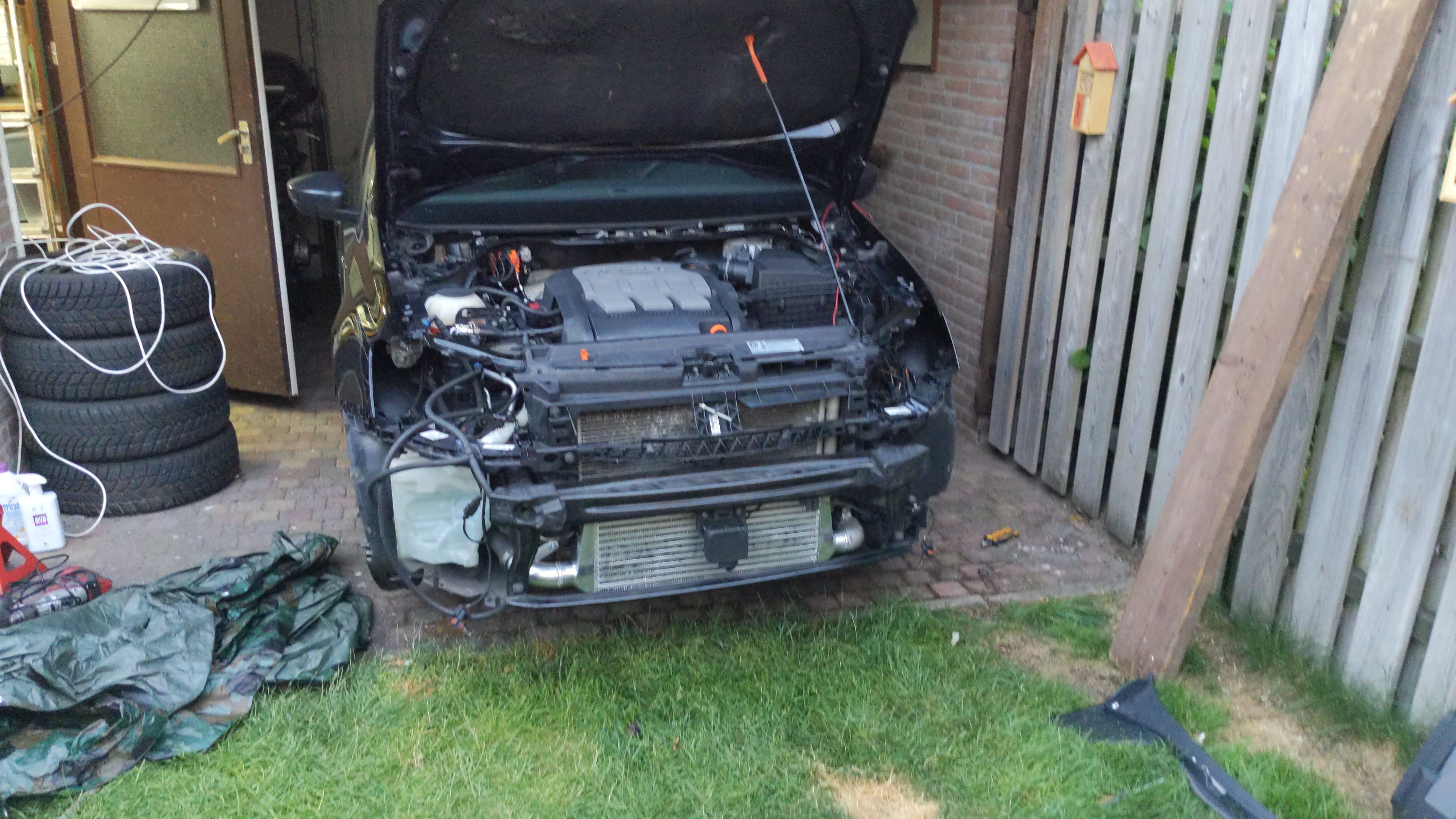

Factory intercooler
Of course you don't want to be seen with this...
Darkside intercooler :-)

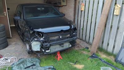

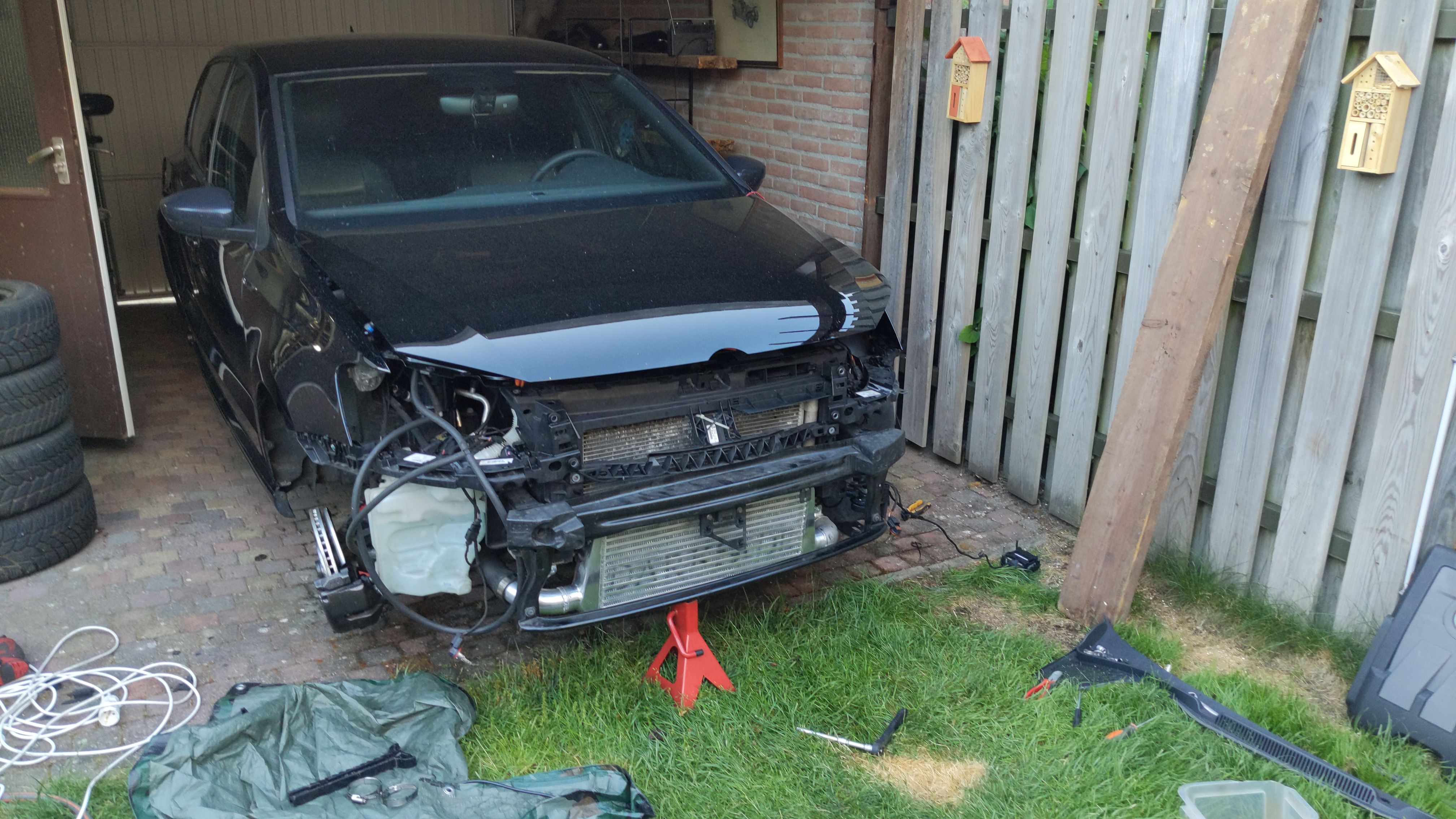

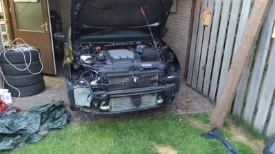

ciclo wrote: Wed Jun 03, 2020 4:16 am Ok, without right headlight. ...or do you mean something else?
Yes haha. I removed the entire front of the car, including supporting frames. It was needed to place back the headlight for alignment of the bumper and headlights.
Afterwards I remove the left headlight (right on the picture) to continue work on the DSG wiring (DSG connector and starter inhibitor relay).
