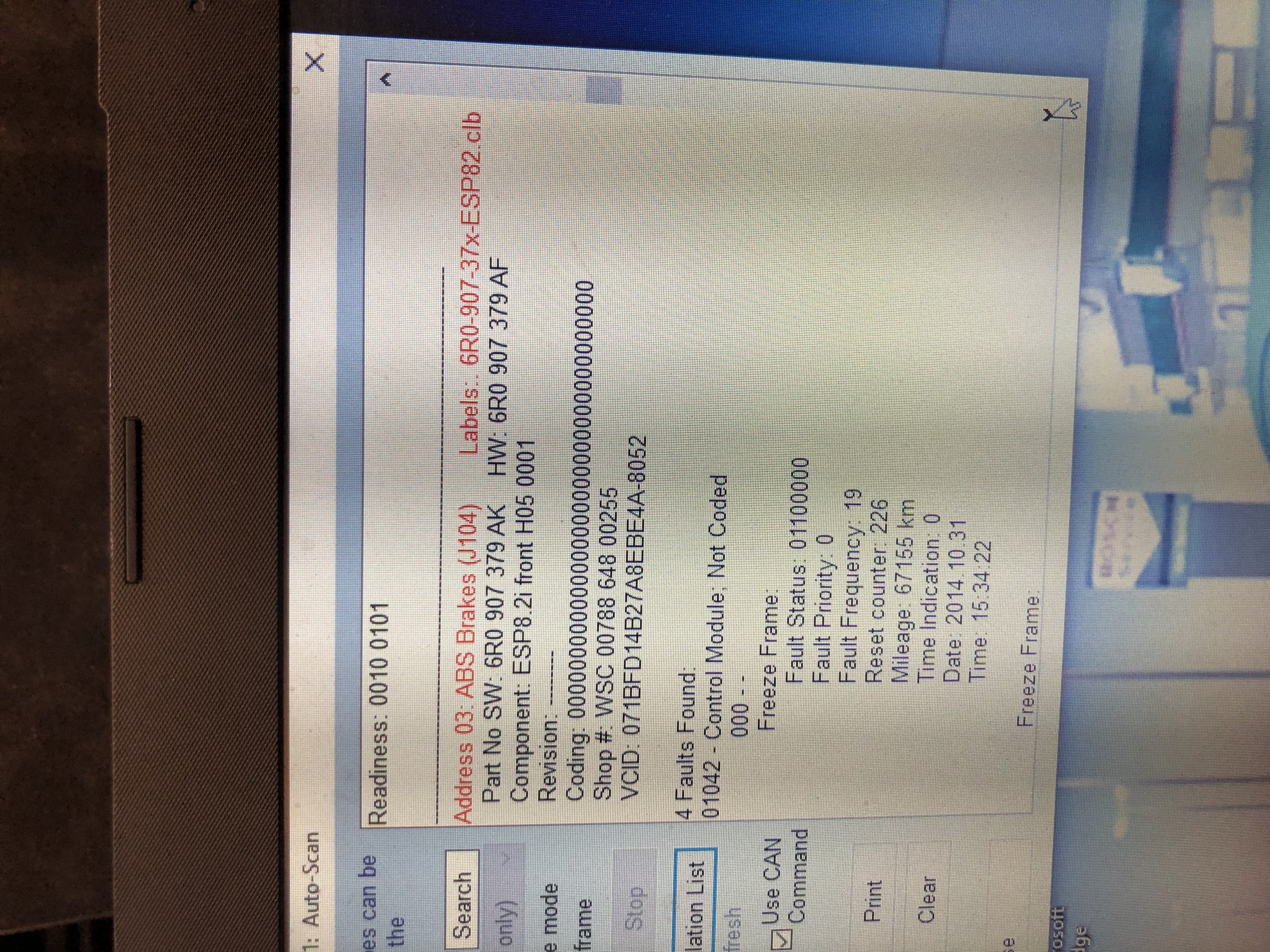

Re: Restoring lost abs long code with new vcds hex v2 pro
Hi, I was wondering if you could try and find my code for me.iichel wrote: Mon Jul 15, 2019 8:42 am Any chance you could post an autoscan with the current configuration?
VIN: WVWZZZ6RZBY202858
ESP 8.2i Front H05 0001
6R0 907 379 AK
- Posts: 6685
I'm going to need a full autoscan please

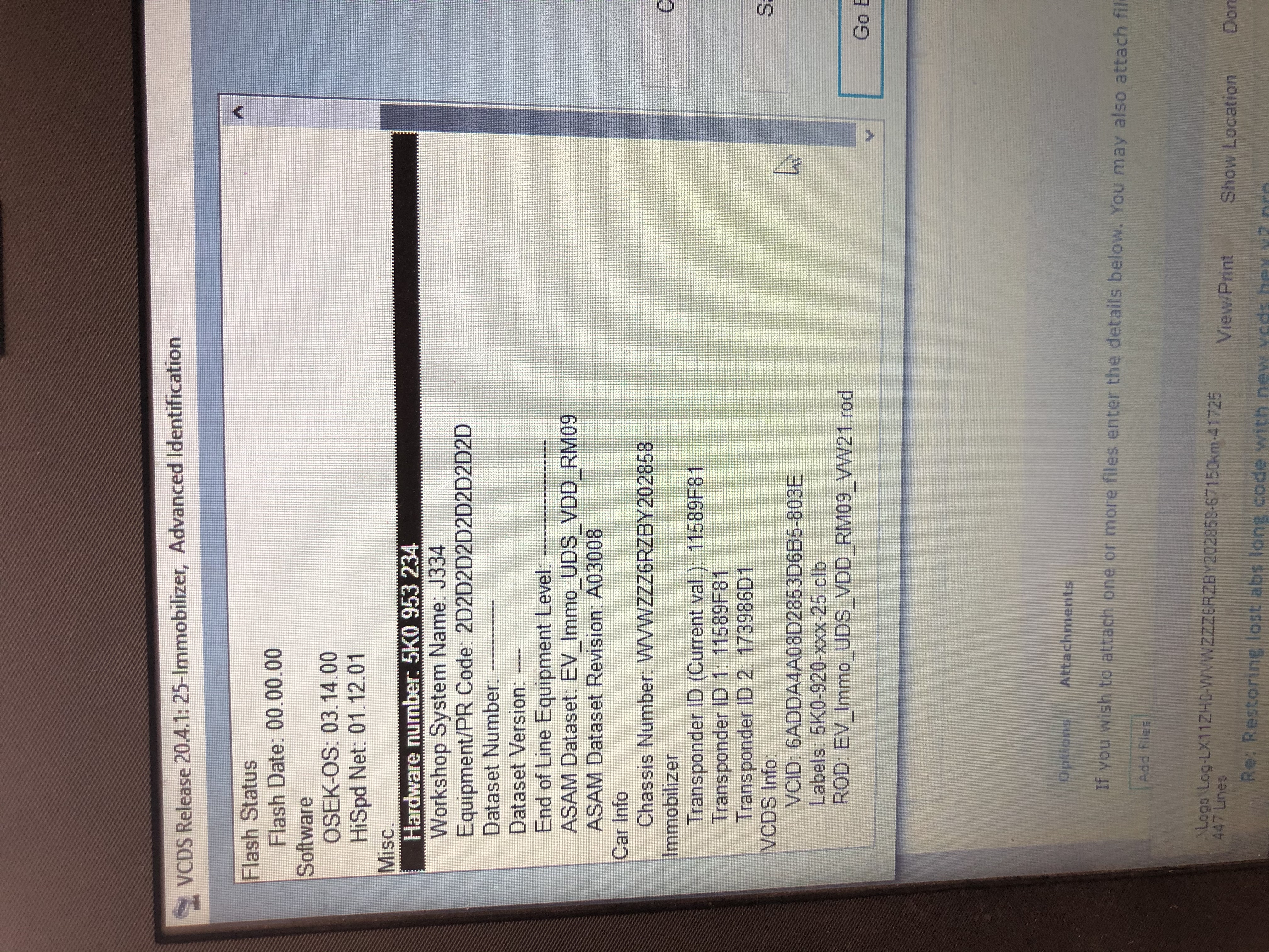

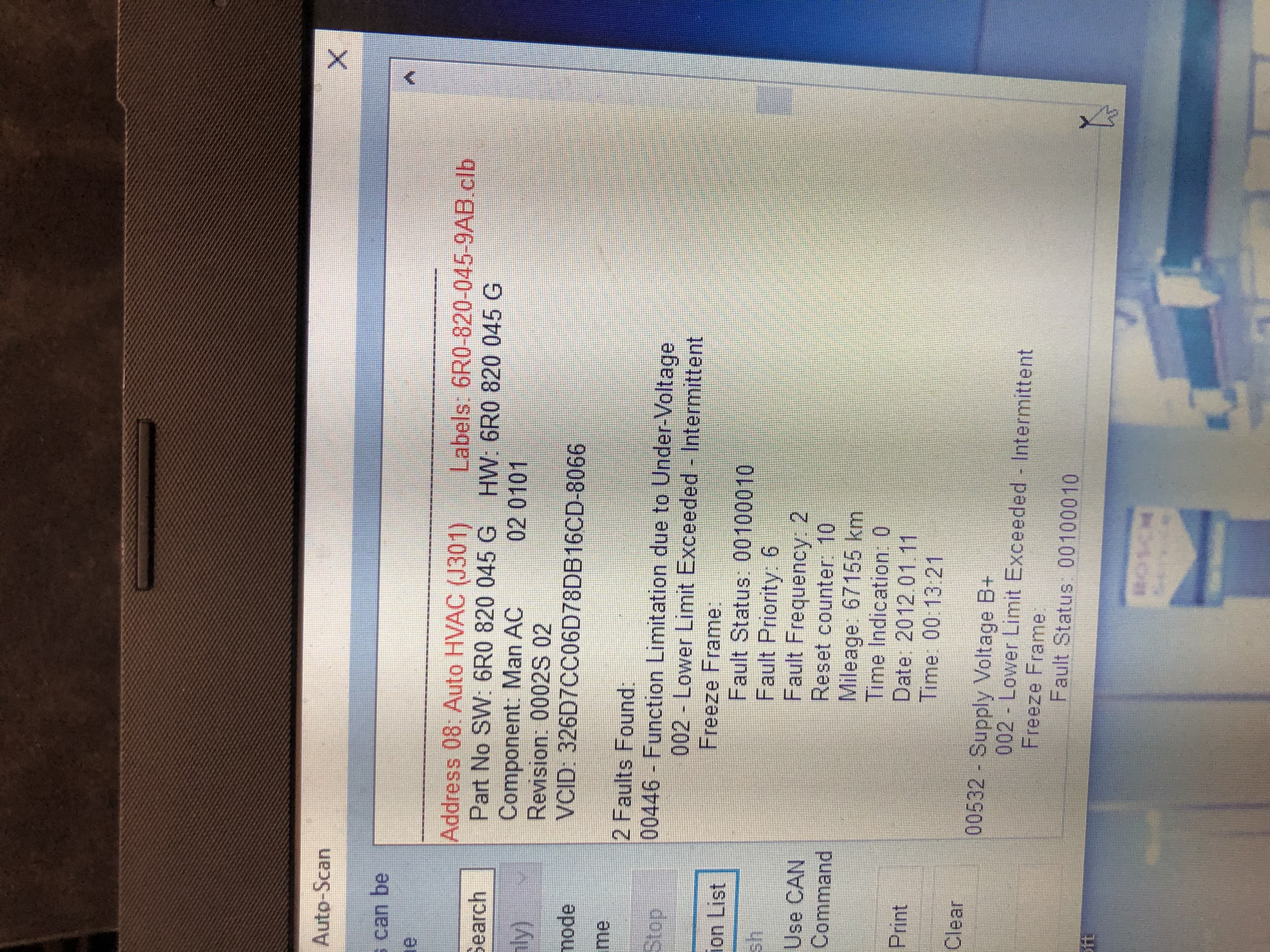

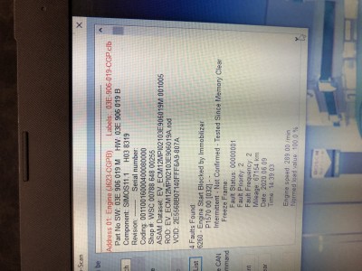

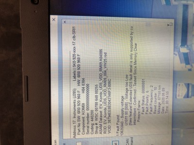

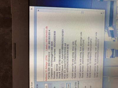

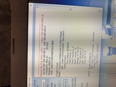

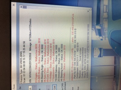

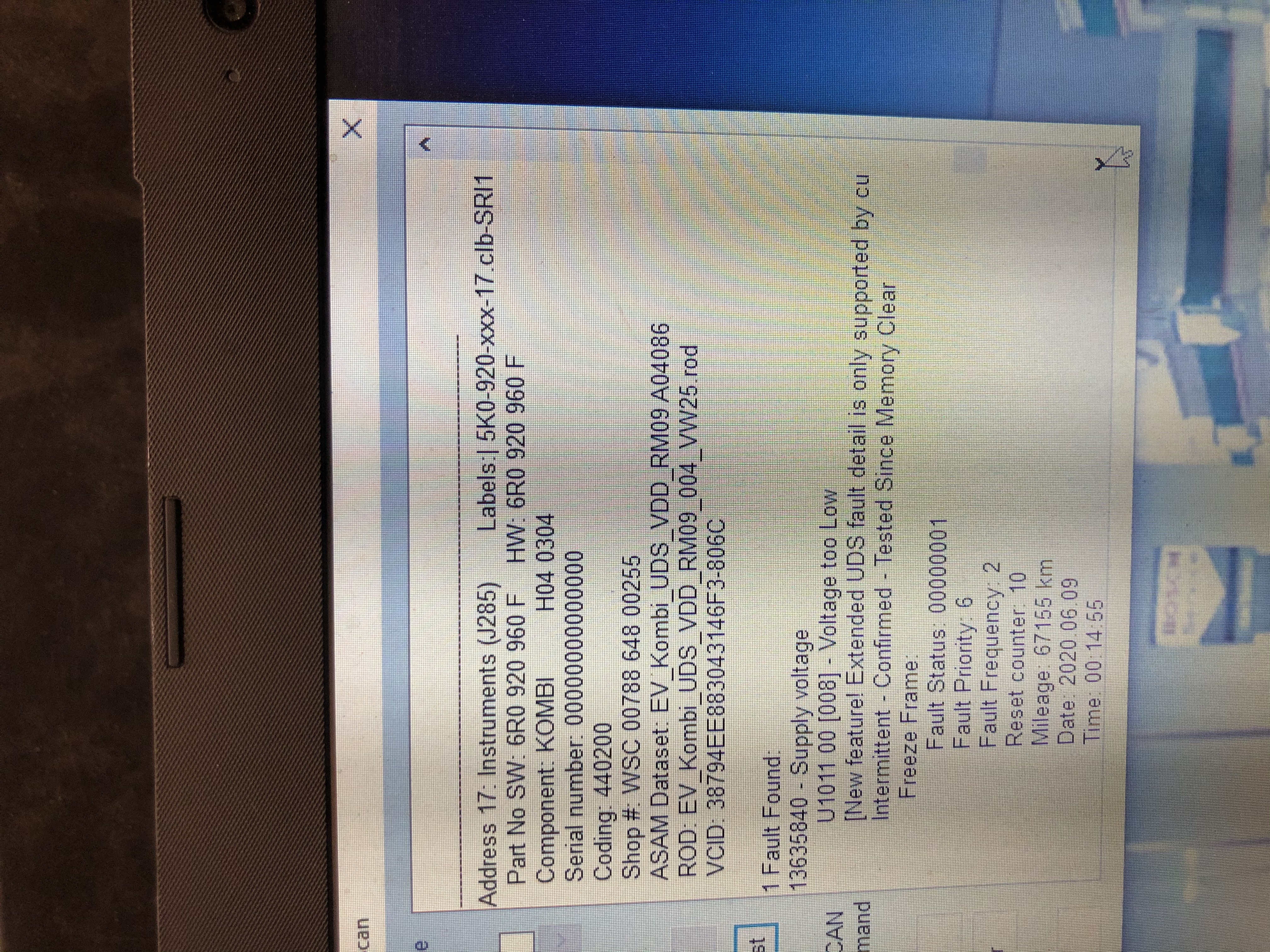

Not really too sure how to do it how others were doing it and I’m on this site on my phone, hope these pictures give you what you need. Thank you in advance
- Posts: 6685
Press save on the window you're seeing.

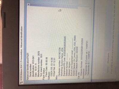

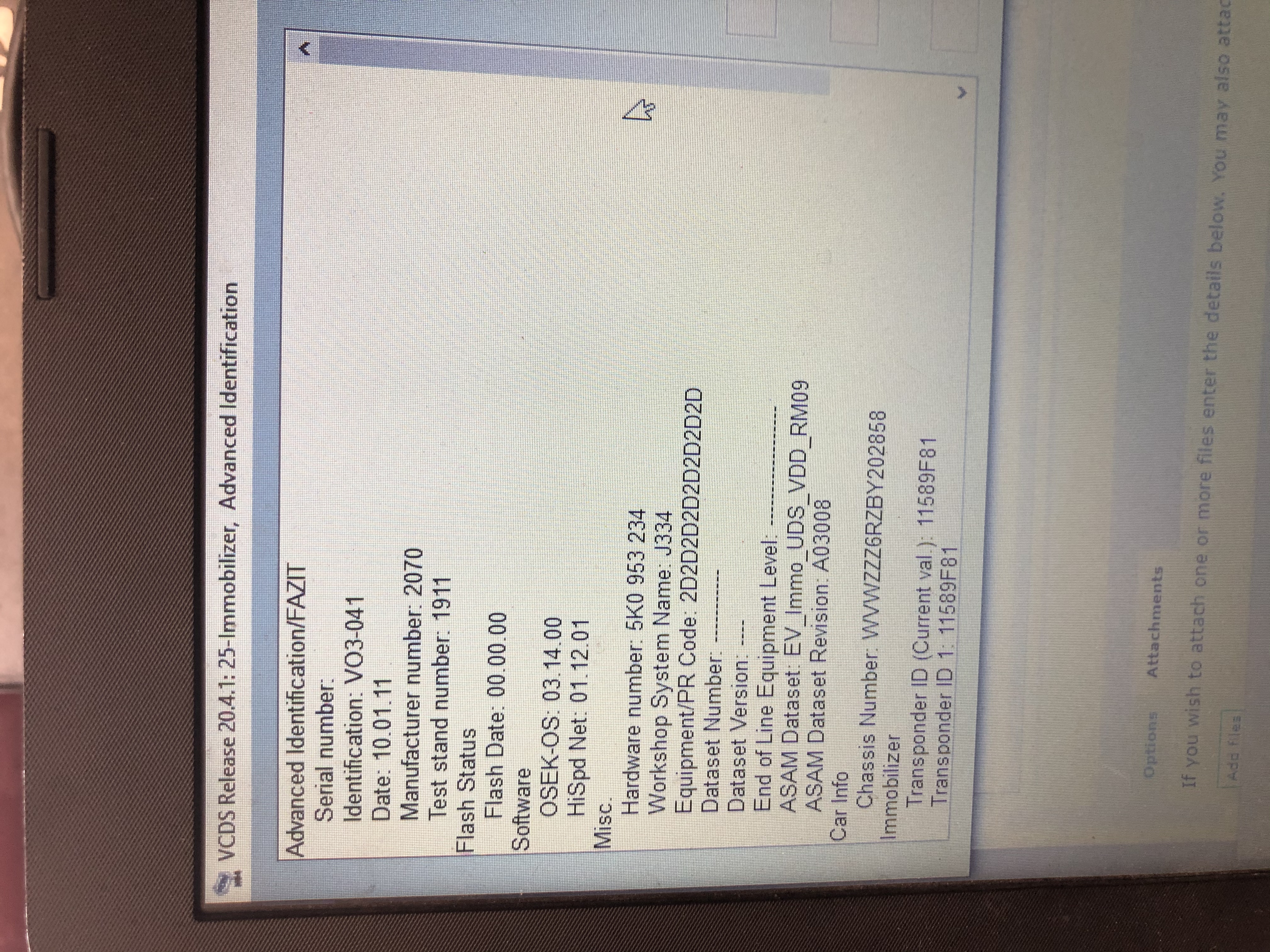

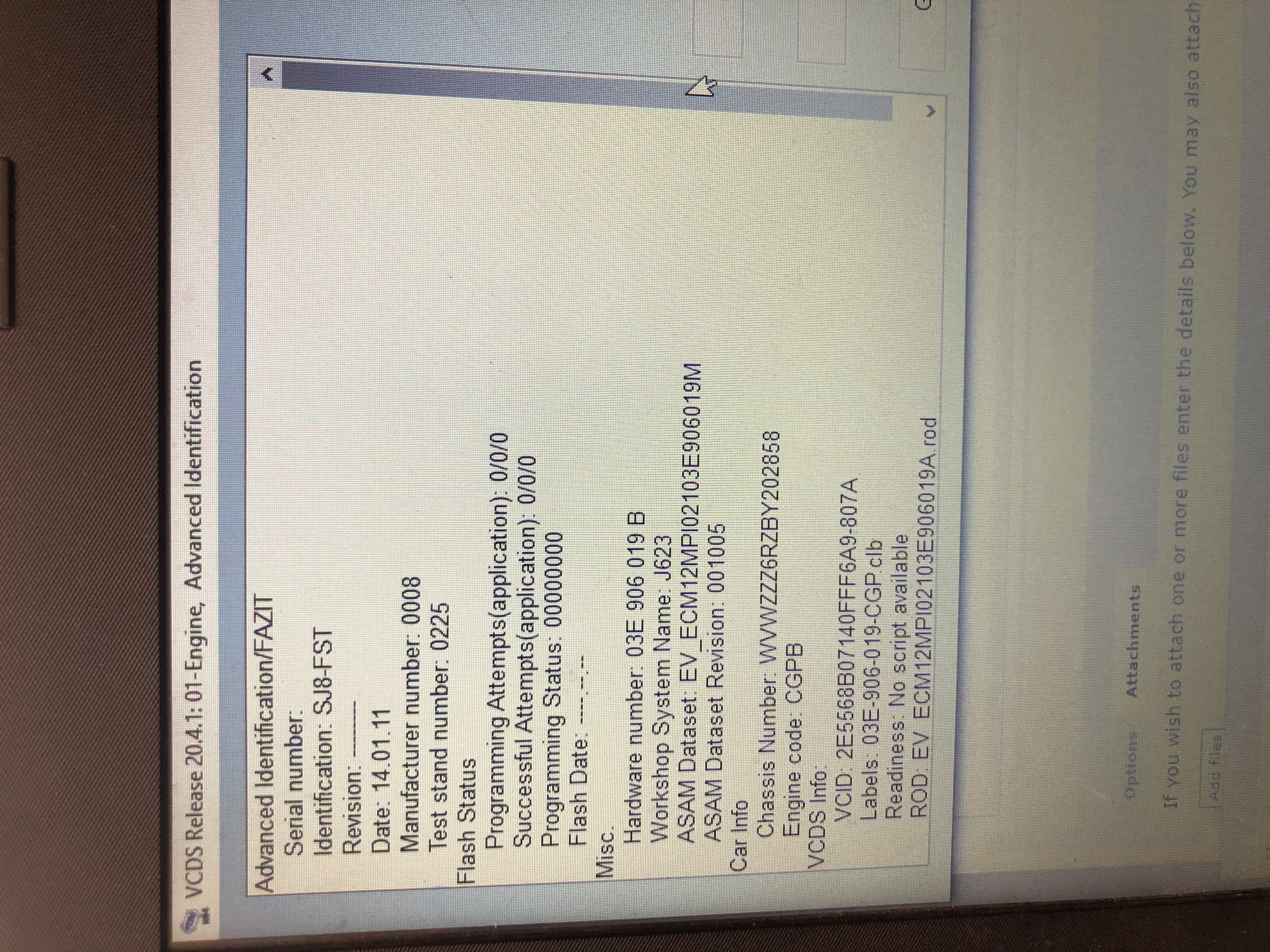

Also please show me the advanced of the immobiliser and the engine please.

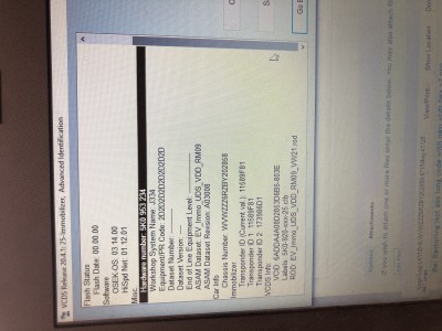

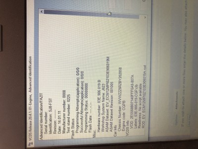

It came up with an error every time I tried to send the saved log, on this website when attaching it. So I’ve taken a picture of the advanced ID’s you needed and enclosed the pictures in this messageiichel wrote: Wed Jun 10, 2020 1:58 pm Press save on the window you're seeing.
