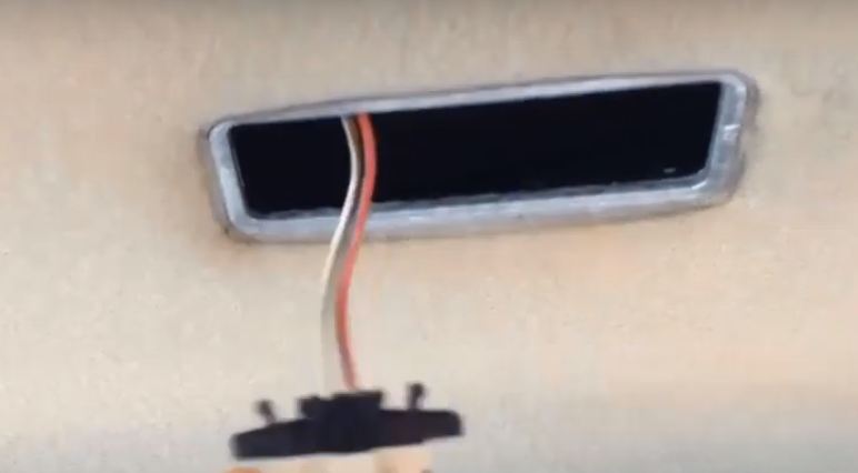

Hello rdasadia!... this is patil
I have a suggestion for installing GPS antenna for your MIB2 in your 6R.
You can buy a OEM sharkfin antenna with rod(part number in picture), which houses GPS module, FM and GSM. It fits perfectly in our 6R and work perfectly.
You need to buy GPS extension cable 5M to connect to your MIB2. Link here:https://www.aliexpress.com/item/3288284 ... 4c4dLv6rI6
GPS module catches satellites instantly and FM reception also improves significantly over stock rod. You can leave GSM connector unused.
Here pictures of my installation:
