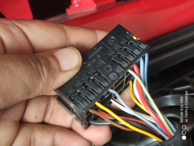

Here's the VCDS Scan of my car.

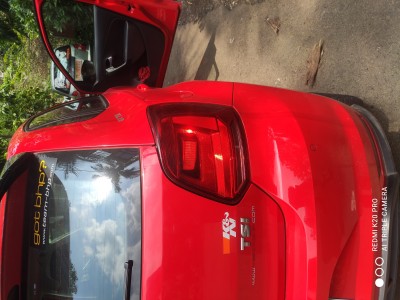

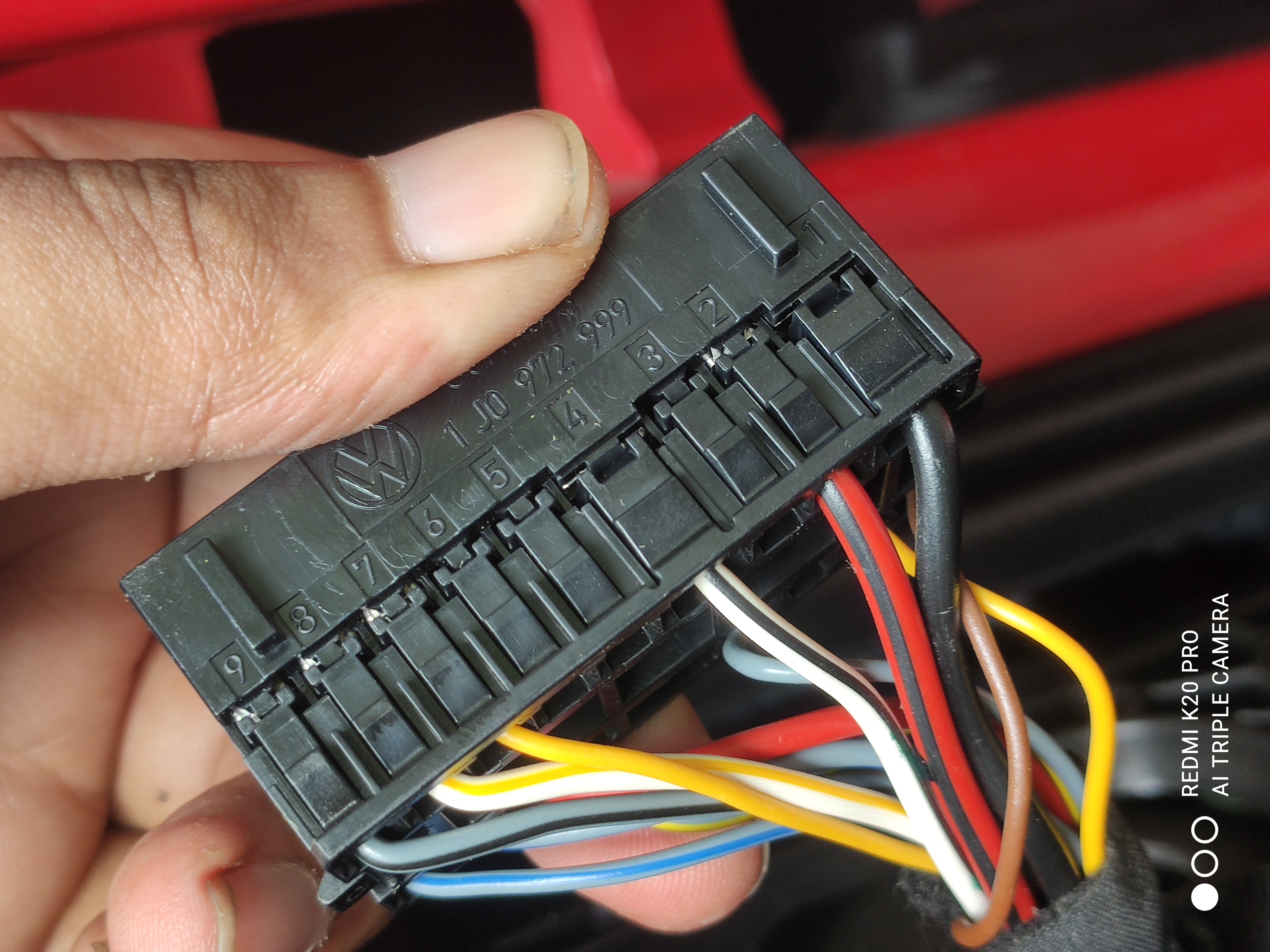

6C Led tail Lights Oem Equipment provided by the company Relay (Hope this pic is clear enough) I have aftermarket Headlights which I would like to keep(Plug and Play Unit), Led H7 Bulbs for High and Low. High and low are different projectors. DRL which also function as Turn Indicators. Would like to keep the Fog lamps as cornering lights as my headlight unit does not have the cornering lamps as in the case of BiXenons.
Aftermarket Headlights current use the stock T10 Connector. Also would like to install the dimmer + headlight level switch (only if i can source the parts and its possible with this mod)
I have one doubt, the wiring inside the headlights seems to be customized as the DRLs seem to work even without turning on the Light Switch(Atleast a Part of it), if i set light switch to parking DRLs seem to light all the way. Rest function are the way they were with H7 Stock Halogens.
Ciclo, I understand and i am well aware that you have stopped making the wiring for such mod. But it would be great help if you can help me with making my own wiring as i am newbie here. (Have some experience in making wiring loom for my another car) As I am not aware of the wiring schematics for Polo.
If any one else can help or make the wiring for me, it would really be great. Guys would need help in sourcing Parts like BCM Max, Pins, Connector, etc.
Would like to do HBA Also if its not hard and specially if its cost effective.
Thanks Guys.

How to remove pins from the headlight switch?
Re: Polo 6R GT TSI 1.2 BCM Max + Auto Headlight + HBA
I'm using these tools for pins:
- Laser 3932
Terminal Tool, Internal diameter 2.8mm, external diameter 4mm (LAS3932) - Cable Connector Loosening Tool CE91 B.60100/CE91 BGS Technic
replacement for Release tool VAS 1978/7A for flat contacts with two locking tabs, contact width 1.5mm (ASE 401 517 02 000)
