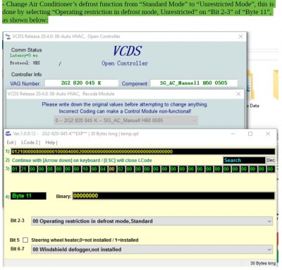

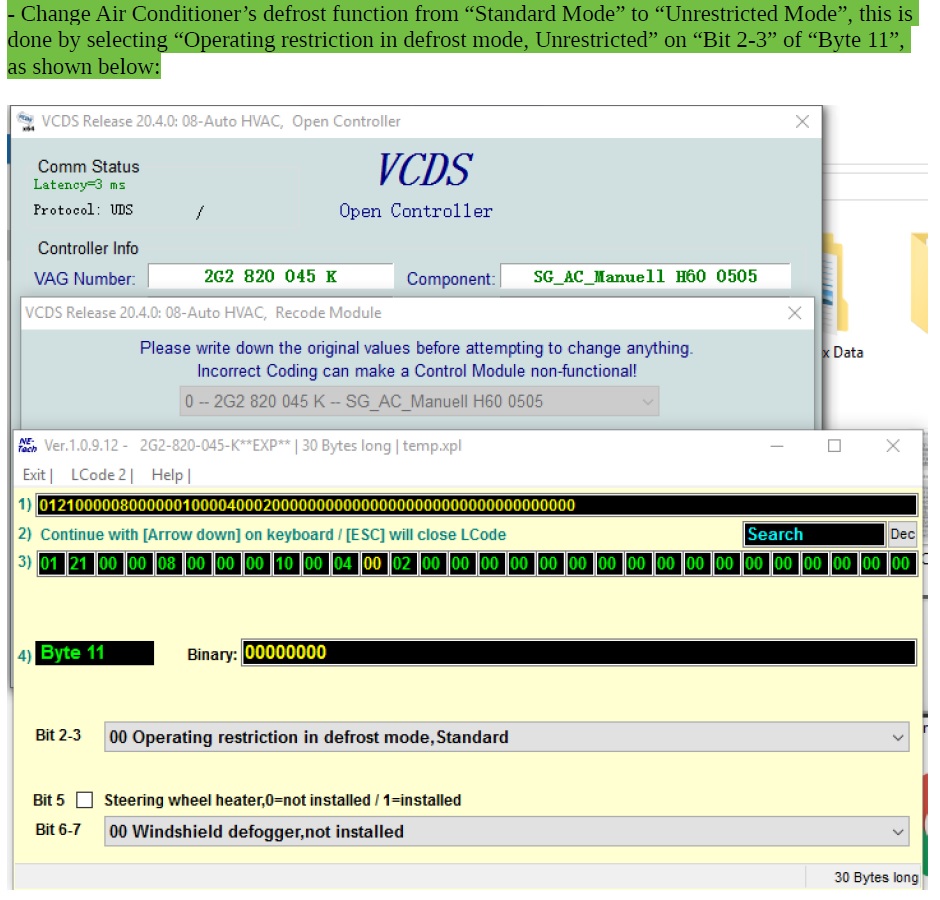

All European spec. Polo(AW) have the compressor stays on in the background when blowing at the windscreen, even the LED light on the A/C button is OFF.
Because in the 08-Auto HVAC control module, the coding is set to "Operating restriction in defrost mode, Standard".
If you use VCDS and change this coding to "Operating restriction in defrost mode, Unrestricted", you will have full manual control of the aircon.
By mean when blowing at the windscreen, when the LED light on the A/C button is OFF, the compressor is really switched off.
And the compressor is switched on, when the LED light on the A/C button is ON.
To do this, using VCDS:
- Go to Coding of 08-Auto HVAC
- Go to Byte 11
- Change bit 2-3 to "Operating restriction in defrost mode, Unrestricted"

If you change the coding of 08-Auto HVAC to "Operating restriction in defrost mode, Unrestricted", it doesn't mean your compressor is permanently OFF forever.monkeyhanger wrote: Mon Sep 14, 2020 8:34 pm Best to leave the aircon as is. If you have it off completely for long periods then the seals keeping the refrigerant gas in place will dry out and leak it all out. You'll need a regas every 2 years. What it's using is a tiny amount unless you are perpetually in gridlock. Plenty of people throw pounds away chasing pennies.
By changing the coding, it give the user the freedom to choose switching ON/OFF the compressor in any mode of air blowing.
So, nothing is stopping the user switching ON the compressor from time to time, in order to lubricate the seals / the compressor.
