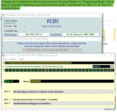

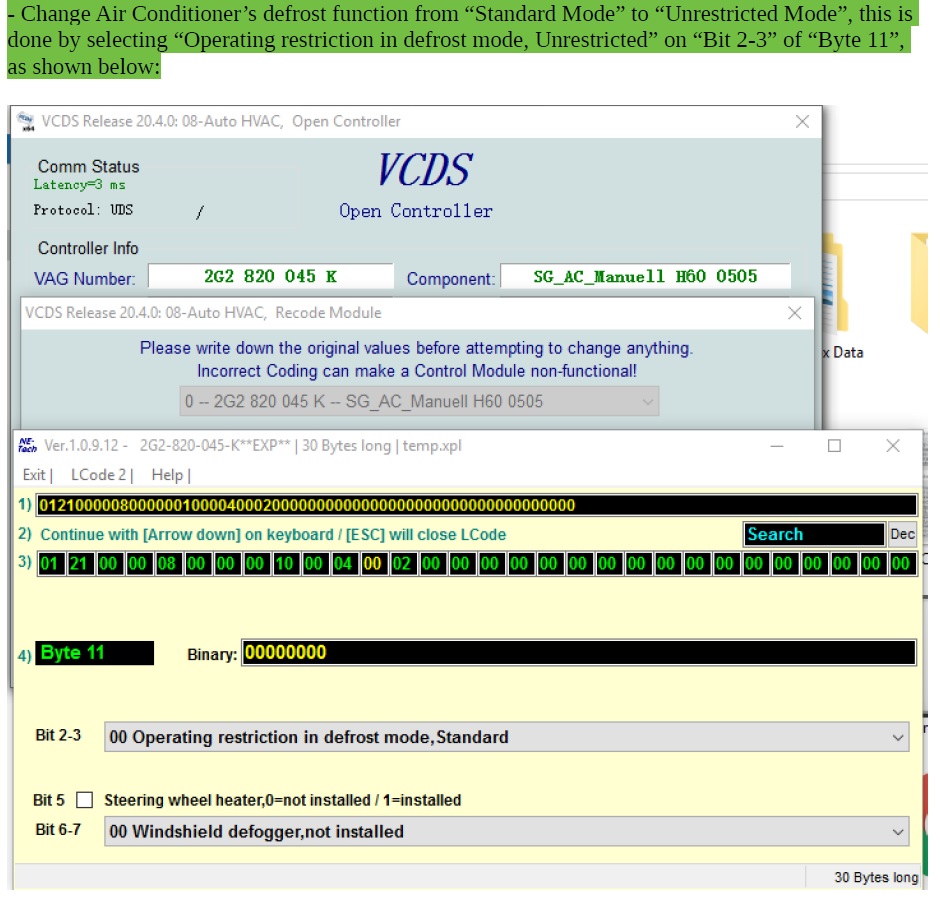

All European spec. Polo(AW) have the compressor stays on in the background when blowing at the windscreen, even the LED light on the A/C button is OFF.
Because in the 08-Auto HVAC control module, the coding is set to "Operating restriction in defrost mode, Standard".
If you use VCDS and change this coding to "Operating restriction in defrost mode, Unrestricted", you will have full manual control of the aircon.
By mean when blowing at the windscreen, when the LED light on the A/C button is OFF, the compressor is really switched off.
And the compressor is switched on, when the LED light on the A/C button is ON.
To do this, using VCDS:
- Go to Coding of 08-Auto HVAC
- Go to Byte 11
- Change bit 2-3 to "Operating restriction in defrost mode, Unrestricted"
