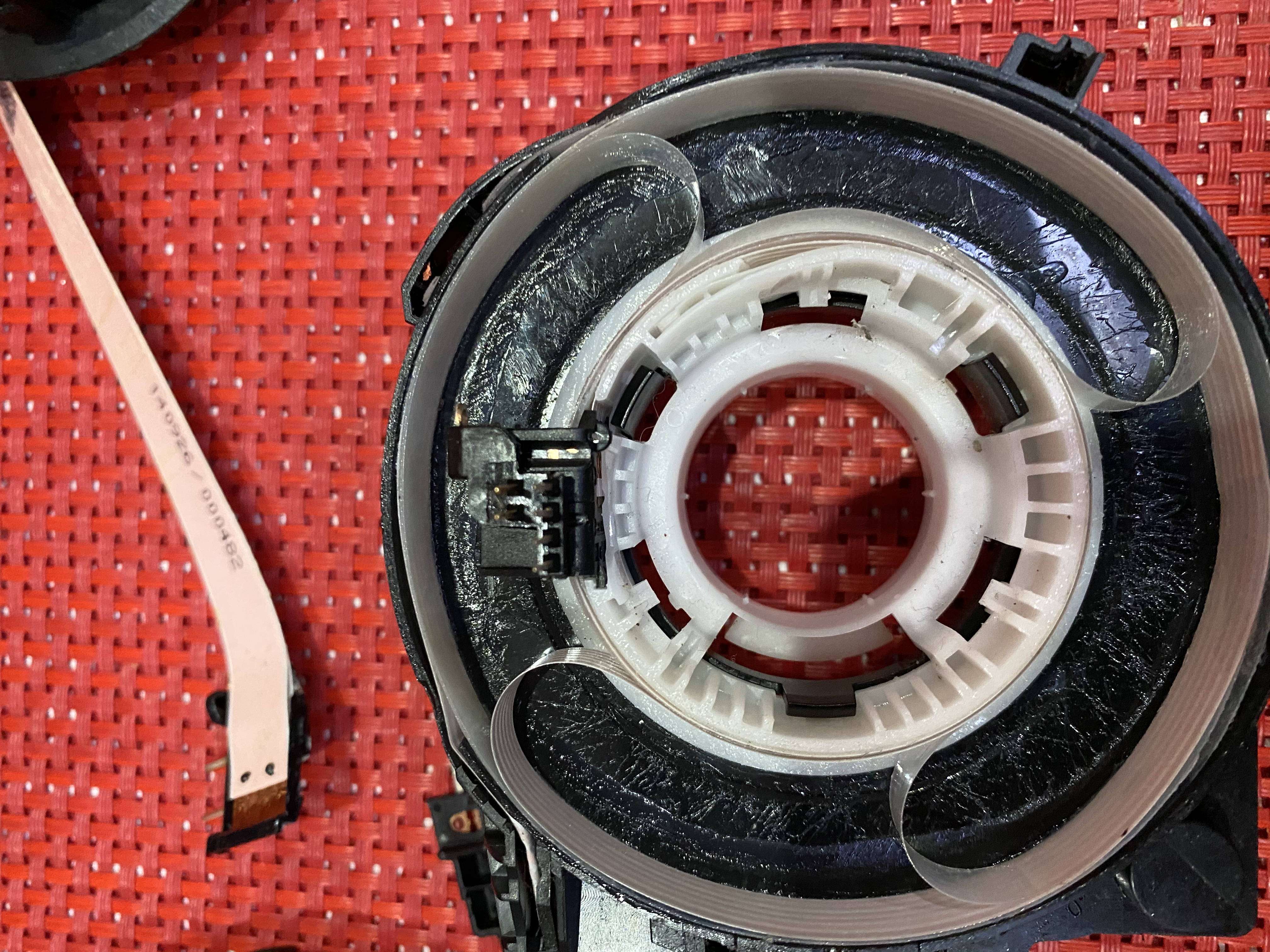

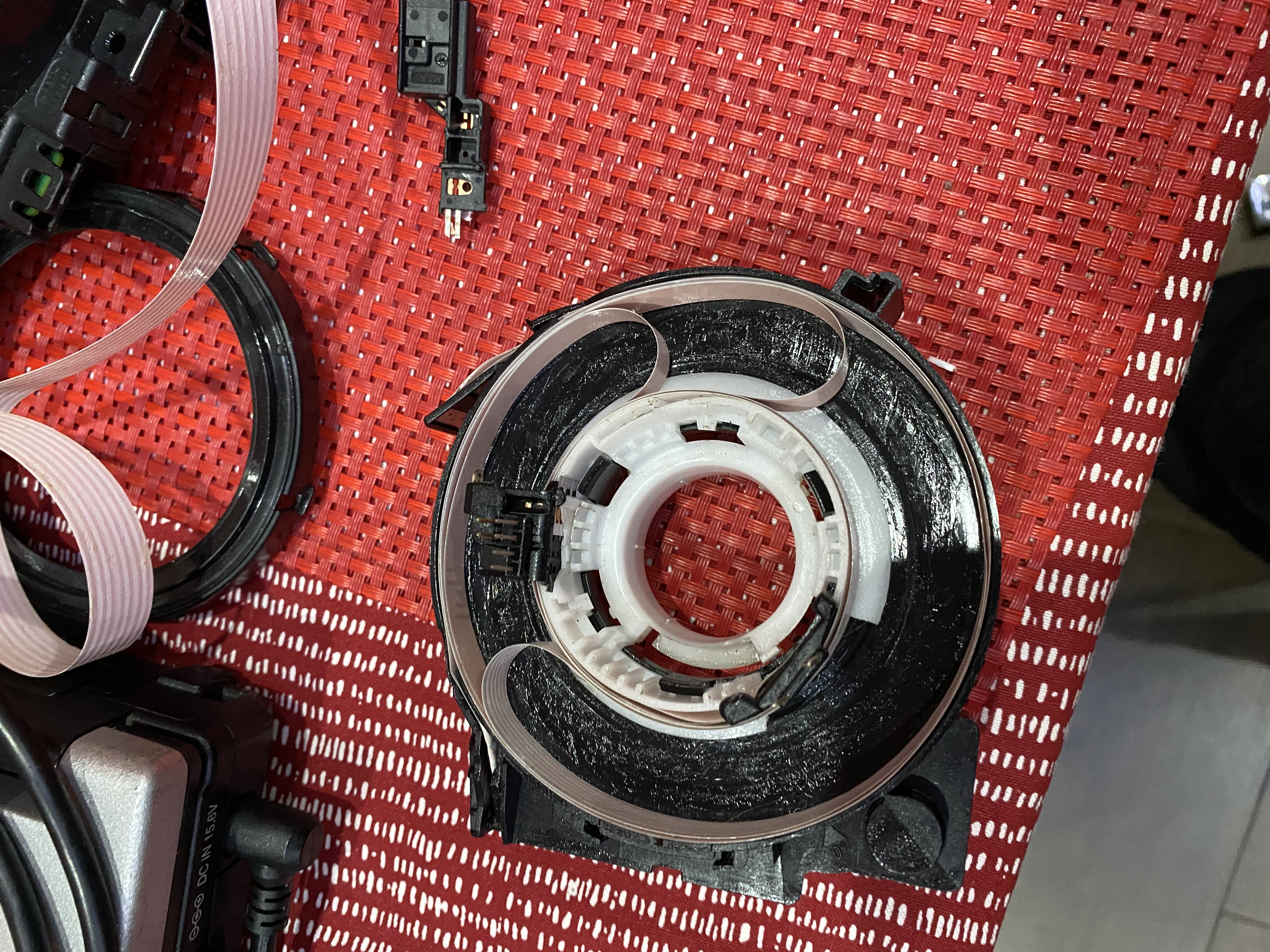

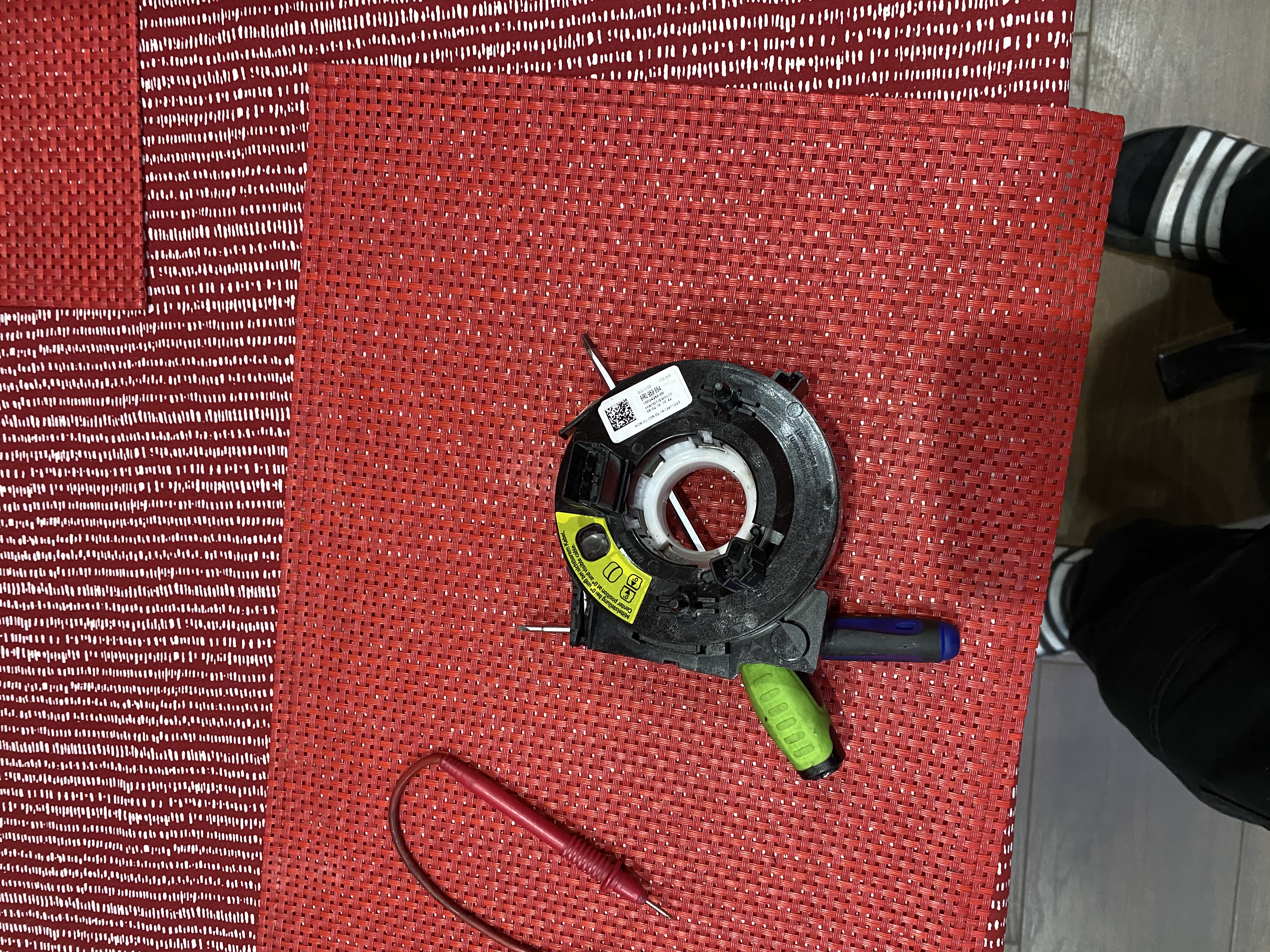

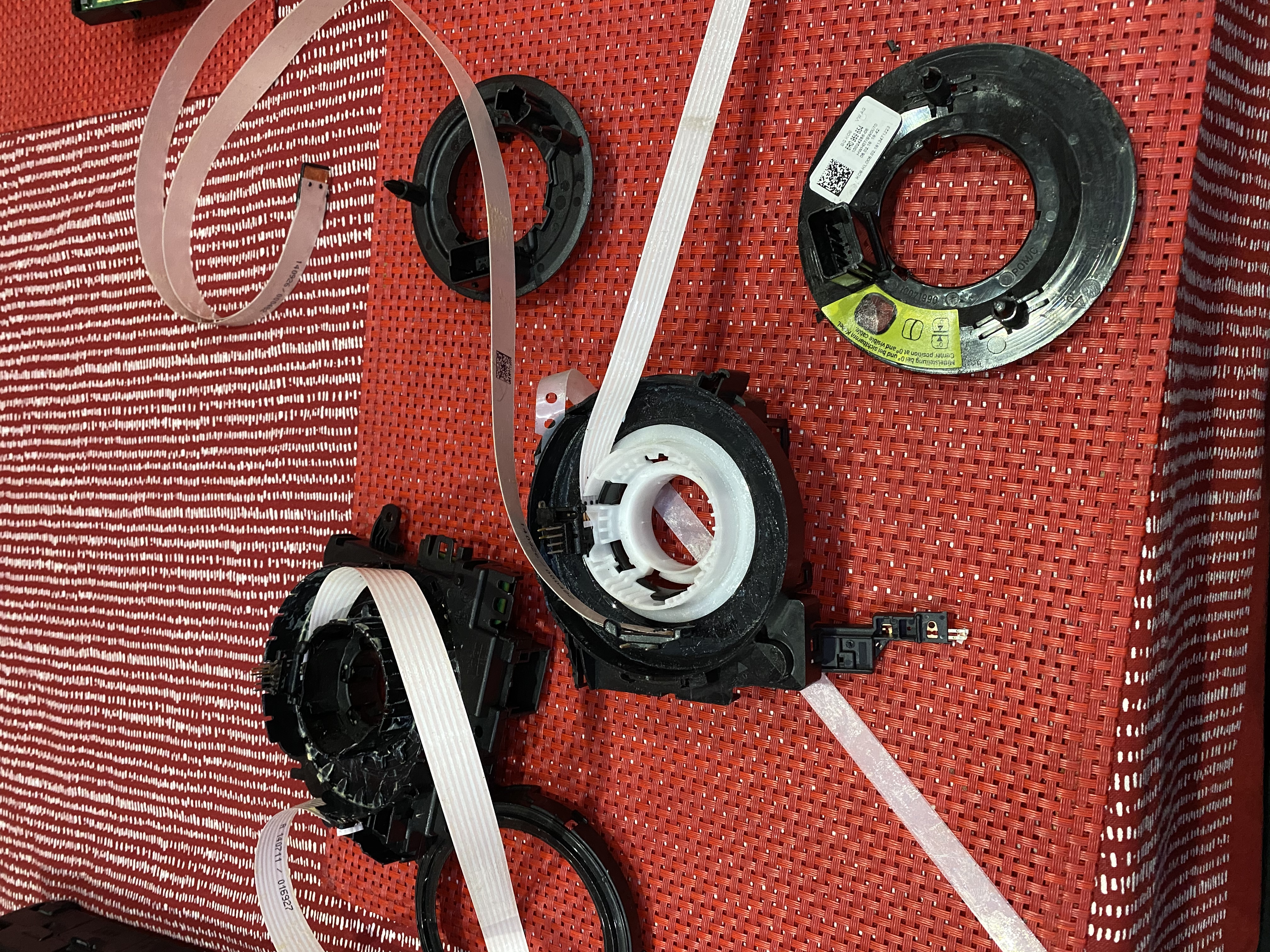

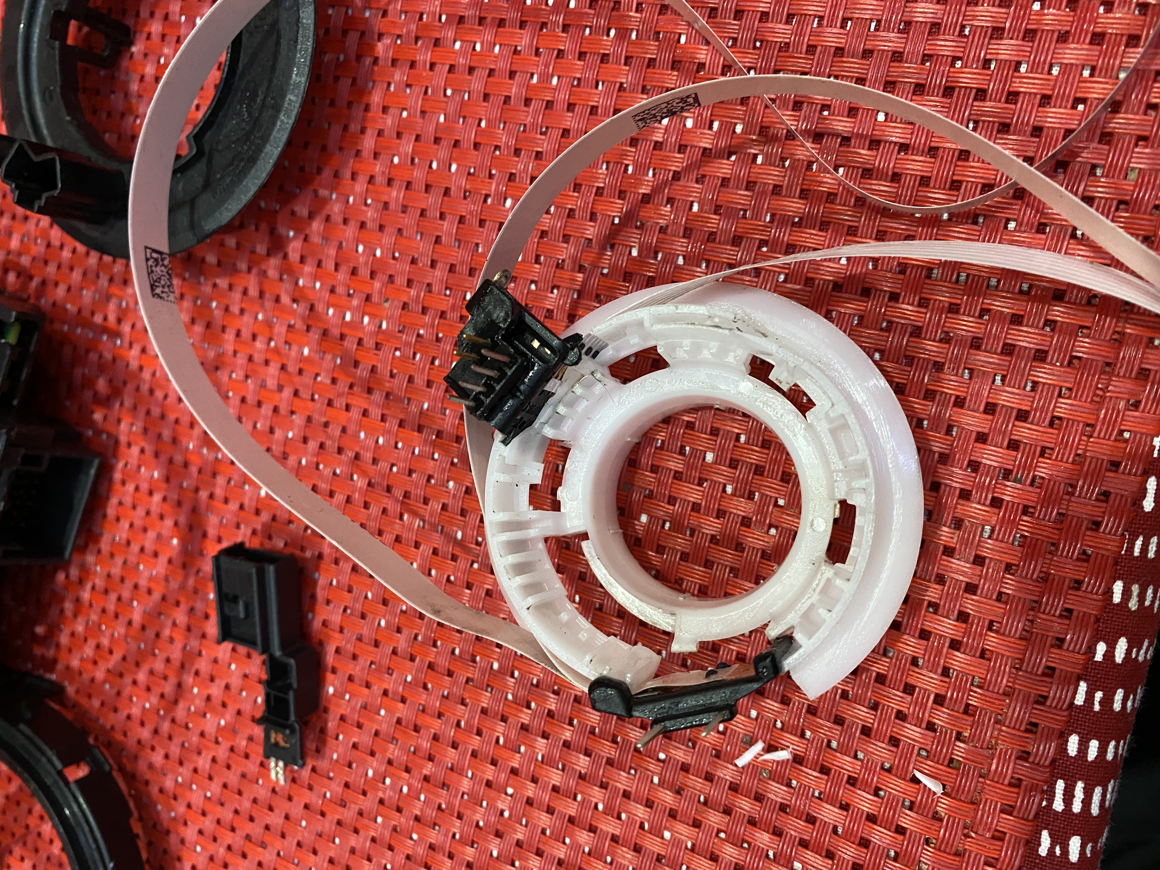

bropasiek
Posts: 35
Joined: Tue Aug 25, 2020 4:29 am
Drives: Caravelle T5.1
Location: Leicester
Post by bropasiek »
Hi Ciclo,
Thank you for a link with slip ring mod for heated steering wheel
I did one myself, maybe not as good as one from the link, but it does a job
Posts: 8912
It seems like an excellent job! 8) 👍
PS: I have the same summer flip flops, I think they are adidas.😂 (please forget this comment)
