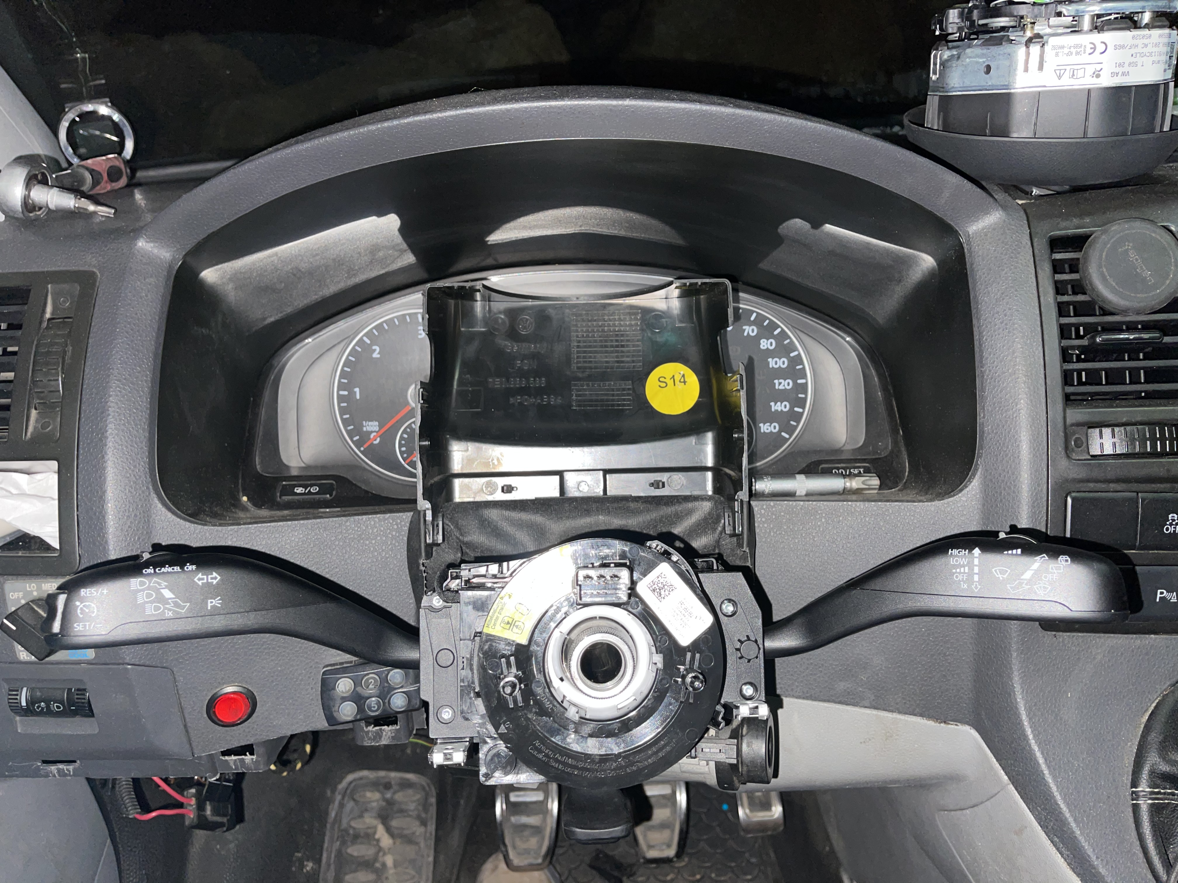

So finally I’ve got the new slip ring and the stalk
I have make all the additional wiring like Adams digram, no faults on vcds, but still no high beam, and the high beam light on the cluster is always on

Posts: 8992
Re: BCM Max Transporter 2013
Shadow109 wrote: Tue Dec 29, 2020 5:42 pm So finally I’ve got the new slip ring and the stalk
no faults on vcds? :lol:
New navigation system! 8)
1- Make basic setting of the G85 sensor in Address 03 ABS. (priority)
2- New BCM coding:
A8A0393A0E212012002808902E2B8CD4F08043FF60040040320000020800
BCM adaptation --> Channel 54 ... from 0 to 1.
Notes:
- you have disabled the lamp diagnostics, ... for now we will leave it as is.
- if you have to re-enter the BCM coding, this new BCM coding will be your starting point. As future new BCM codings improve, they will be your new starting points in case you have to re-enter BCM coding.
3- Please show us a picture of the unlock mechanism for the rear lid of your T5.
Note: Maybe you encoded some Bit in BCM 087 that does not correspond to your tailgate opening.
4- Install RLS + HBA mirror.
This post deserves a music video :lol: :
Shadow109
Posts: 154
Drives: Vw t5.1 2013
Location: Israel
Post by Shadow109 »

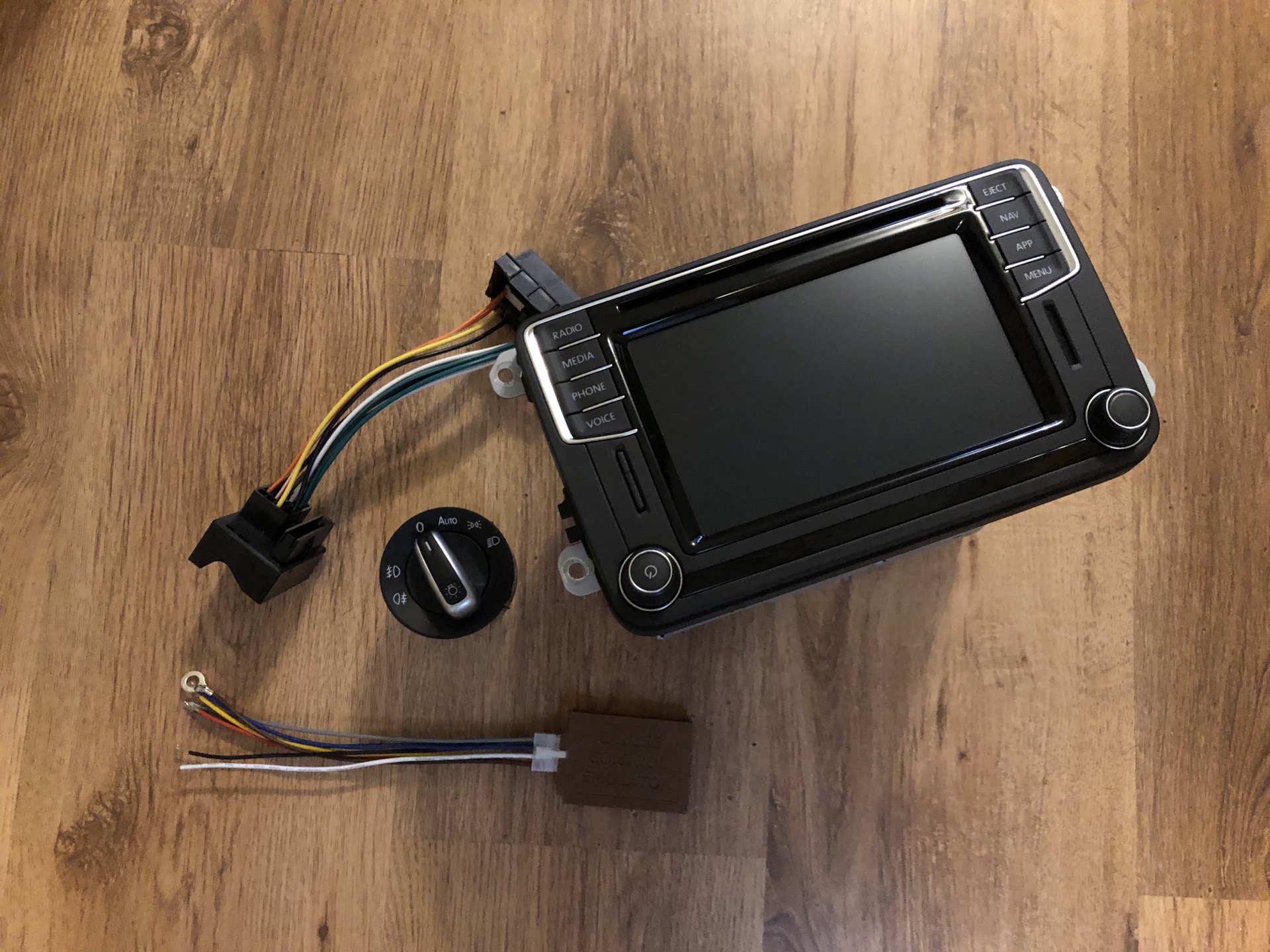

ciclo wrote: Wed Dec 30, 2020 9:10 am New navigation system! 8)
I'v got some toys from Madwarlock :D
ciclo wrote: Wed Dec 30, 2020 9:10 am 1- Make basic setting of the G85 sensor in Address 03 ABS. (priority)
it shows me an error, (tried with ignition on)
ciclo wrote: Wed Dec 30, 2020 9:10 am 2- New BCM coding:
Done, Interior Illumination Is working now, High beam light still not working, but high beam icon on the cluster gos on and of with the stalk
maybe something wrong with the wiring ?!
ciclo wrote: Wed Dec 30, 2020 9:10 am 3- Please show us a picture of the unlock mechanism for the rear lid of your T5.
I have retrofitted an electric rear tailgate, I will make some photos later

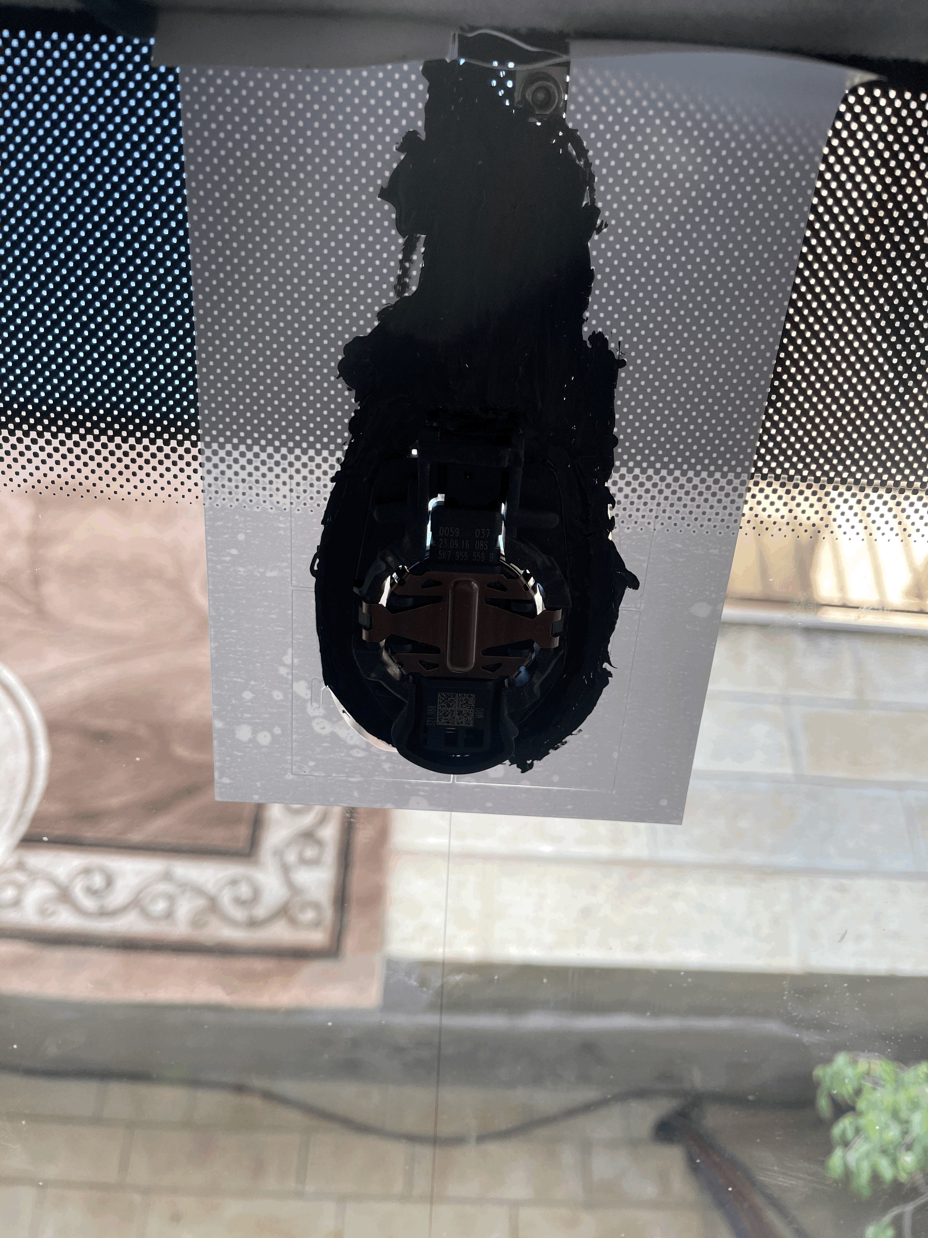

ciclo wrote: Wed Dec 30, 2020 9:10 am 4- Install RLS + HBA mirror.
waiting for 2k adhesive :cry: :cry:

Posts: 8992
Nice Madwarlock toys. An excellent buy, you will get more than expected. :wink:
To be able to perform the basic setting of the G85 sensor you first have to enter the security access.
The process should look something like this:
http://wiki.ross-tech.com/wiki/index.ph ... ic_Setting
Regarding the BCM we have improved enormously.
Have you correctly connected the wires for the high beams of each headlight?
- From T73a/1 and T73b/1 to the input (A) of the fuses for the high beams.
In that case, try this new BCM coding:
A8A0393A0E212012002808D02E2B8CD4F08063FF60040040320000020800

I made A little homework today :-
Posts: 8992
Perfect!!! we get better again, G85 sensor solved!
This last Autoscan means that you will not have any problems when installing the RLS and the HBA. :wink:
Regarding the high beam of the right headlight it is a fault in the wiring, fuse or bulb. Check them out.
Remember that this is the SB28 fuse, in which and according to the installation manual, you will have also added the wire that goes to the high beam warning lamp.
Therefore, ... T73a/1 -> (A) Fuse SB28 (B) -> right high beam wire + warning light wire.
The remaining faults in the autoscan are normal due to the installation of the 5F unit, you must code it according your equipments installed.

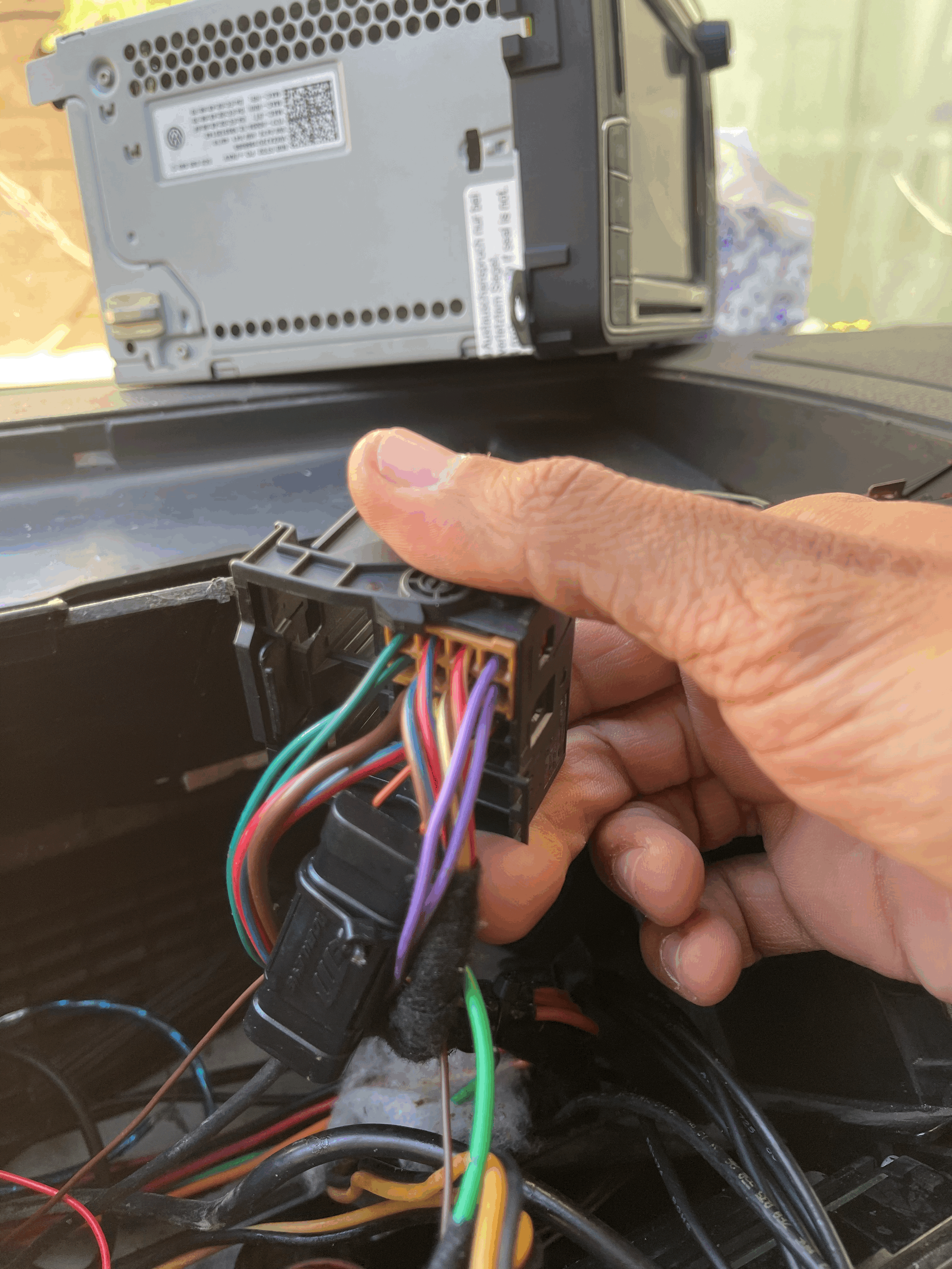

Thanks for the pictures of your progress with 5F.

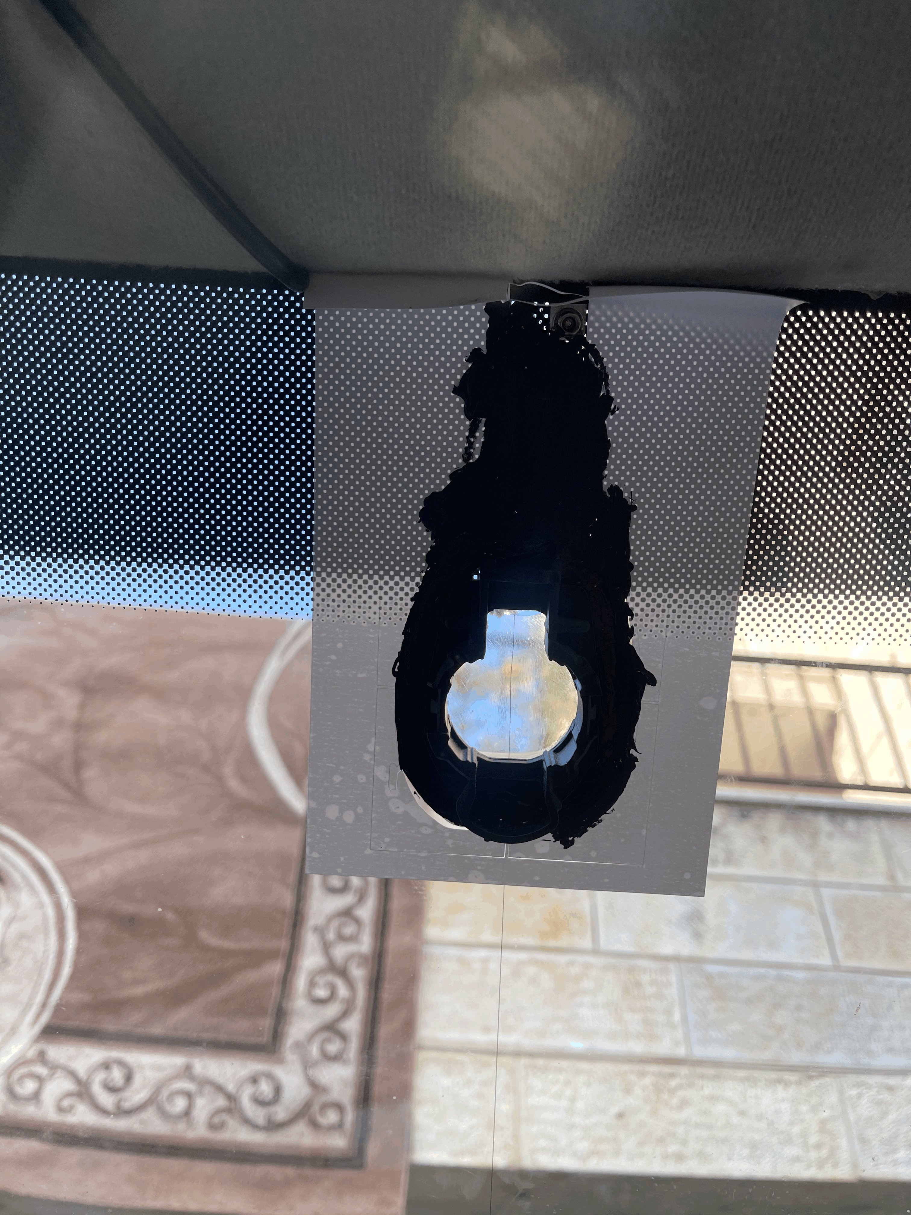

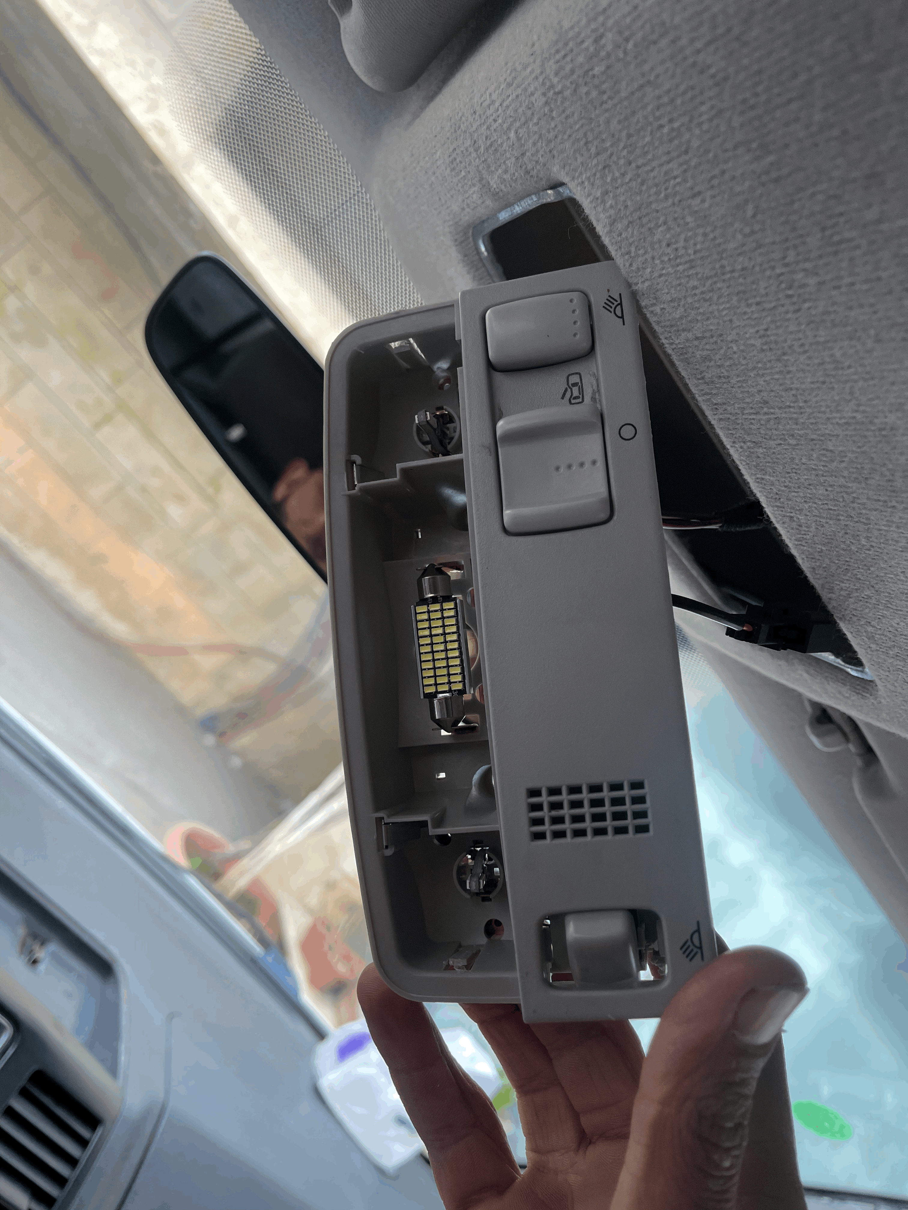

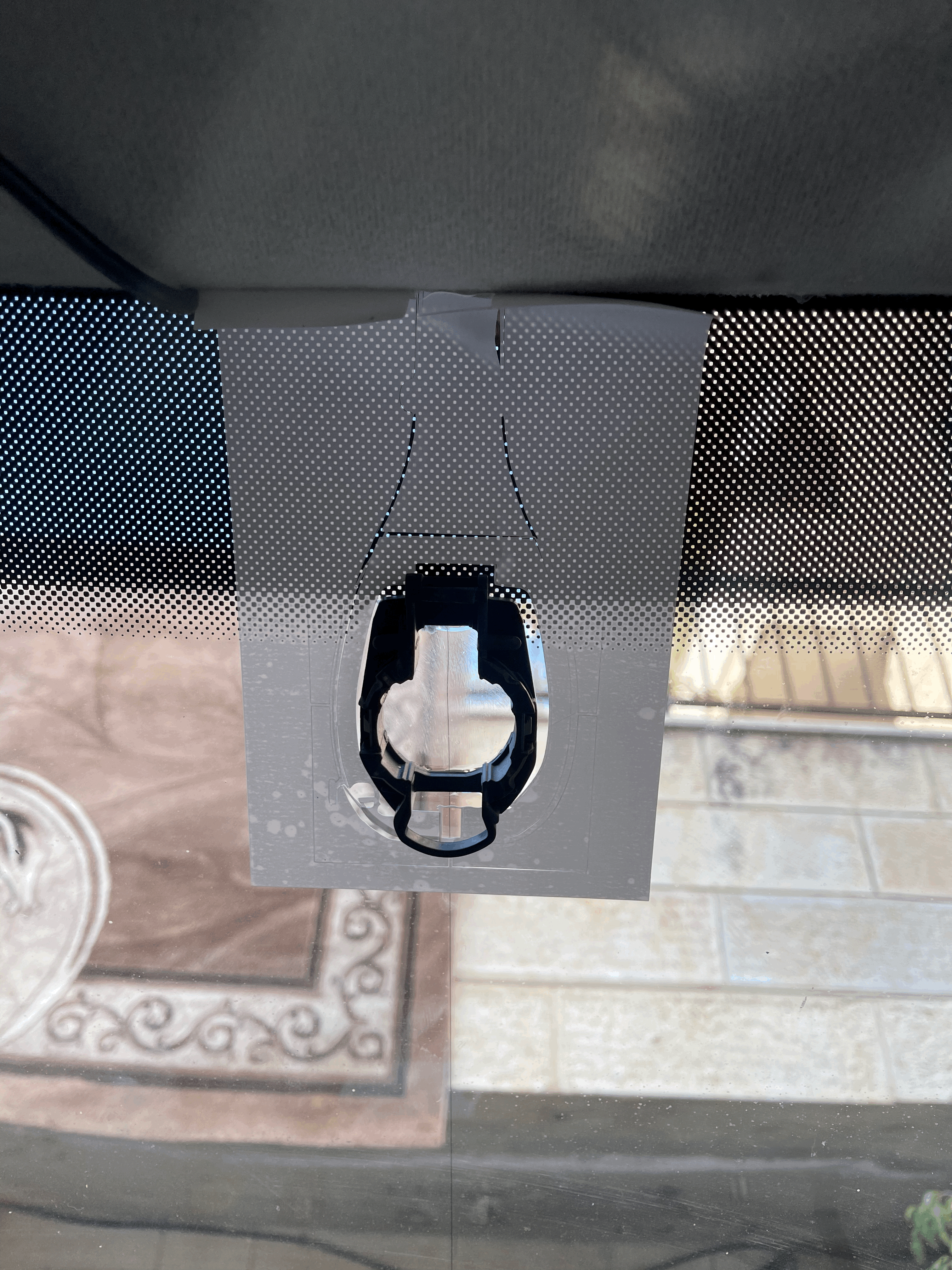

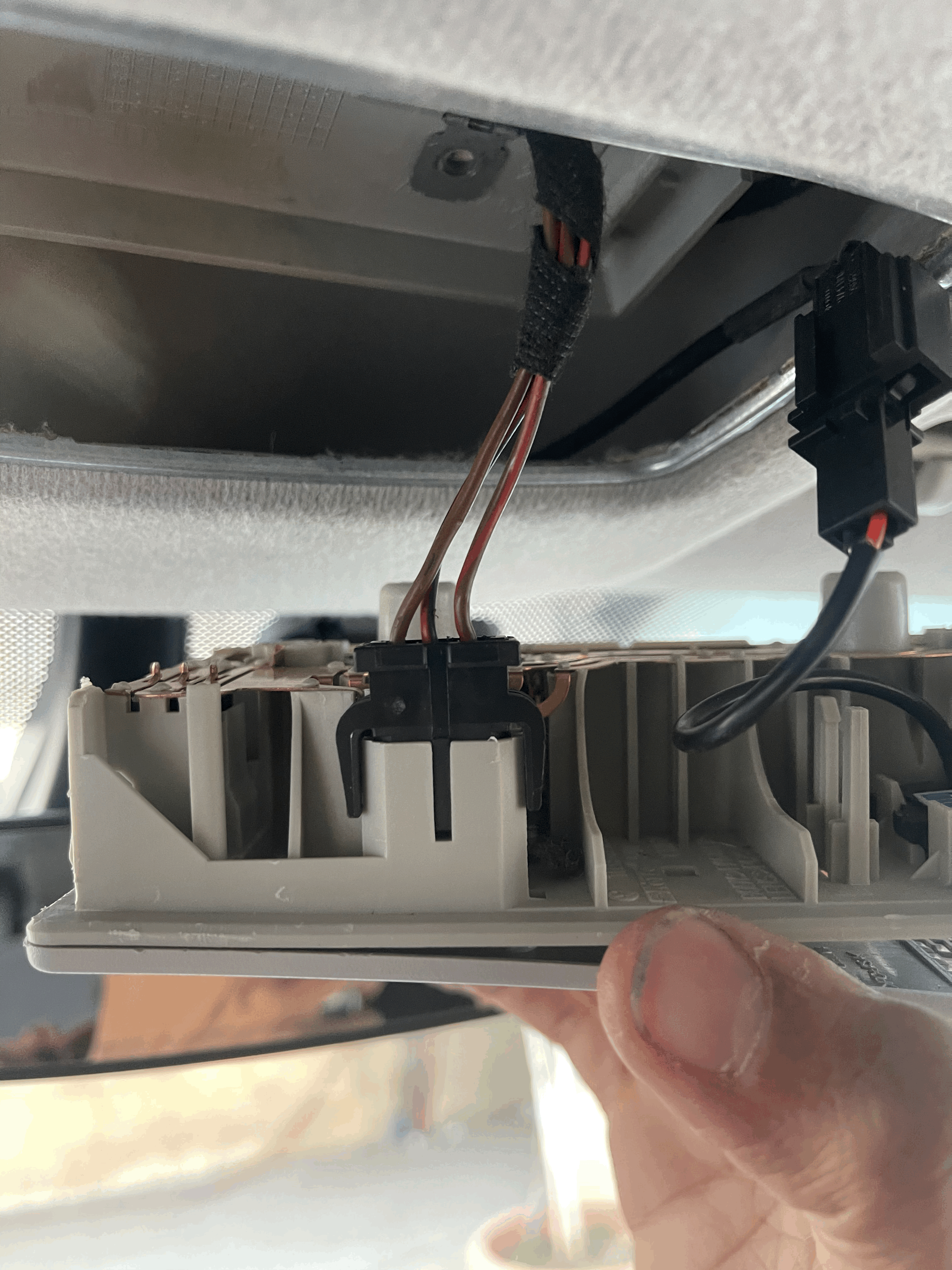

hello again Ciclo, I have installed HBA & RLS today
wiring :-
Mirror T8 :-
3- T73b-54
8- T73b-57
6- middle lights (I didn't install it) (please explain to me where to install it)
1- SC32
2- GND
RLS T3 :-\
1- +30
2-GND
3- T73b-24
coding that I made :-
black 9 :-
byte 4 bit 6
byte 8 bit 0
byte 10 bit 1& 2
byte 13 bit 7
byte 14 bit 1
byte 22 bit 5

Interior Light is not working
CH/LH not working
HBA not working
I wonder if all the issues is caused by the uninstalled wire :?

Regarding the mirror:
- The feed wire for the mirror is badly connected, the mirror needs a +15 signal (SC19) and you are using a +30 signal (SC32) ... (RLS and HBA wires OK).
- Have you connected the reverse 'signal' to the mirror? (it's just a question)
- Take a picture of the dome lights, buttons to turn on the dome lights and connector/s (T8?), ... there are different models of dome lights for T5 and it may not be possible to connect wire 6.

ciclo wrote: Sun Jan 10, 2021 9:37 am - The feed wire for the mirror is badly connected, the mirror needs a +15 signal (SC19) and you are using a +30 signal (SC32) ... (RLS and HBA wires OK).
Done

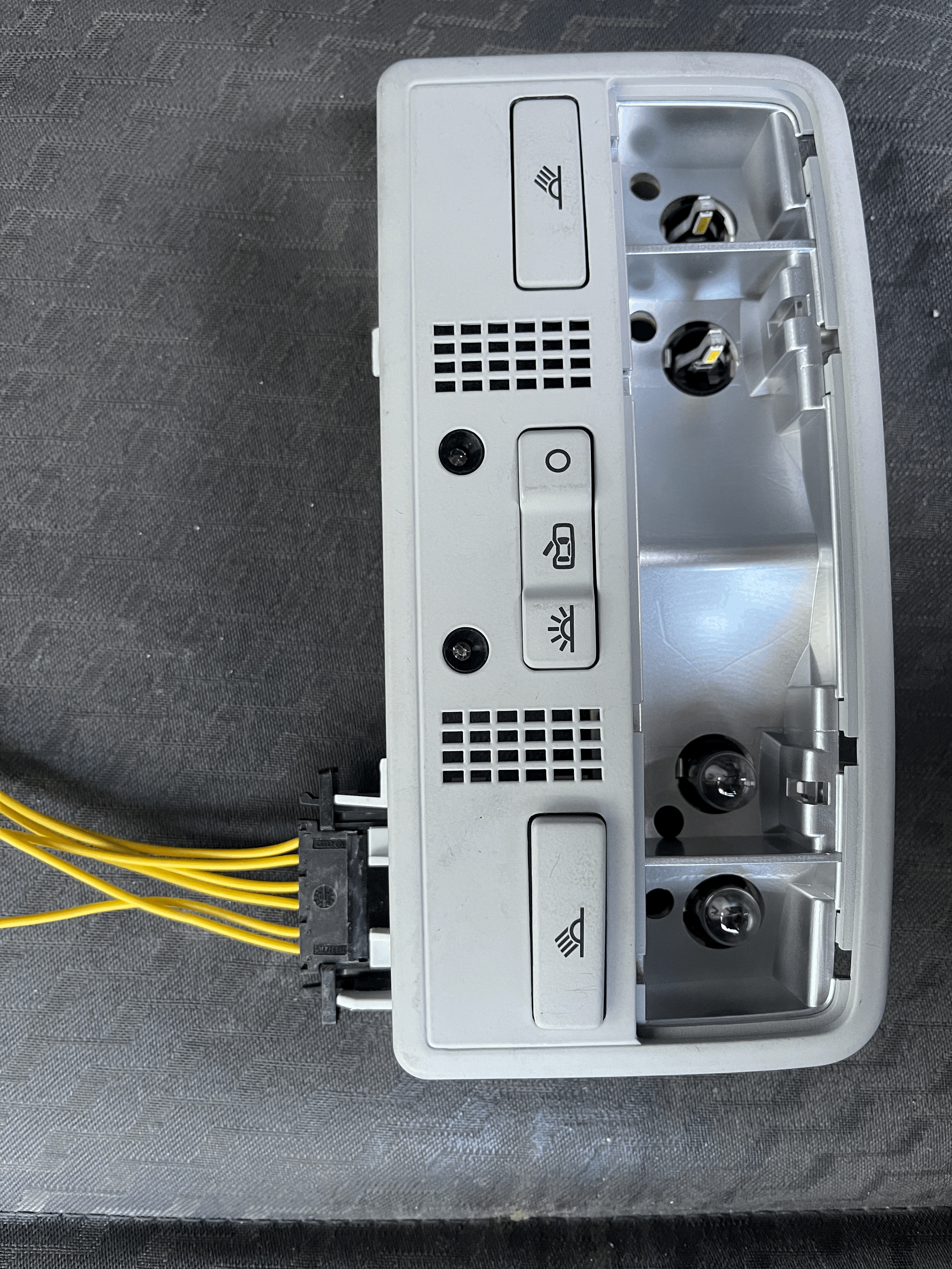

ciclo wrote: Sun Jan 10, 2021 9:37 am - Take a picture of the dome lights, buttons to turn on the dome lights and connector/s (T8?), ... there are different models of dome lights for T5 and it may not be possible to connect wire 6.
speaking about the doom lights, I wanna replace it with this :-
ciclo wrote: Sun Jan 10, 2021 9:37 am - Have you connected the reverse 'signal' to the mirror? (it's just a question)
No, to which pin ??

Your new mirror with HBA does not need the wire for the reverse signal, the non-dimming function when reversing goes through the new CAN lines.
Thank you very much for all the images of the dome lights. 👌
To install the wire 6 on your new HBA anti-dazzle mirror, the best OEM option (great option :)) is to install the Passat B5 (W8) dome lights as follows:
For those who want to know more about the Pin 6 of the dome lights with ambient lights (the two red LEDs) of the Passat B5 and other models where they were installed, I leave this diagram here:

I think I did something wrong with doom lights, when I connected it, the right light was on no matter what I did

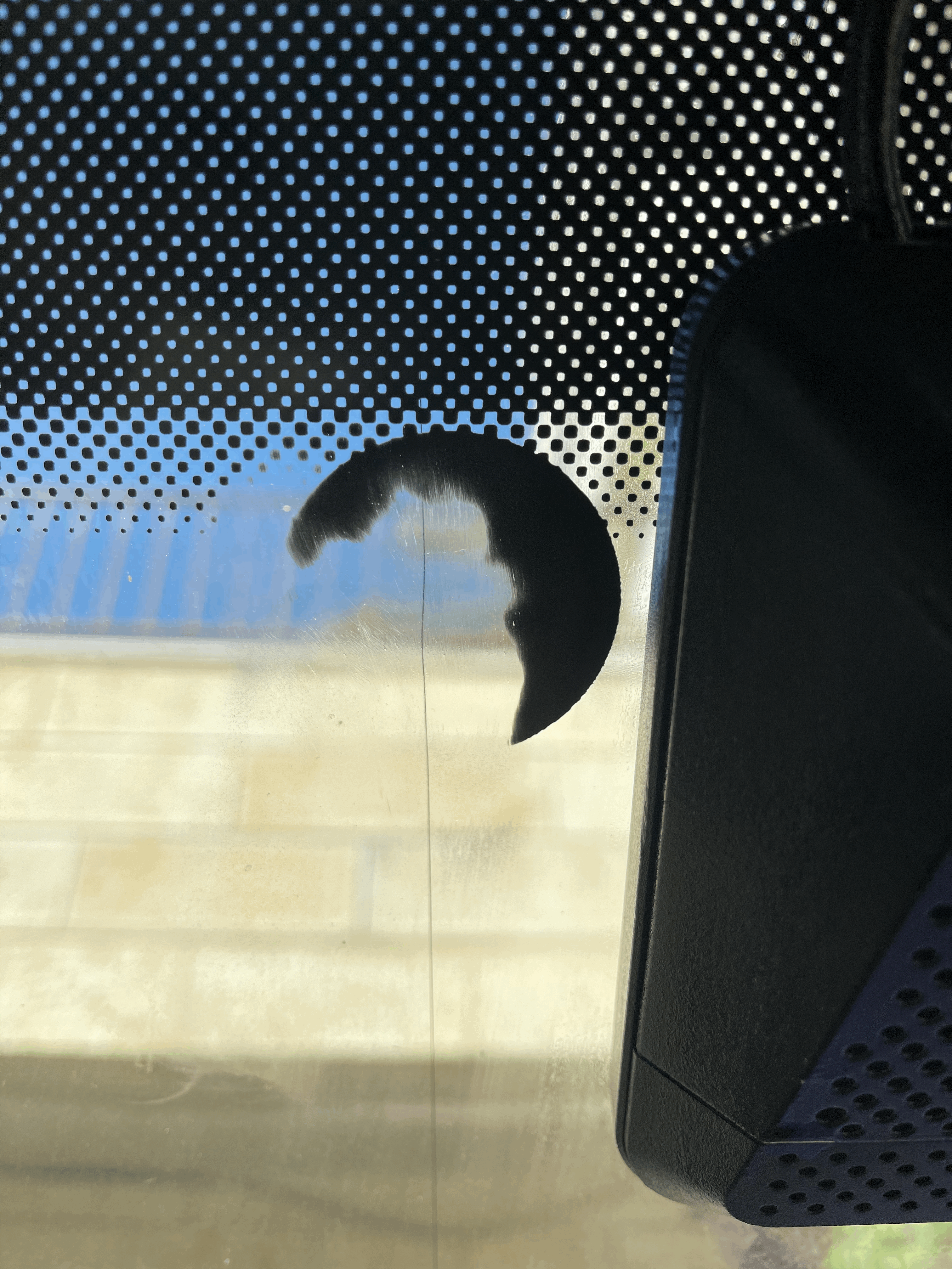

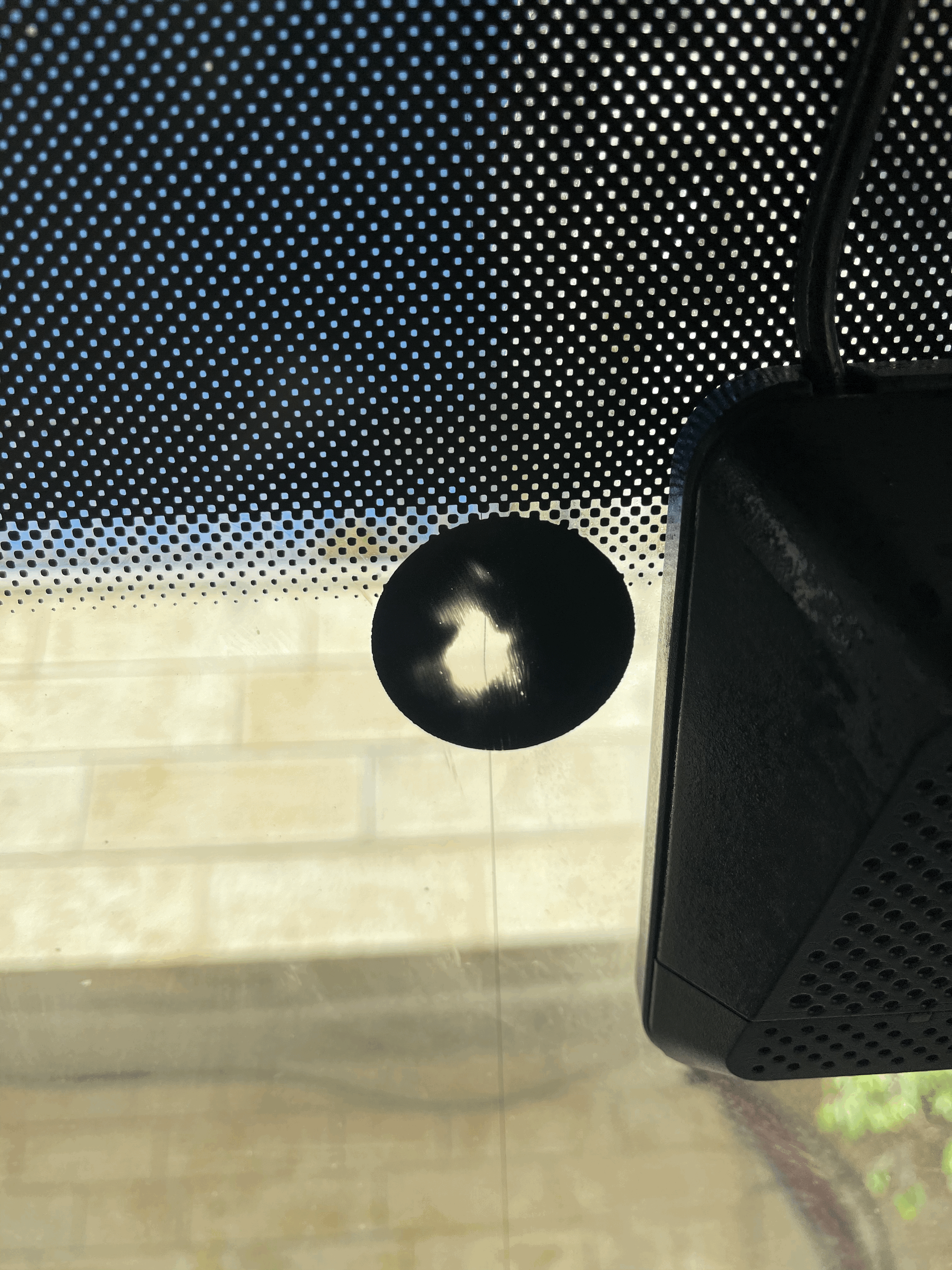

I have found a flat with RLS today

- There is also something wrong with the RLS wiring, some wire is probably not securely connected. (AUTO yes, but not CH/LH... hmm)
Check the electrical installation, pins on connectors, etc ... +30, LIN, ground ...
This is interfering with the operation of the CH/LH and the automatic operation of the windshield wiper.
- There is clearly something wrong with the wiring you have installed for the dome lights (W8). This electrical installation is producing a short circuit at some point in the installation.
If you have installed LED bulbs be careful not to short-circuit the electrical system when installing them. Check the SC17 fuse again. (install a 10A fuse)
I have double checked all the BCM coding and it is correct.
This process is getting stuck in its final phase, my conclusion is that there are some wires that is not properly installed. :?

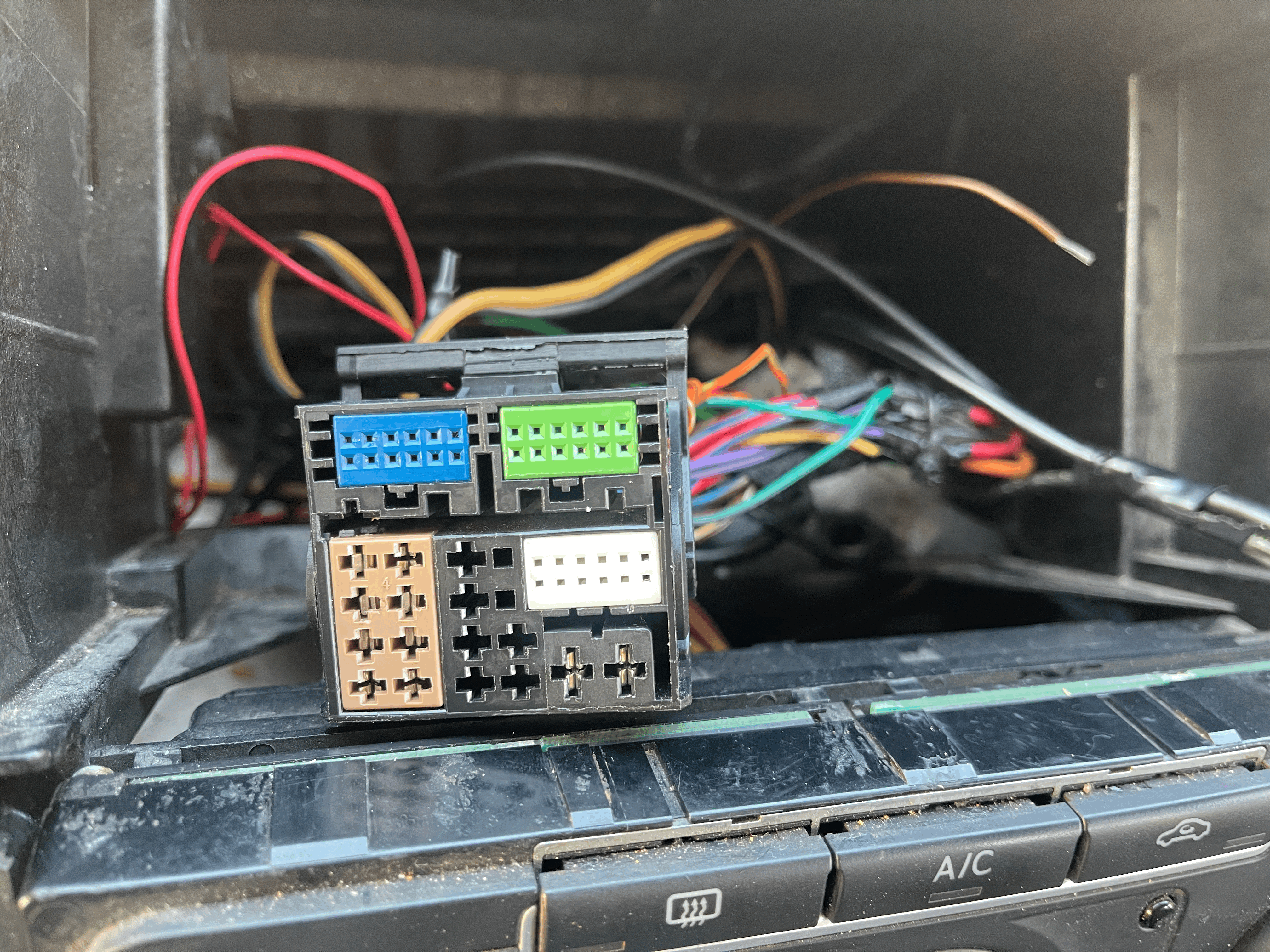

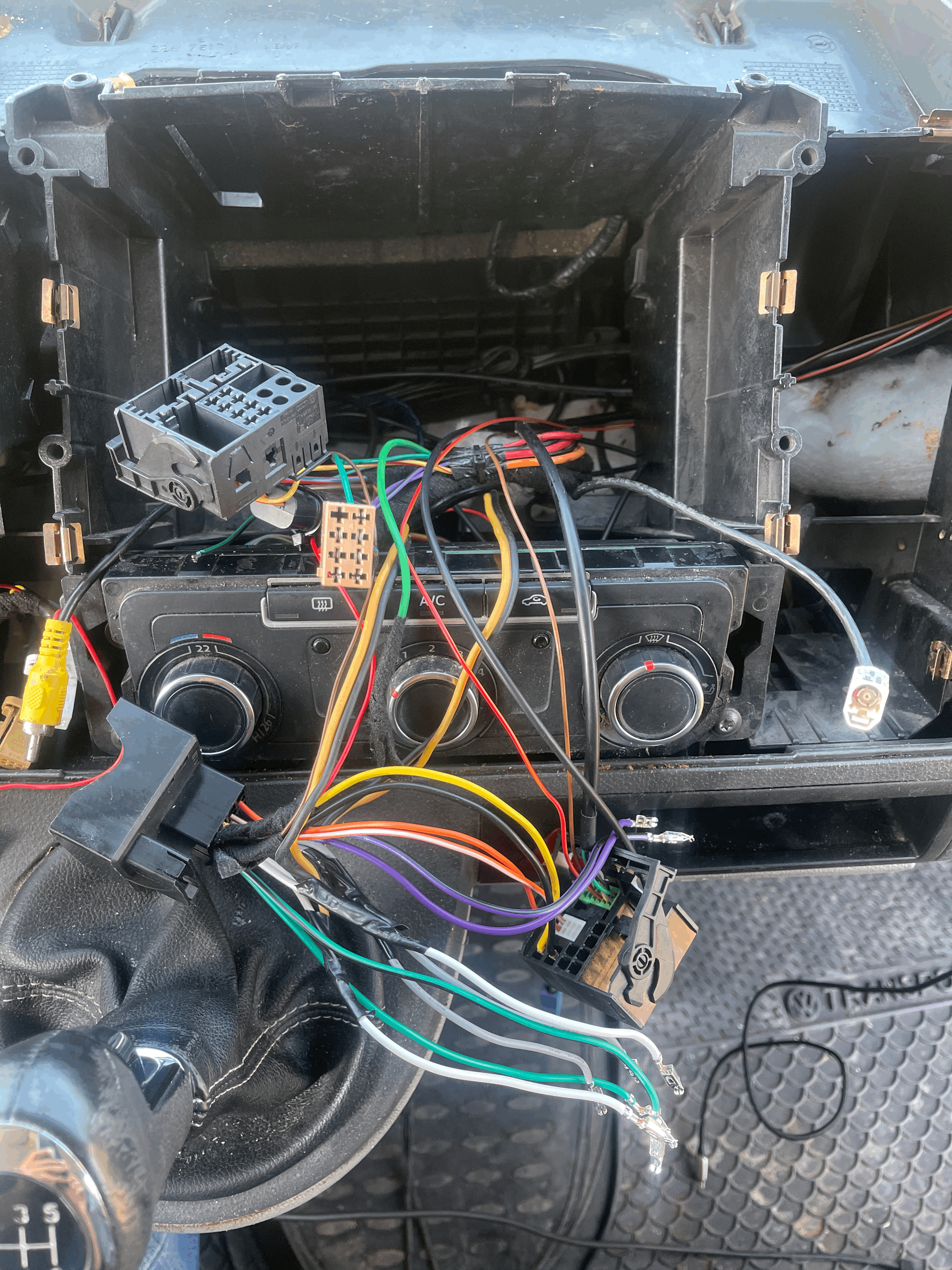

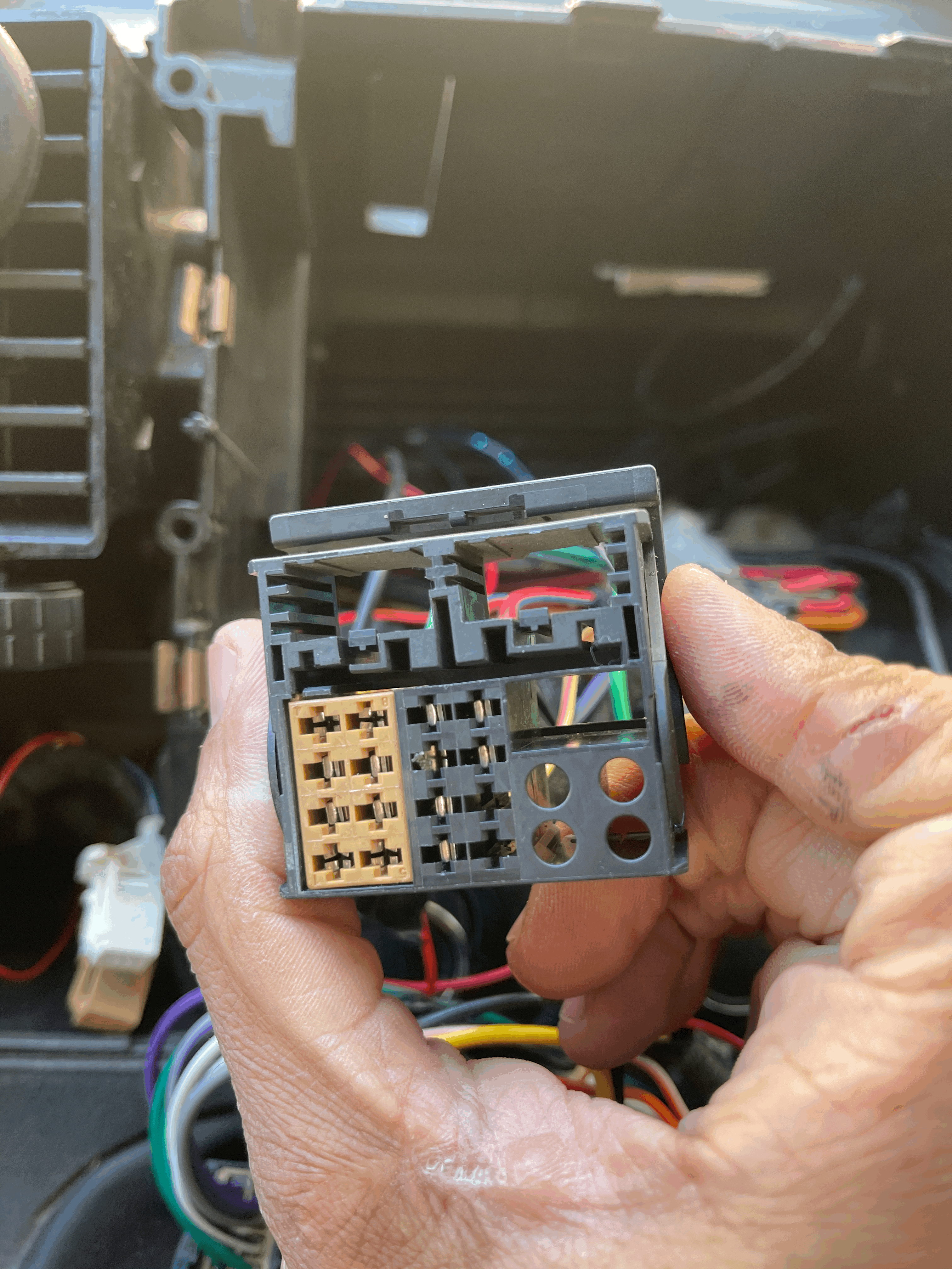

You are forced to also check the electrical installation you made for your new navigation system (due to the interior lights). :|
