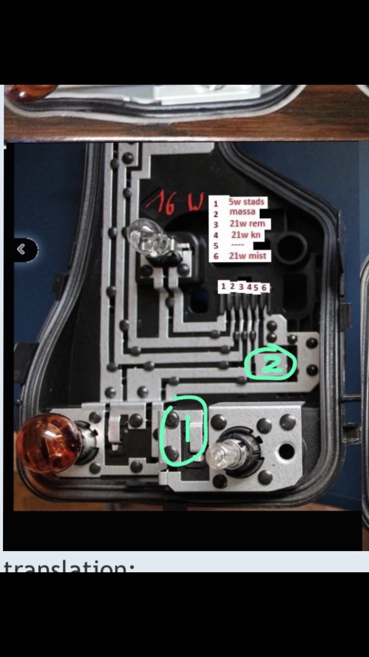

iichel wrote: Sat May 02, 2015 9:18 am
This way, the fog will be assessed to the empty place in the connector.
The reason for this is, the loose wire needs to go to fog in order to emit red light.
So now you have the passenger side tail light out, open it (it is a clicking system).
Take out the halogen fog light and put in the LED double color LED.
Solder the wire to the plate that ends in a dead end.
This is the pin that corresponds with the place where you moved the fog light wire to.
Now it is important to test first.
Put the car in reverse and you will see both sides have reverse light.
Put the car out of reverse and turn on rear fog. Now rear fog should light up in red.
If everything works, it can be necessary to turn of canbus error check of both rear fog and reverse.
What do you mean with this:
Do you have pictures or something?
So i have to solder the fog light pin to 1 or 2 see my picture?

Solder it to pin 5, place number two in your picture.
