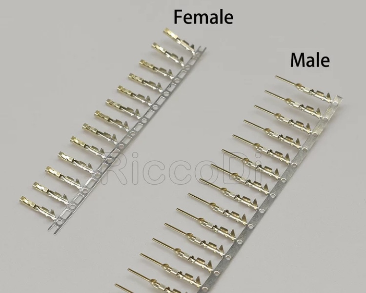

I think i need some dupont to connect it on the tail light connector, but what is the size?
