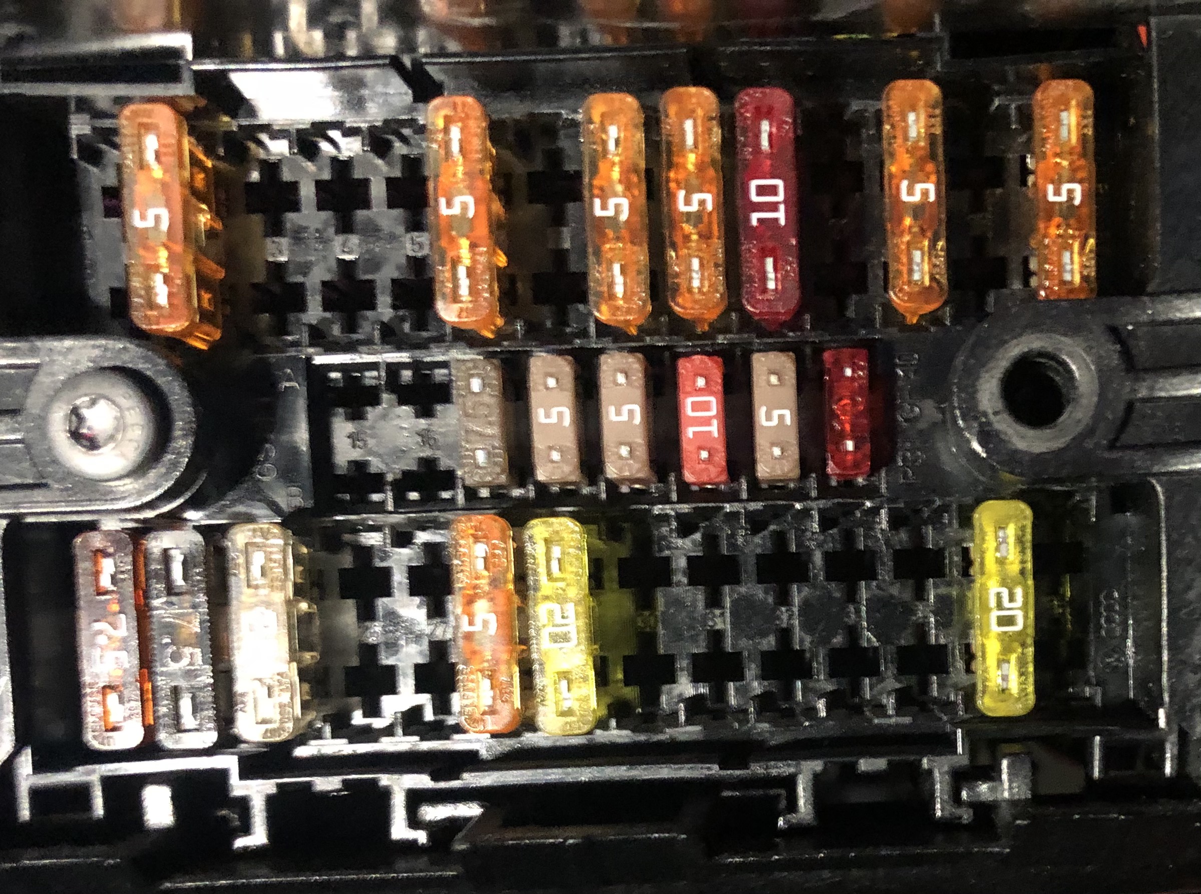

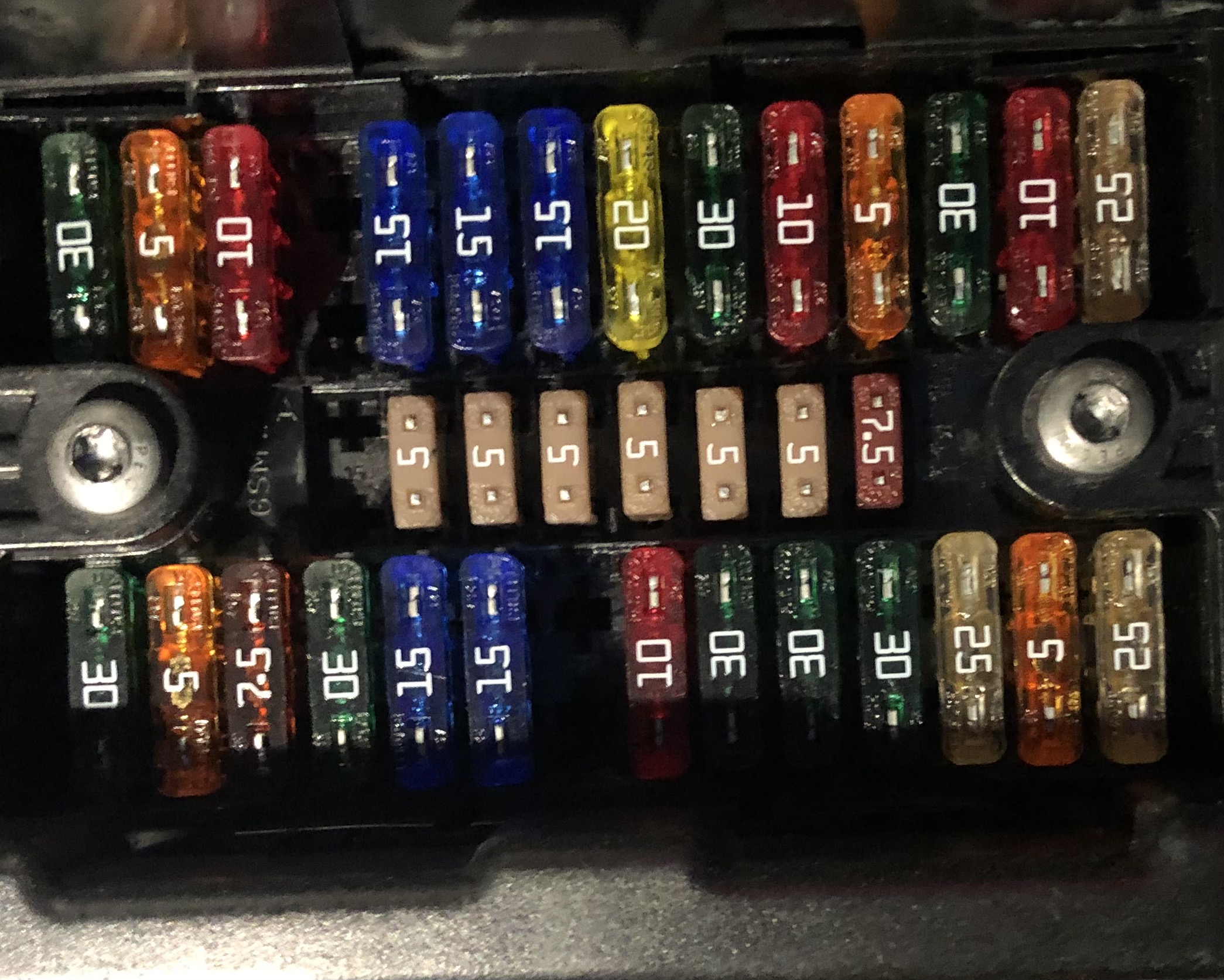

Hi Limalex, today I have some time to make your wiring looms, please take a couple of photos of the interior fuse boxes (SB and SC) and post them here, thank you.
... I need to do some checks.
asap ... please 🤐 :oops:

Just got home. Hope I am not late.
[attachment=1]IMG_0823[1043].jpg[/attachment
Posts: 8982
Re: VW T5.1 Caravelle BCM Upgrade
Thank you very much for the images! 8)
Don't worry, I had to do other mandatory tasks anyway and I really wouldn't have had time to even start making them.
Now your wiring looms are my priority (in space and time).
Everything OK with the fuse boxes.👍
