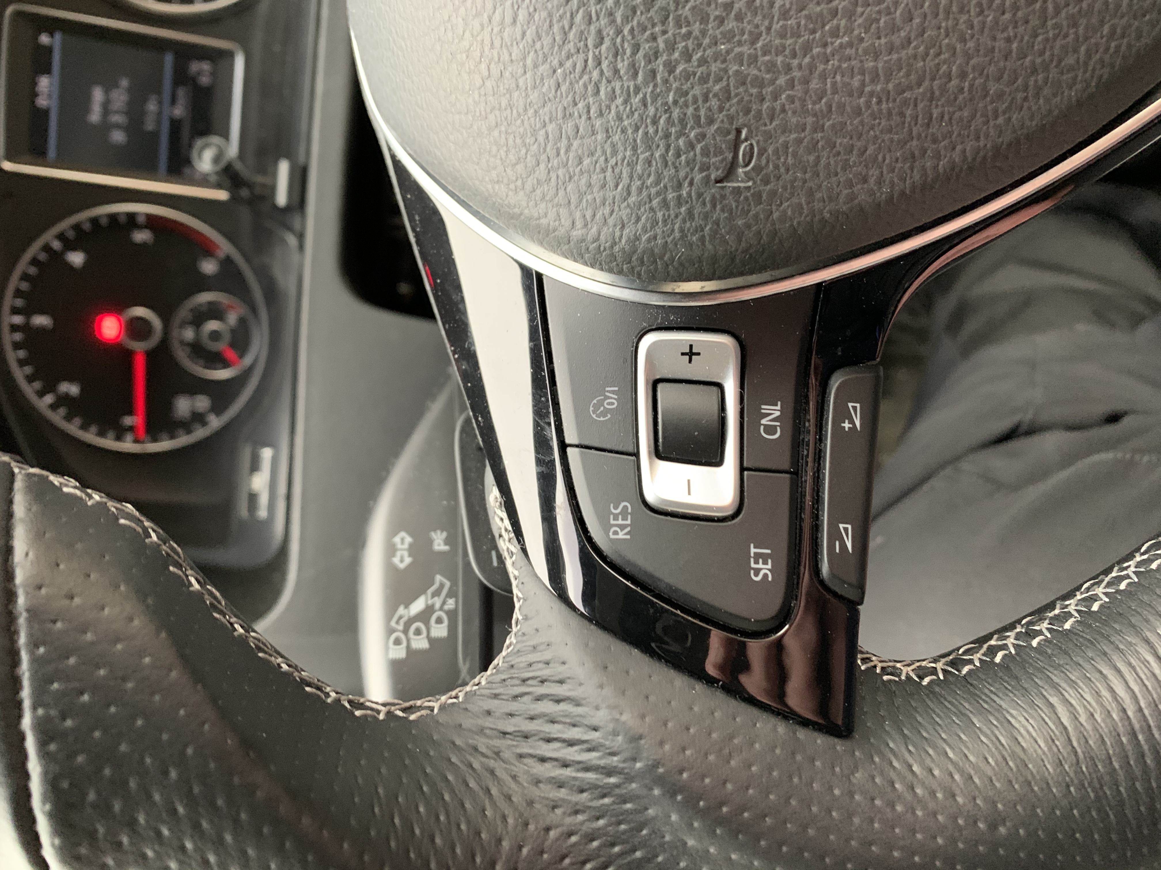

I already found one one problem.The White CNL wire was put in a wrong location. Now it sorted.
MFSW has all functions come back, emulator working.
0/1 button do not know what is the function but it operates the horn. Horn also works the original way too.
RES button increases the speed by 1
SET works as it should
-/+ works as it should
CNL works as it should
- 487D3B17-7933-492A-BC2F-5D0E55CC8722.jpeg (3.57 MiB) Viewed 4756 times

0/I is to enable or disable CCS. ... OFF/ON, Alex please is the most popular symbol and button for all devices around the world, there are no new mysteries added to this button...
The CCE exactly copies the operation of the CCS in the stalk, transforming the electronic signals of the new CCS buttons on the steering wheel into electrical signals that your BCM and ECU can understand (identical signals to those that were sent from the CCS stalk).
If your CCE is identical to the one I have installed on my 6R (please ask Slavik) and you have installed the CCE wires correctly, there must be something in your original electrical installation or added parts that is causing it.

Older vehicles with the CCs on the talk do not have that symbol nether the lorries I driving. I mean the symbol there without the 0/1. At least I learned something new agin
Regarding the parts Cannot tell the part numbers but steering wheel is come off a MK7 Golf so paddles are white
The airbag loom and the buttons I bought brand new and they for a T6 transporter. I will check tomorrow If they have the part number somewhere.
For the horn I keep thinking on that post on the T6 forum I linked in earlier. I believe all the T5 and T6 without the CCS on the steering wheel operates the horn via T42 pin 11
According the author of that post if the CCS buttons installed on the steering wheel the horn must be operated via LinBus and pin 11 need to be removed.
I could not figure out how can I tell the BCM that the horn must be operated via LinBus.
They using pin 36 on BCM but If pin 36 can operate horn I am sure pin 17 should be able to do the same.

My 6R works with the LIN 17 and everything works fine. "OEMMMMM"
https://www.uk-polos.net/viewtopic.php?p=498666#p498666
viewtopic.php?p=537303#p537303
So we must find a way for your T5 to have the same electrical configuration, in terms of compatible wires and parts. It is the correct way.

The horn on the PQ25 does not need any LIN to work, the airbag needs to have two ground points.

Removing and isolating T73a/29 everything should work properly if the electrical installation is correct and the added parts are compatible with the PQ25.

You absolutely awesome Fernando
Everything works as it should. You are really the Master of Universe
This thread successfully solved. I do not know what I would have done without you. Really appreciate your involvement.
