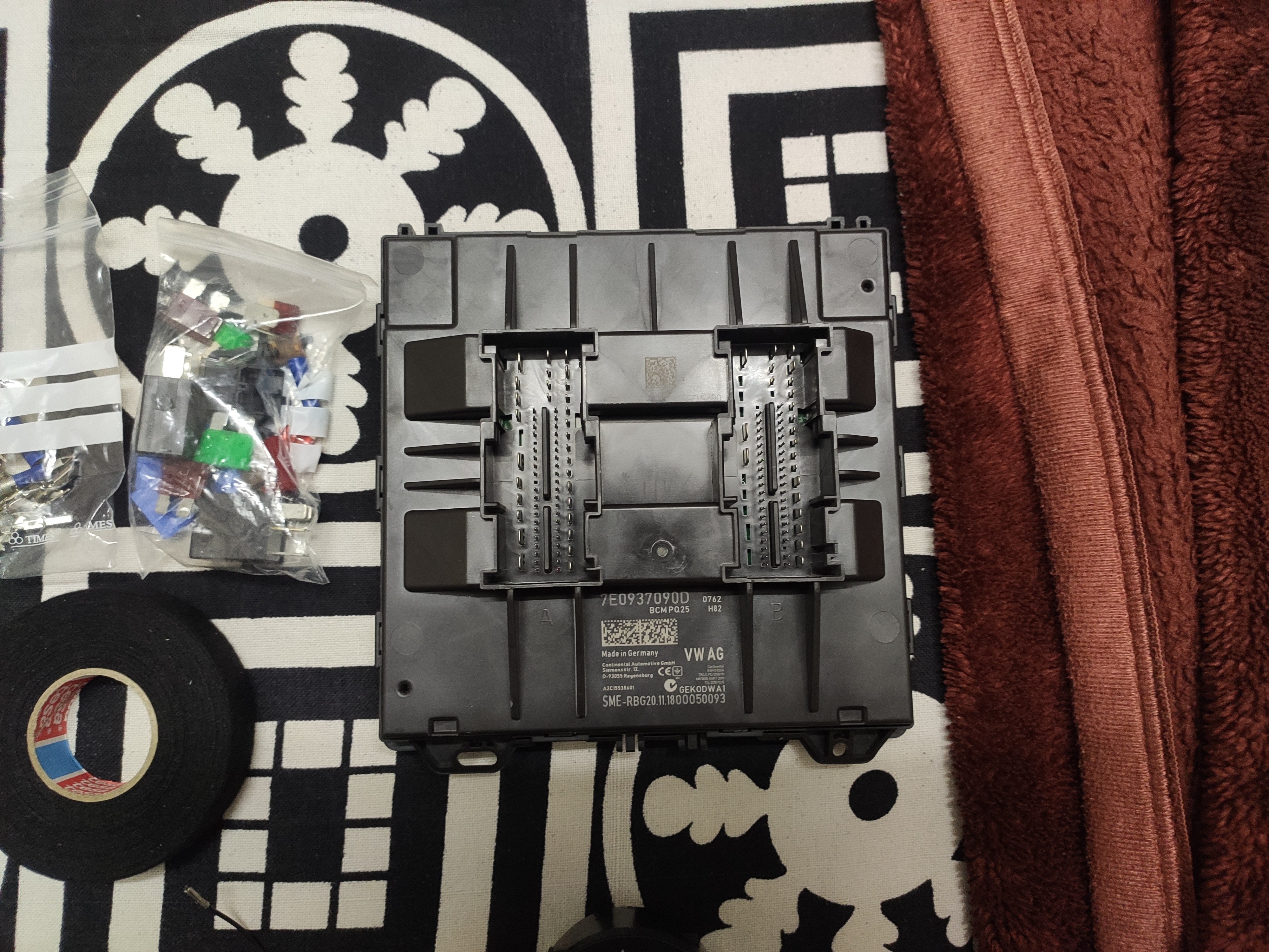

Hey Ciclo, have given firegrafik the confirmation for BCM Max and Auto Headlight Switch.
Apparently the RLS issue is common as per few car owners, the problem only occurs when you try to use VCDS to do changes. SheetalKumar solution worked like a charm, as per him if you disconnect the negative terminal on the battery for 5mins, then clear the DTCs it resolves the issue.
Have sourced parts like Dimmer Switch + Headlight Regulator, BCM Max and Auto Headlight Switch. In Search for IC with MFA+, will give a confirmation about that in a day or two.
Tuesday will do the payments for the wiring BCM Max Adaptations + Auto Headlights
Guys, have a doubt i have tried enabling rear comfort wipe (Rear wiper turns when engaged reverse gear and front wipers are on) through adaptations and long coding. Does not seem to work. Long Coding accepts the code but the next time its back to its stock code.
Any suggestions
Ciclo, if possible please send LED Number plate lights with the wiring.

Aditya, I sent you an answer by email before reading your last post.
Don't try to code new features with your old BCM, it doesn't make sense until you install the new BCM Max, which is where you'll get all the new features.
govindsharma has perfectly explained how things are with the rear window wiper, ... and your NEW Instrument cluster. 👌
My life goes fast and you go too slow for me. In an email I told you if you needed anything else from me once your wiring was finished. At that time I could have requested a dimmer from my dealer, now it is too late because of the long process it takes for the Dimmer to reach me from Germany (at the current COVID-times). Try to get it from eBay or India, maybe govindsharma can help you in this matter.
You must bear in mind that without the wiring that I have manufactured for you as a great favor, nothing makes sense, that is, the wiring (and me :lol:) is your priority, the rest of the parts, etc, are secondary because they can be obtained in any time and place.

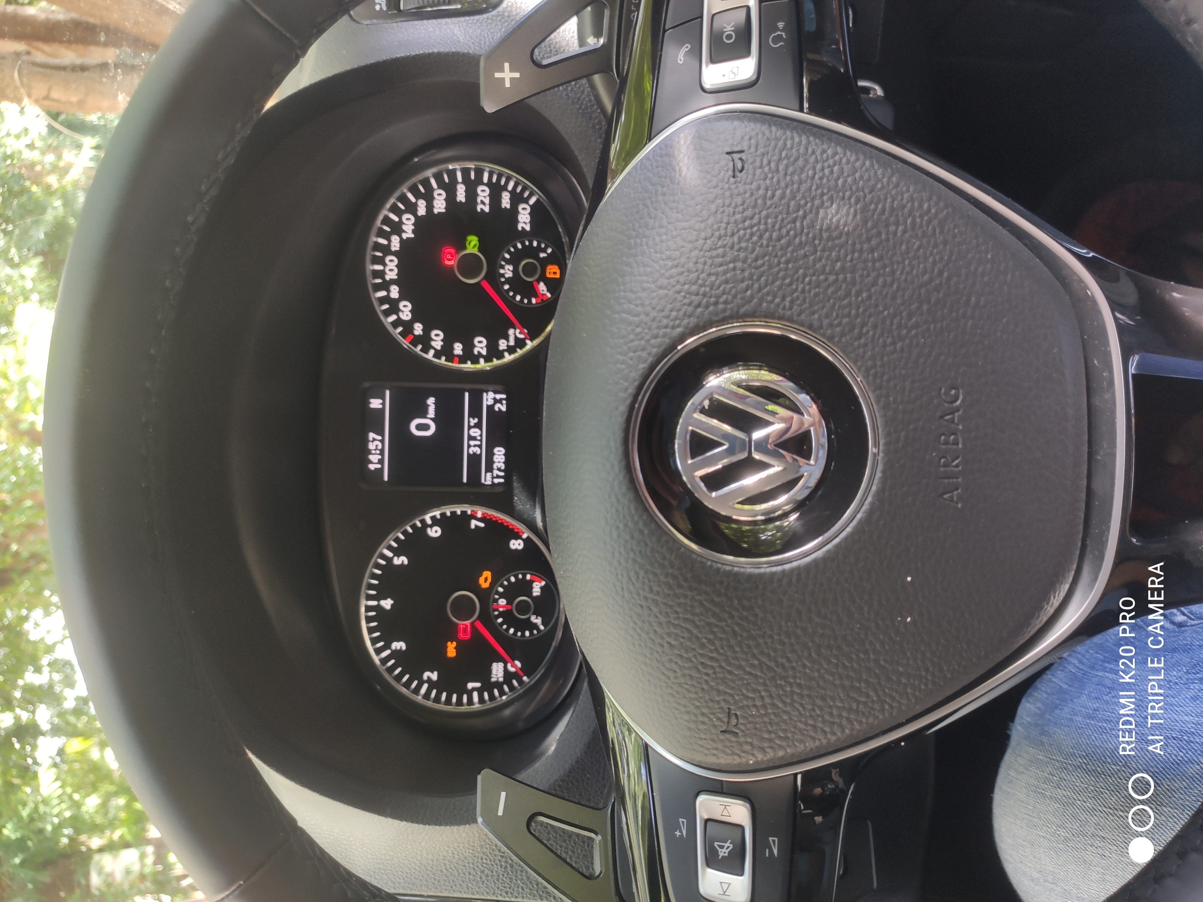

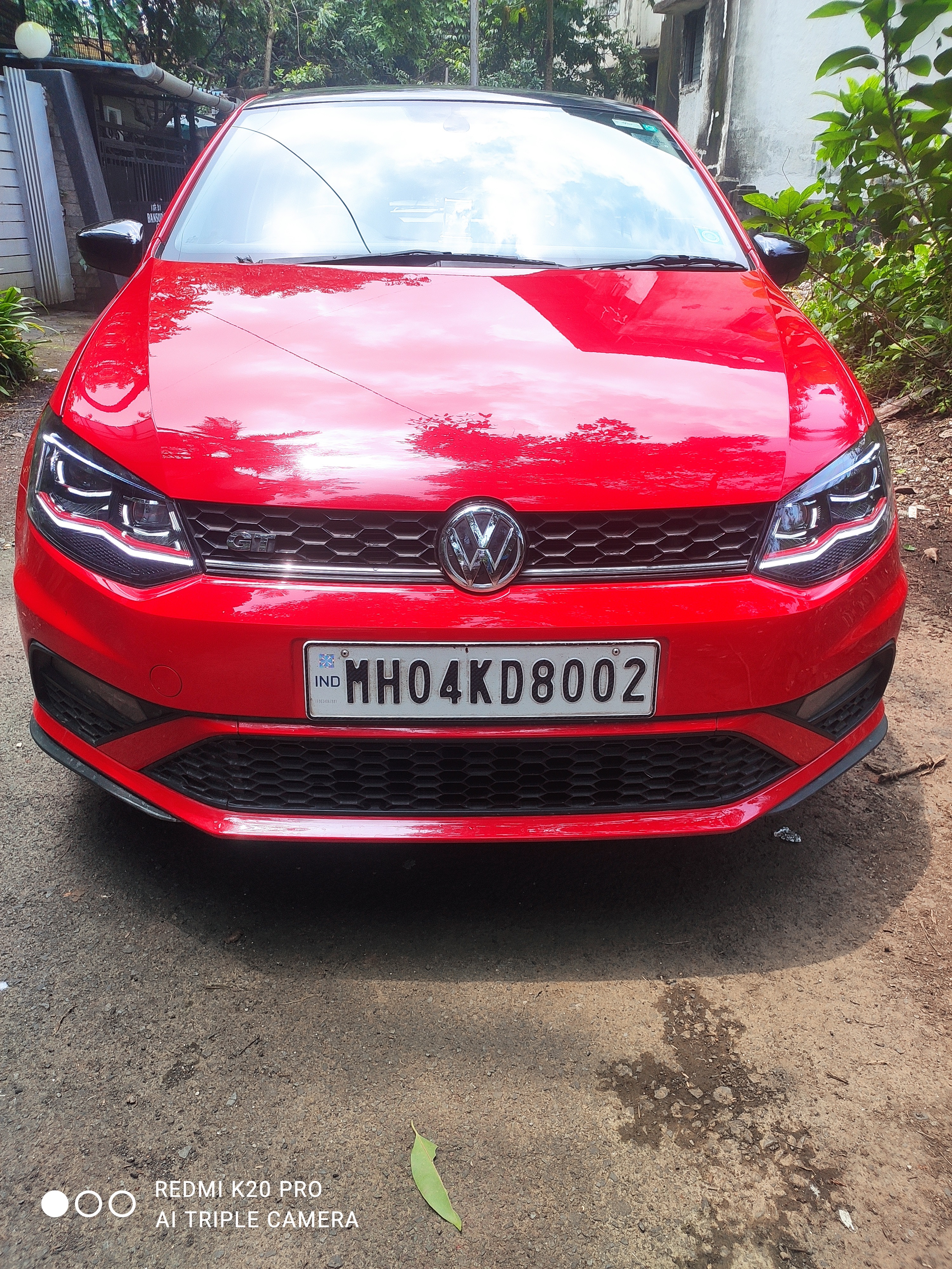

Hey Guys,
Sorry for the late post as was busy with office work and had gone a trip. Done with the installation of BCM Max with Auto Headlights with CH/LH, MFSW with paddle shifters, Maxi Dot Cluster, Dimmer with Headlight Level Switch, Aftermarket Headlights and Led License Plate Lights.
Thanks to all the people for clarifying my doubts. Specially Ciclo for the wiring kit and support, firegrafik for sourcing the BCM Max and Auto Headlight Switch.
Aftermarket GTI 2020 Style Headlights for Polo
My Polo GT TSI 1.2L
Wiring Kit by Ciclo
BCM Max
Maxi Dot Cluster
MFSW with Paddle Shifters
Low Beam Cut Off of Aftermarket Lights
Thanks to all for this. I must say the above mods gives extra premium feel to the car. Specially the convenience of having Auto Lights during road trips and Paddle Shifters for those unplanned overtakes on single lane highways.

Re: Polo 6R GT TSI 1.2 BCM Max + Auto Headlight + HBA
It looks really nice with those LED headlights (AW1 style). 8)
Those headlights really suit the car. Was the car ever involved in accident, sorry to ask but im obsessed with fender to hood alignment. Or its factory messup on 6r, i see on 6C is much better

amer6R wrote: Fri Mar 05, 2021 6:33 am Those headlights really suit the car. Was the car ever involved in accident, sorry to ask but im obsessed with fender to hood alignment. Or its factory messup on 6r, i see on 6C is much better
No it was never involved in an accident. It was messed up a little front the factory. And the rest because of the gas struts as I am only using one. Planning to add the second one also. Thanks

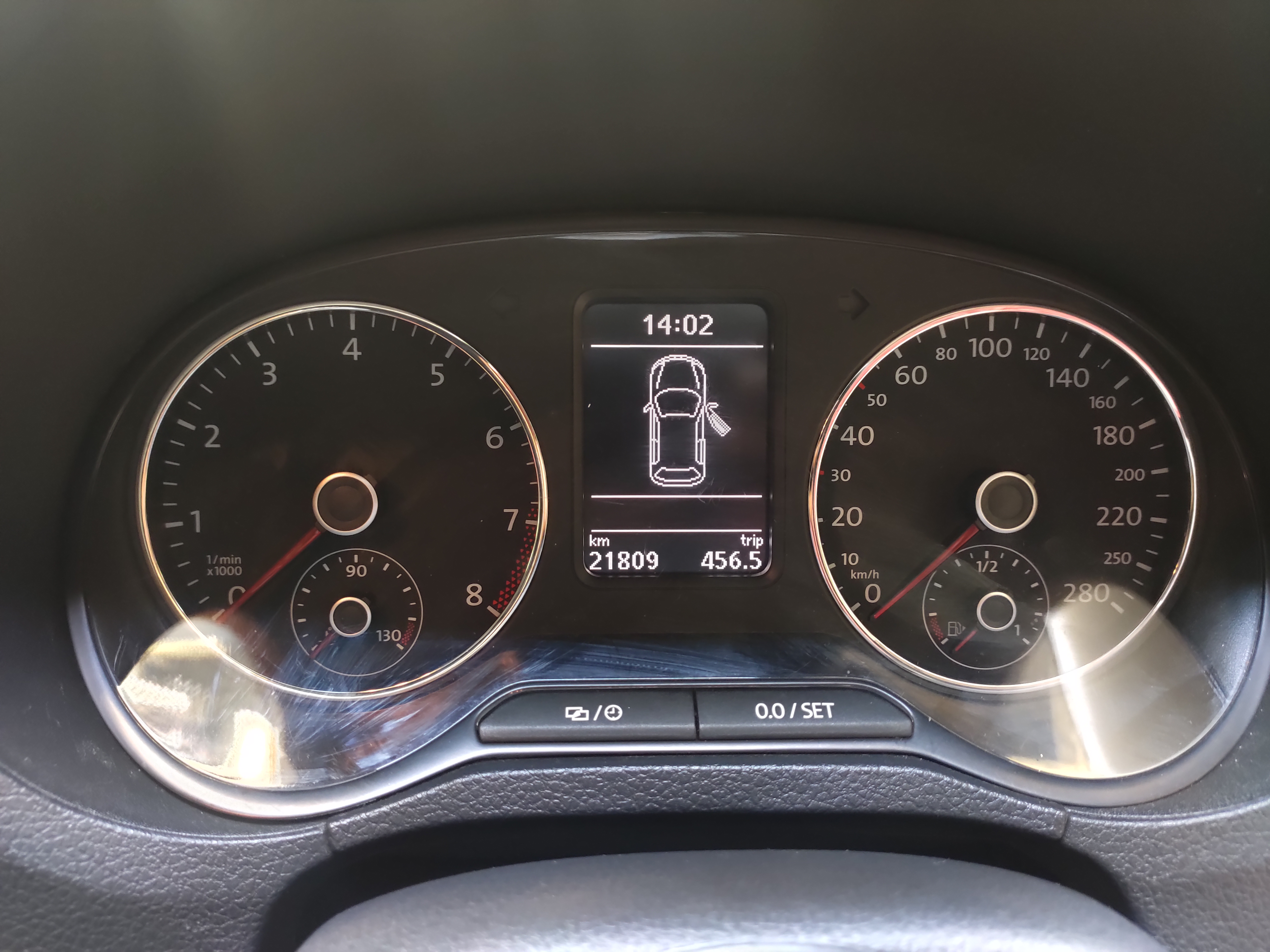

One more thing the vendors says he is 3AA sensors and antenna are tough to find(next to impossible)
Ciclo, let me know what do you think and should i purchase the antenna with sensors?
Regards.
Posts: 8976
I'm afraid your Instrument Cluster SW (same as my 6R's) is not compatible with the 2H6 antenna and therefore the 5Q0 wheel sensors.
You need 3AA. Yes or yes.
I prefer you buy from Russian seller due to technical reasons, but if it is not possible, you can buy it all from Ali.
You can also do a shopping mix and buy the 3AA flashed unit from the Russian seller and the wheel sensors from Ali. :lol:
Hmm... contact Patil, I think he is the best one to help you with this matter. His experience can help you.
