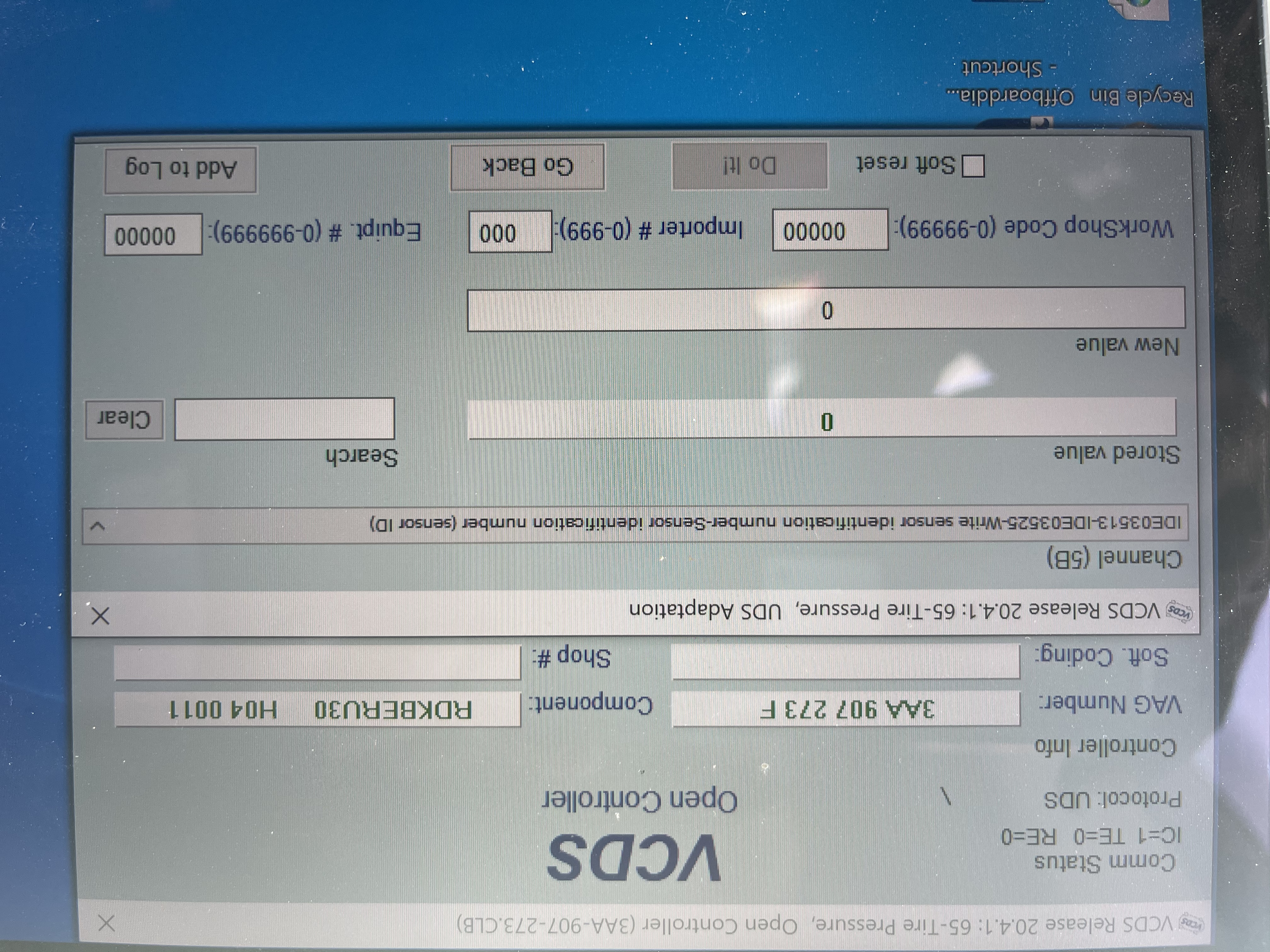

When the TPMS unit is new or flashed, this is what usually happens... it happened to me... :)
You must load the file with the wheel pressures.

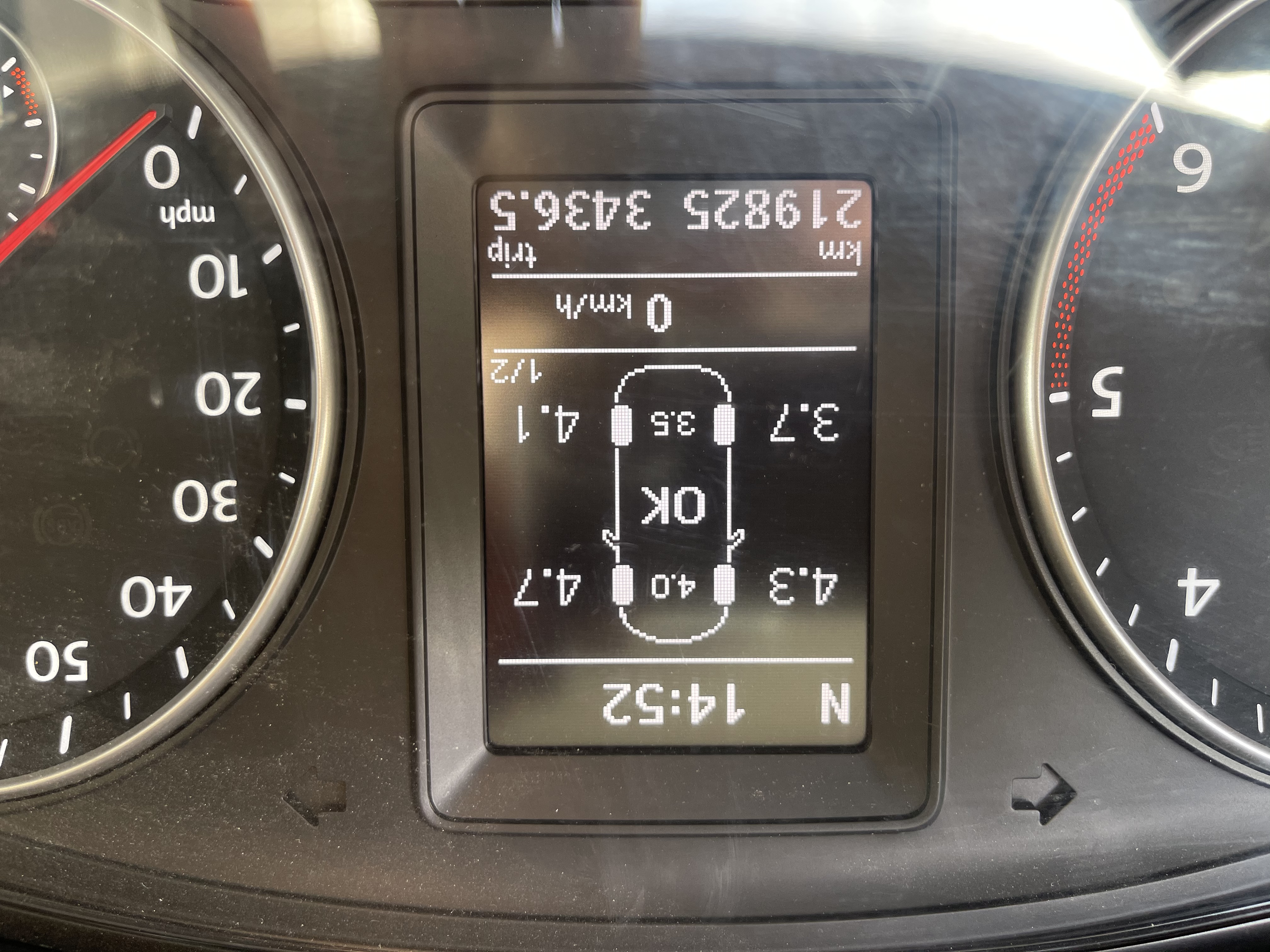

Finally
My TPMS unit was already in the middle, I did move it, but that didn’t help, so I started to play with the adaptation menu and make tests, until I found the secret 🤫
I changed the value to 1, and immediately the TP numbers had showed up

Oh good that you found the missing link and rectified it👍
This adaptation channel should have been set to 1 by default. I remember not changing any values in adaptation channels when I installed direct tpms on my Polo6R. May be due to firmware flash the value was reset to 0. Anyways good to know, thank you😊
