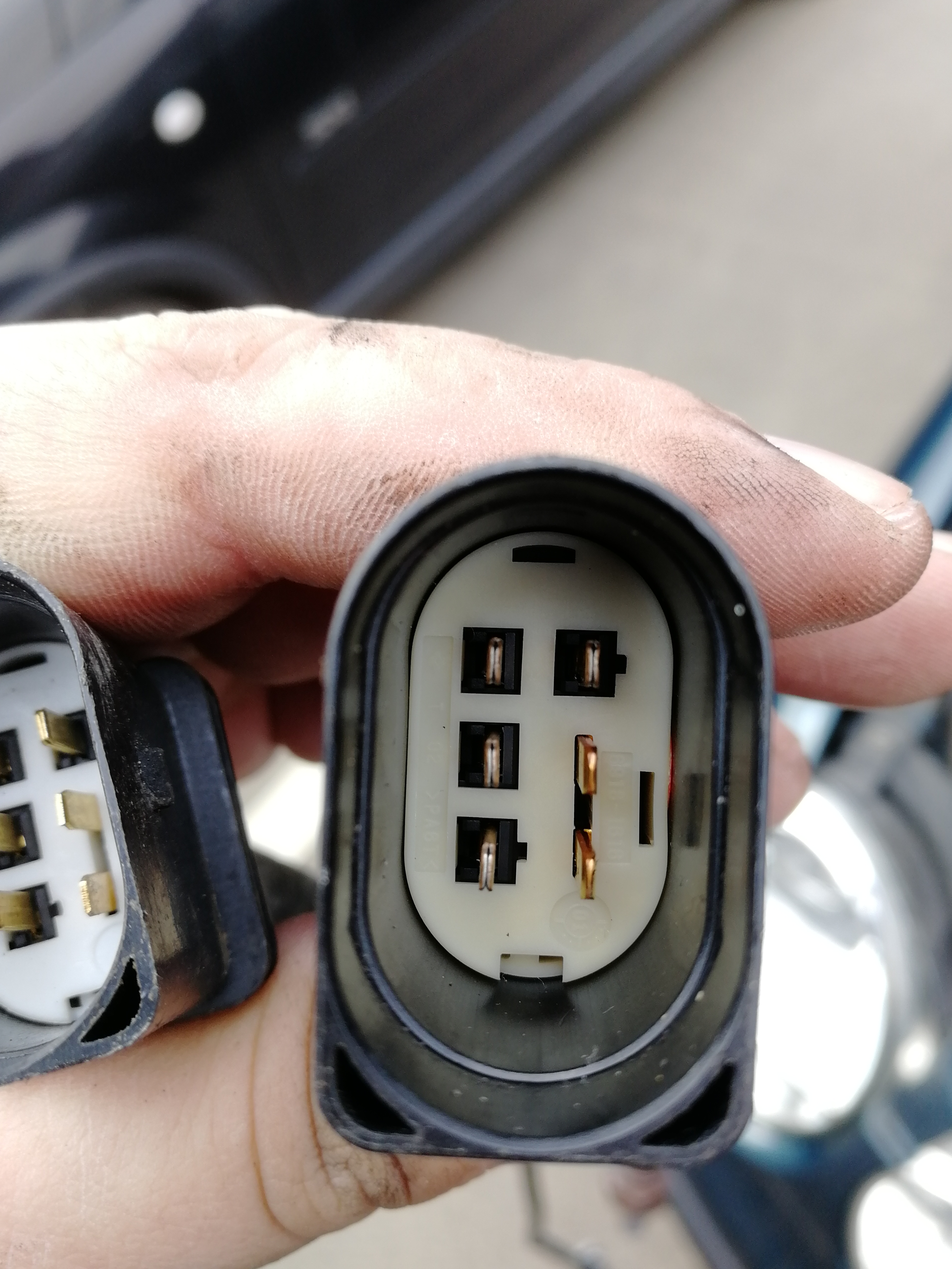

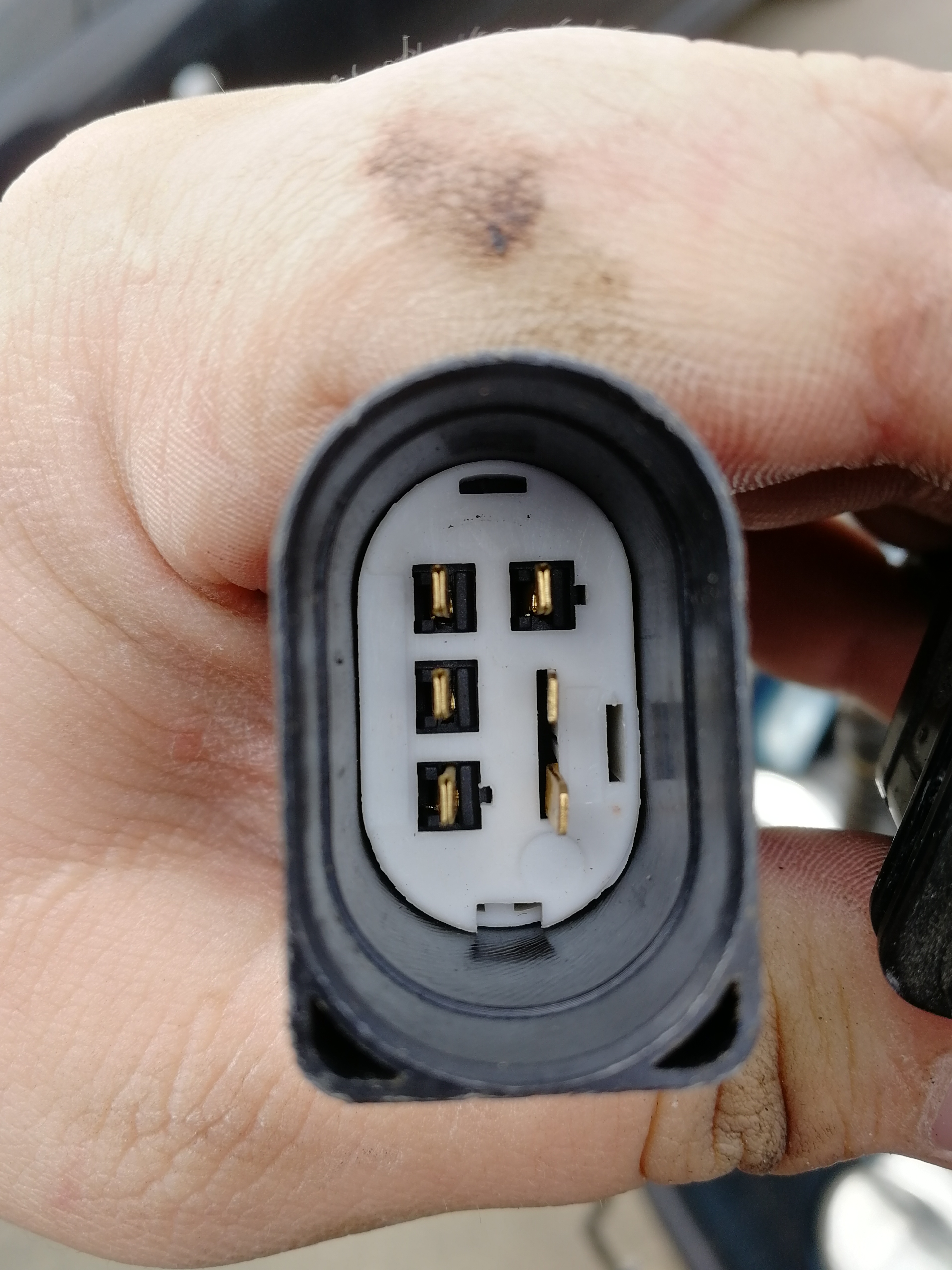

Hi there I had the codes,
p0135 (Heated oxygen sensor (HO2S) 1, bank 1, heater control circuit malfunction),
p1180 (Linear Oxygen Sensor Pump Current Short To Positive)
so I replaced the sensor with a new one cleared faults with a basic obd2 tool and now getting
p1178, p1178p, ( Heated oxy sensor 1 bank 1 heater current open circuit)
P0030, (Heated oxygen sensor (HO2S) 1, bank 1, heater control -circuit malfunction)
P0135 ( Heated oxygen sensor (HO2S) 1, bank 1, heater control circuit malfunction)
After looking online it could be a break in the female connector wire does anybody have any idea where this plug goes to so I can check continuity. Thank you in advance
Polo 9n. 1.4 bby 2002 auto
1.4 16v bby. Wire for pre cat exhaust sensor

Have you plugged back in the original S1 B1 sensor to, see if it gives the same result and to have a look at the connector pins for being bent/damaged?
Also, have you fitted a genuine replacement which would be VW part or same NTK sensor?

Re: 1.4 16v bby. Wire for pre cat exhaust sensor
I fitted an eBay matching part number but I think Chinese made. Unpluged new sensor and only getting error code p0030. 2 pins was slightly out of line but not fully bent I will post pic
Going to plug in original once exhaust cooled down.
