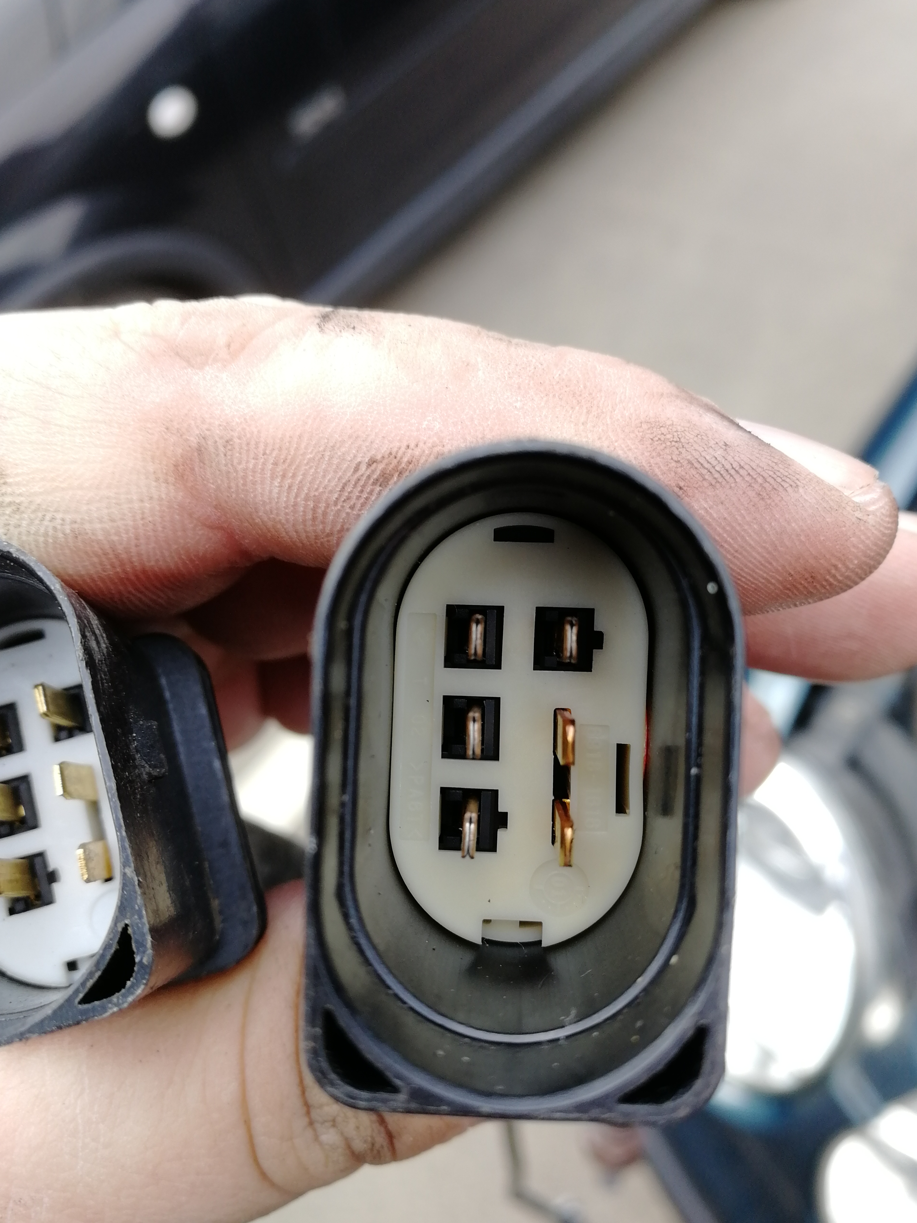

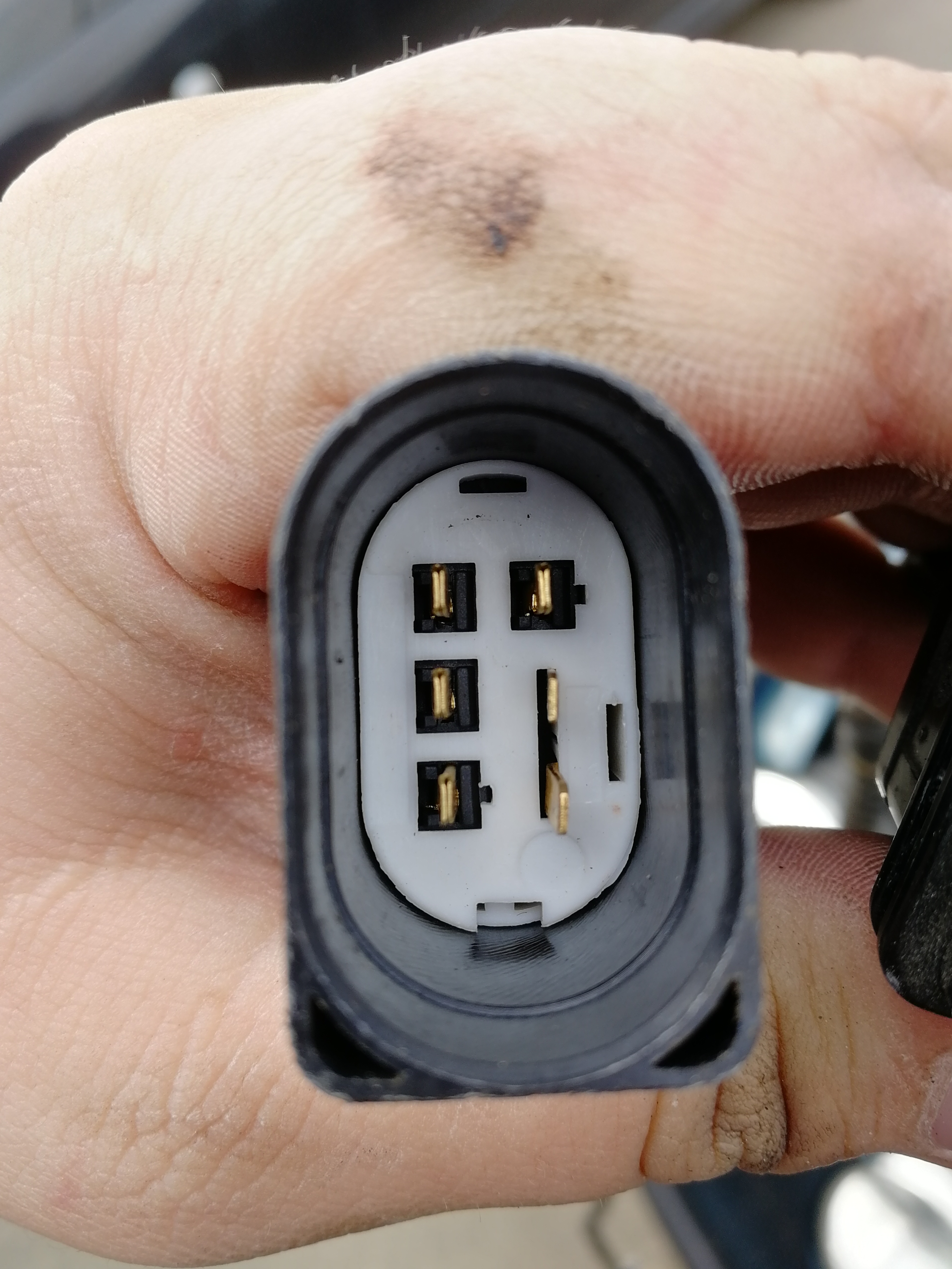

I fitted an eBay matching part number but I think Chinese made. Unpluged new sensor and only getting error code p0030. 2 pins was slightly out of line but not fully bent I will post pic
Going to plug in original once exhaust cooled down.
adam.brooks
Posts: 4
Joined: Wed Feb 27, 2019 11:16 am
Re: 1.4 16v bby. Wire for pre cat exhaust sensor
Post by adam.brooks »
Original
Original
adam.brooks
Posts: 4
New part removed
New part removed
