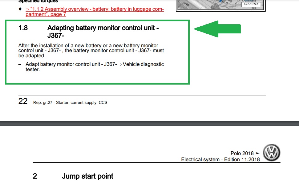

According to the "Owner's Manual" and the "Workshop Repair Manual" you need to input the new battery's details into the computer.

Extract from the Workshop Repair Manual:
And this video show you how to do it with VCDS:
[youtube]https://www.youtube.com/watch?v=IJAScg6JrYI&t=26s[/youtube]
