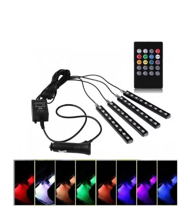

My car didn't come with footwell lights so I installed this kinda kit
I hooked up the power to the light switch so they only turn on when I have my headlights on. The state they were in last time gets saved so I don't have to set the color/brightness every time I turn them on.
I am really happy with them. I placed the signal box above the fuse compartment, under the steering wheel column so it's easily accessible for changing the colors.
I have no visible wires and everything looks as OEM as it gets(unless you poke your head under the seats and see the light strips)
