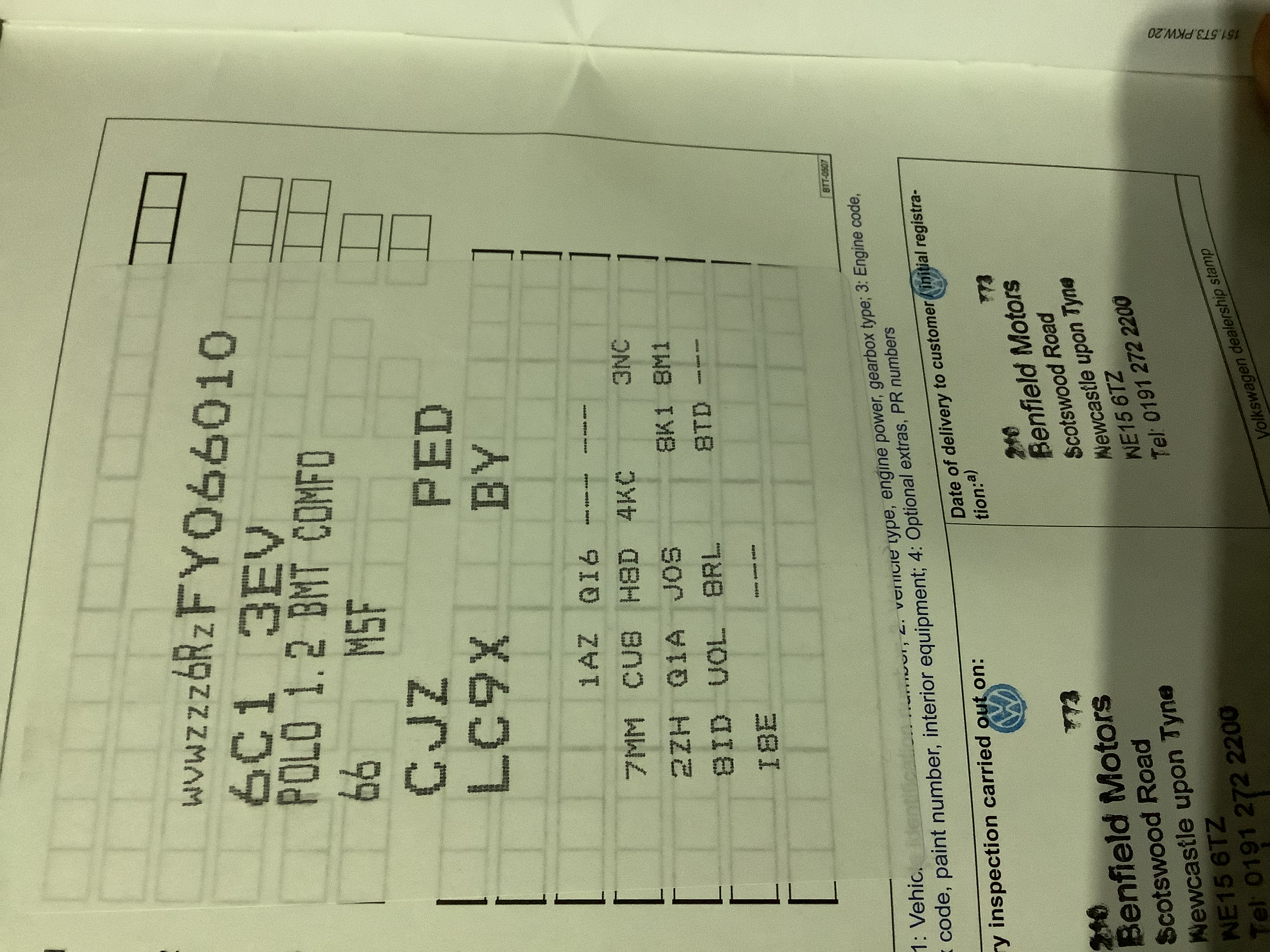

As a new owner, and member, I’m trying to find out as much information on my car as possible for future reference.
I have shown a photo of the information placed inside the service book so hoping that someone can tell me if my car has a belt or chain, my research to date is a bit misleading as some say belt whilst others equally say chain.
So my question is this,,,how can I tell for sure?
Also from that information is this car a 6R or 6C, and am I right in assuming that the engine type is a CJZ?
Lots of questions there in one post.
Many thanks
John

The CJZ engine has a belt

If you need a second answer, I agree with iichel, the full engine code will be CJZC as it is the 90PS engine.
Statements about cam belt replacement times differ:- any/most UK based VW Group dealership will when asked, recommend replacing that belt at 5 years or maybe 60,000 miles just as they recommend for all other belt driven cars with engines built after round about 20078, the official VW workshop manual will define "checking that belt" at every service after year 6 or so, ie giving it a visual over its entire length, and replacing it when it shows signs of wear or damage. Note, one of the comments made in the official workshop manual is "this belt type is fitted for life unless it shows signs of damage/wear - it is not a periodic/scheduled service part" - or words close to that.
My wife's Polo 1.2TSI 110PS is an August 2015 car, I'd think that I'll aim for getting that bely replaced round about the 7.5 year mark in its life - I have been checking it every year when I service that car, and so far so good. My logic is, as we only run maybe 6000 miles a year in average, if I get it replaced at the 7.5 year point, then keep the car until it is 12/13 years old, we will have got away with making only one cam belt change, her previous car which was a 2002 VW Polo 1.4 16V got 2 cambelt changes over its 13 years life with us.
