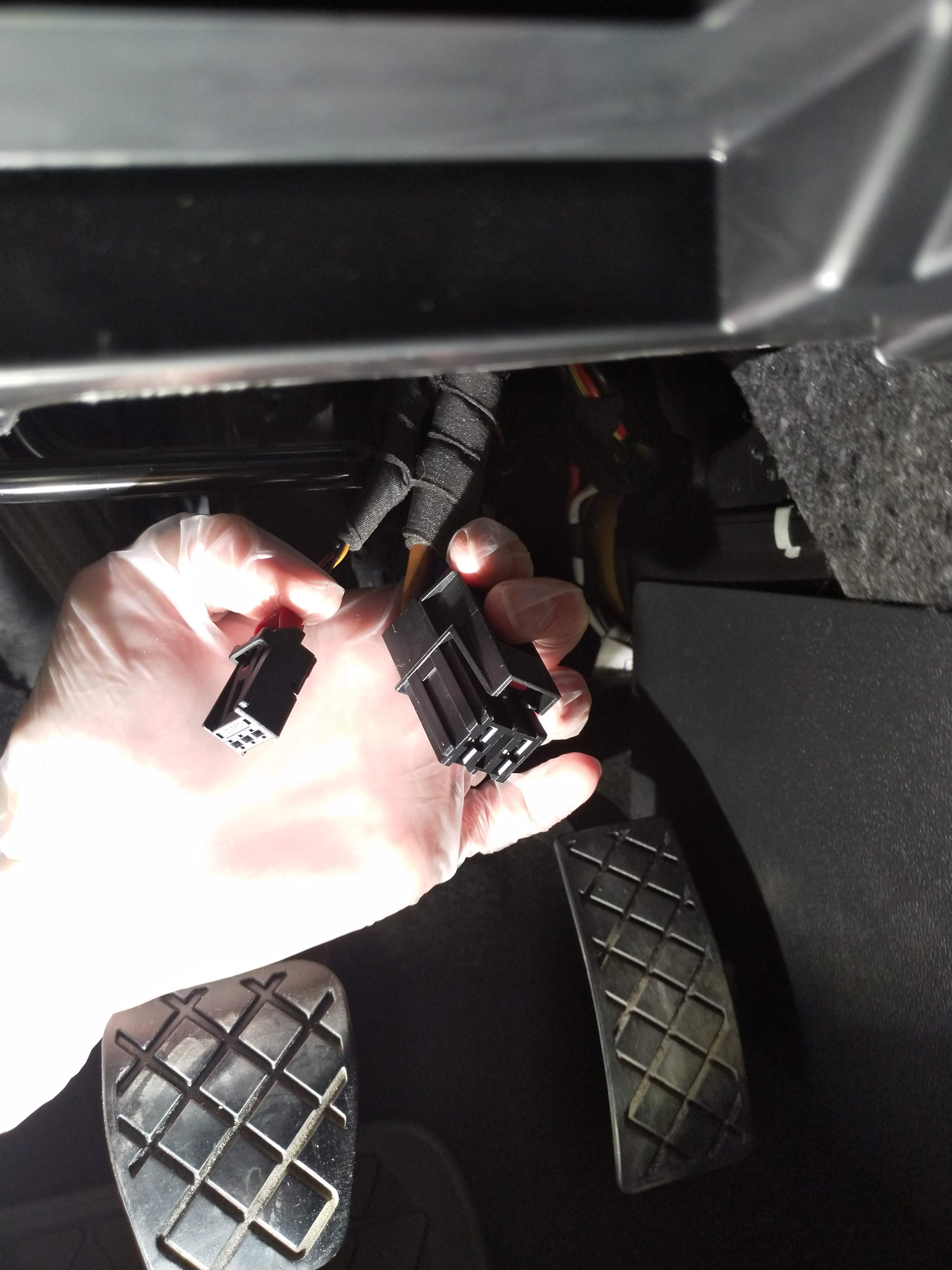

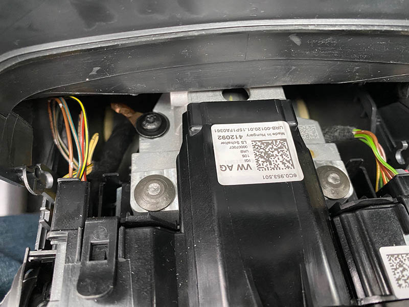

Re: Retrofit park pilote 8K OPS for polo 6C 2015 [help]
Connector A is the one with only 18 positions, that's the one you're missing. It only connects to the front sensors, everything else is in the 26-pin connector.
As for accessing the power steering module, you don't need to remove the steering wheel, just twist it 90 degrees so that the flat top aligns with the bolt that you're trying to remove. After removing the top and bottom trim pieces, try and locate the power steering connectors. You might want to remove the fuse box as well, as accessing these connectors with it in place is tricky. There are two connectors, one is for power, the other one has the CAN lines (1: CANL, 2: CANH, 3: Terminal 15).

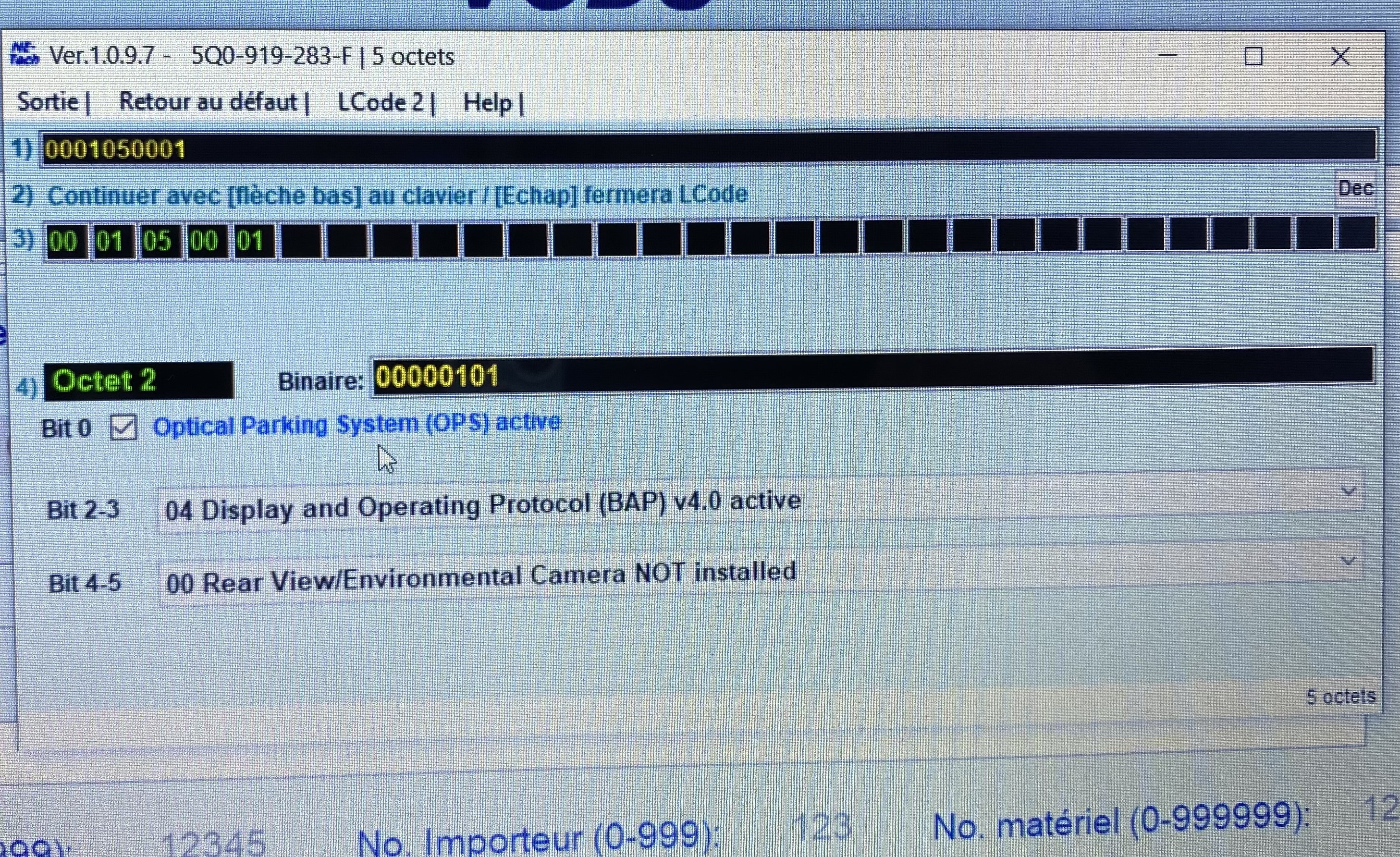

Just one other thing, and to anyone that knows better than me, I'm sorry if I'm wrong so please correct me,but, any VW Group parking controller module I have seen that has only rear sensor functionality only has one arrow printed on to it, the ones I's seen with rear and front sensor functionality has always had 2 arrows printed onto them.
But, please correct me if I'm wrong someone as I'm only trying to help this poster!
- Posts: 6695
Nowadays the 4K version is a 8K module with 4 front sensors disabledRUM4MO wrote: Wed Oct 27, 2021 9:50 am Just one other thing, and to anyone that knows better than me, I'm sorry if I'm wrong so please correct me,but, any VW Group parking controller module I have seen that has only rear sensor functionality only has one arrow printed on to it, the ones I's seen with rear and front sensor functionality has always had 2 arrows printed onto them.

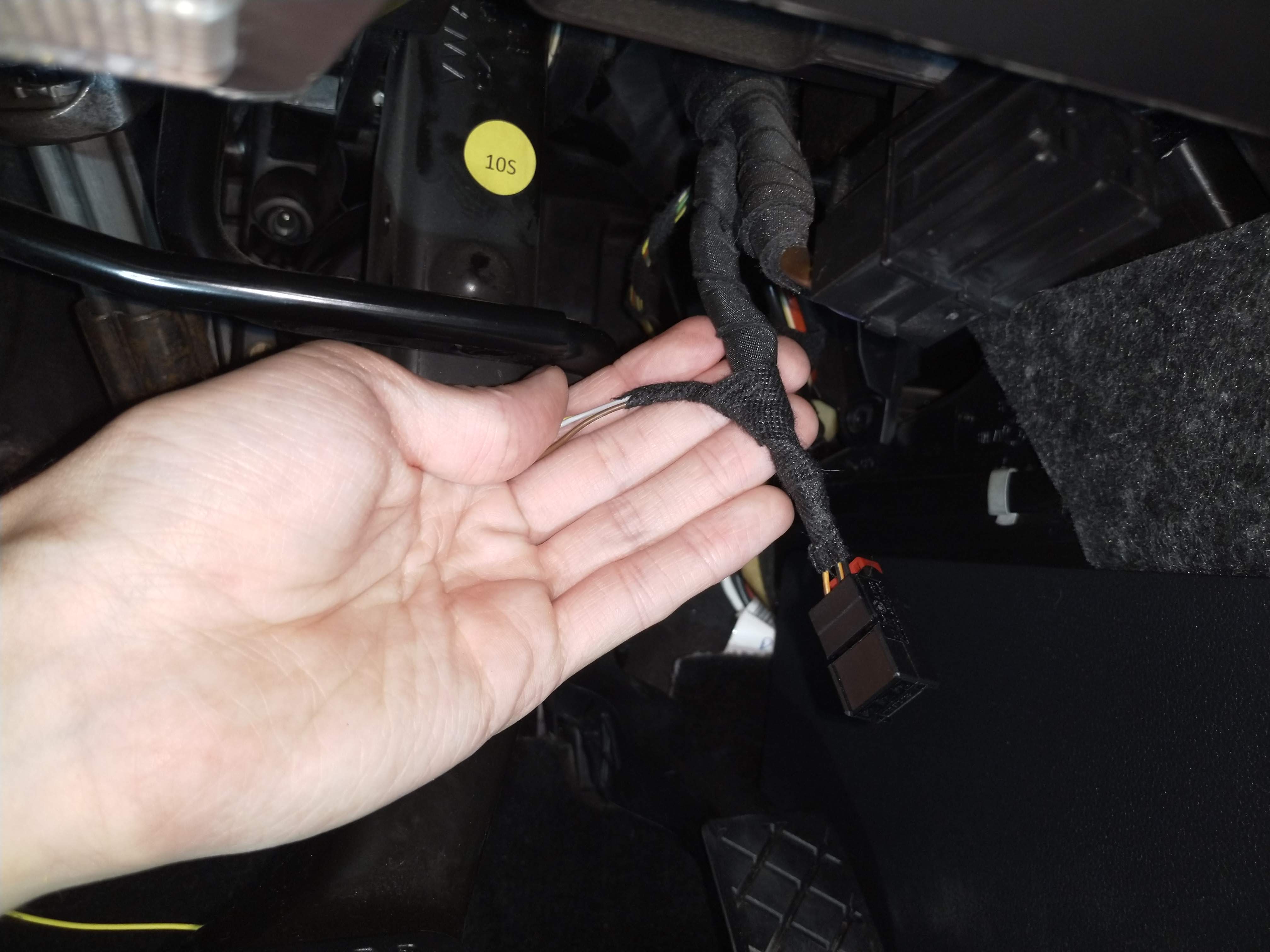

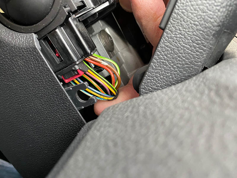

Hi, thanks for your full answerheftyshooly wrote: Wed Oct 27, 2021 9:03 am Connector A is the one with only 18 positions, that's the one you're missing. It only connects to the front sensors, everything else is in the 26-pin connector.
The missing connector, maybe, but i bought a 4k module, so i'm surprise, but if not needed it's ok for me.
For the steering wheel, yes ! true ! i can access now to the bolts.
i'm going to have a look to this connector, i take picture from upper before removing bottom piece, can h/l are not present in theses connector right ?
For the color, it's orange/green and orange/brown ?
Thanks !
- up.jpg (108.05 KiB) Viewed 3321 times
- 2.jpg (116.52 KiB) Viewed 3321 times
- 1.jpg (149.66 KiB) Viewed 3321 times

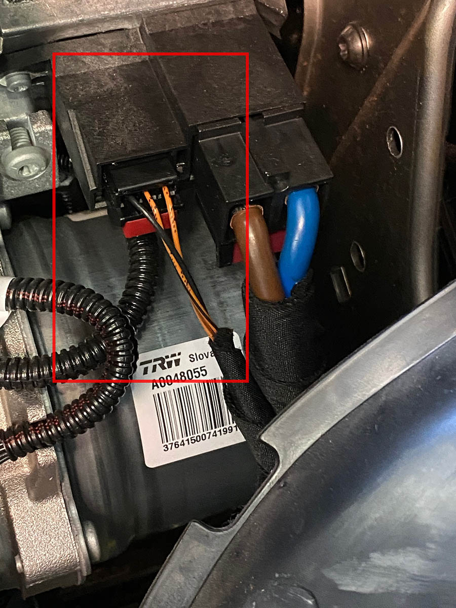

......... the other one has the CAN lines (1: CANL, 2: CANH, 3: Terminal 15).
In my picture can you tell me where is can bus H and low under steering wheel .
Thanks !!!!!
- canbus.jpg (220.12 KiB) Viewed 3309 times
- Posts: 6695
you need to dig further towards the engine
Yes ! i see
- Posts: 6695
orange/black is high
orange/brown is low
orange/brown is low

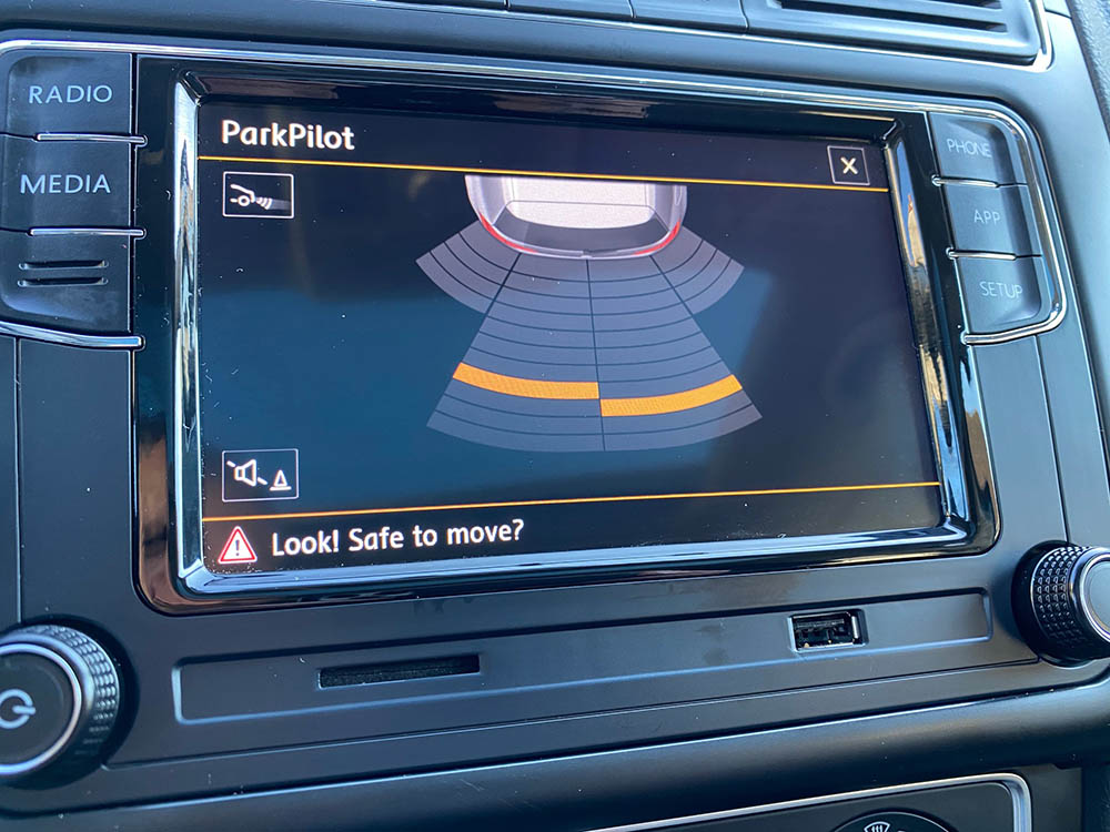

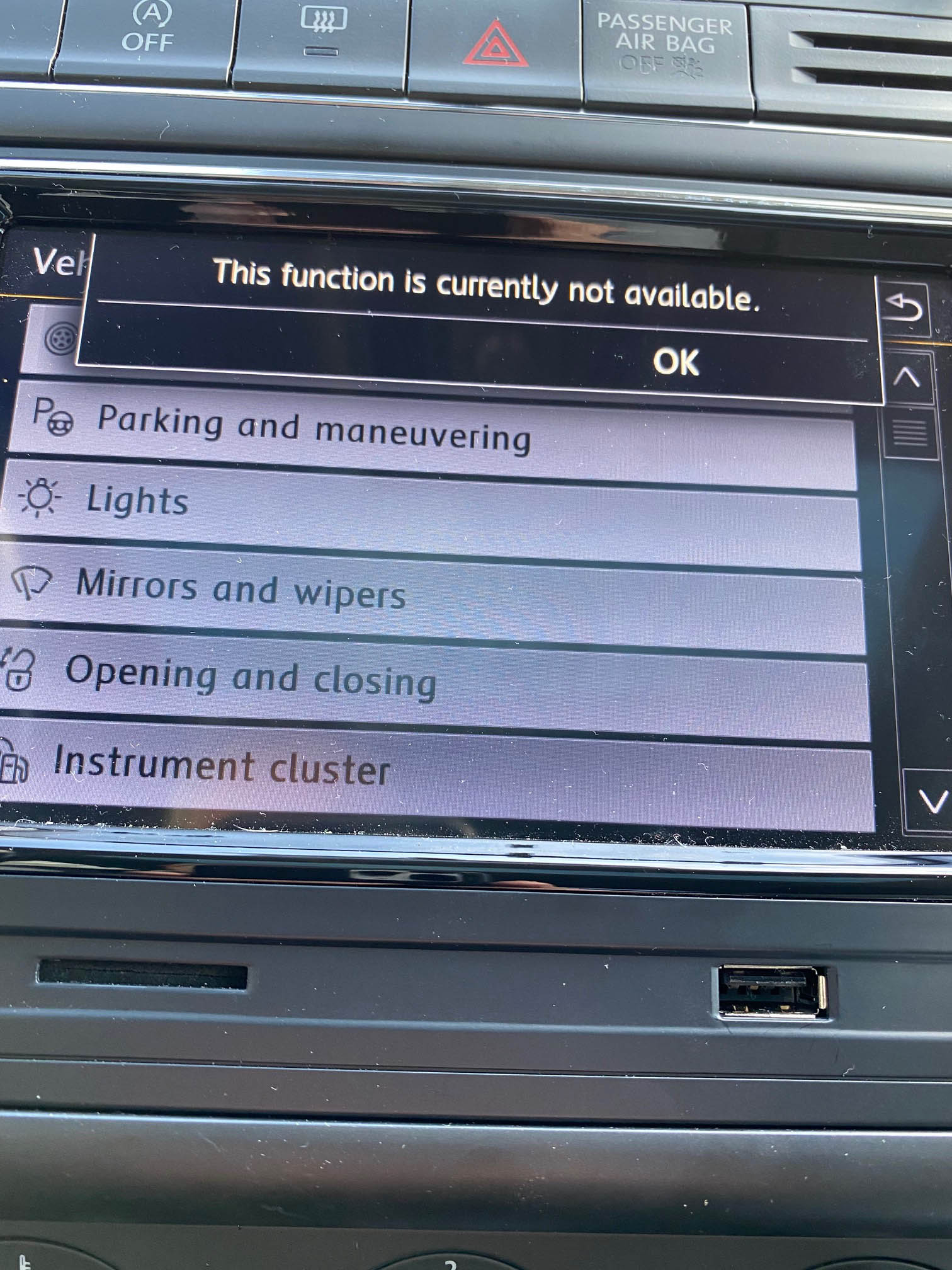

I change my wire can high & low, so now i've got park assist sound and detection Ok.
But no ops on my radio, the menu parking is always not available
In log with vcds i'ge got many errors,
I don't think i've got multiple mount, only 12v and ground are same for park module and rear camera (china reverse model)
i remove all coding for park module, because doesn't work on my radio (china model special polo 6c) and crash my reverse logo camera (doesn't show anymore)
Any idea ? i really don't know where to search now

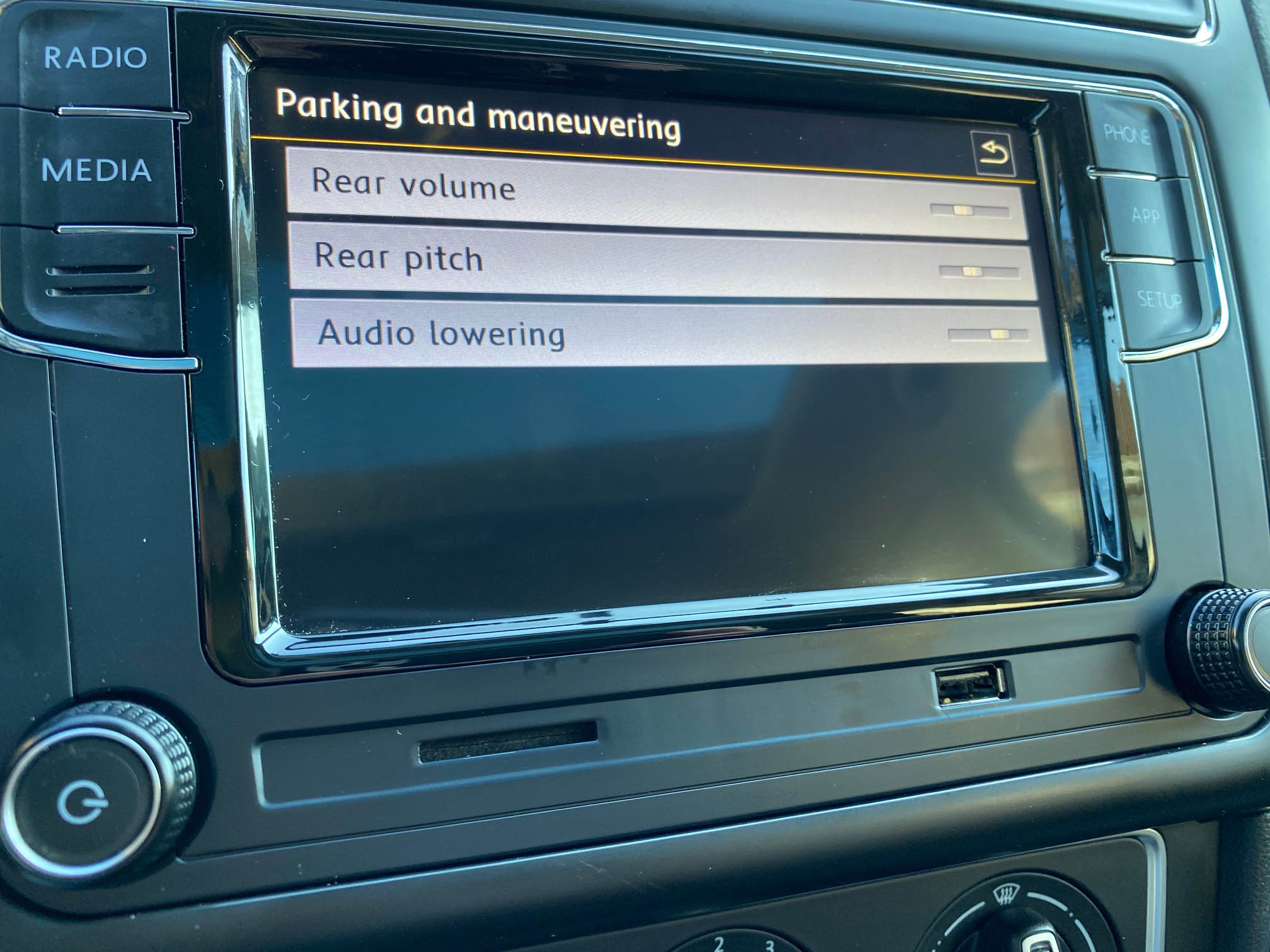

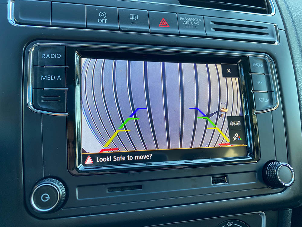

Finally it works !
I don't have in same time cam & park assist, it's impossible with my unit.
Thanks to all for your support !
I've got errors in log, but working like that.. So i don't touch anymore. Next step, changing language to French for this Ali 330 6C unit.

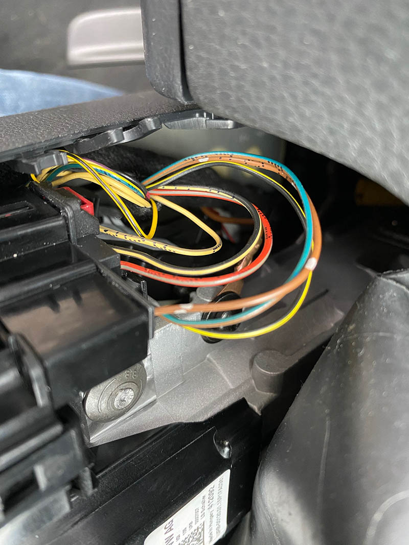

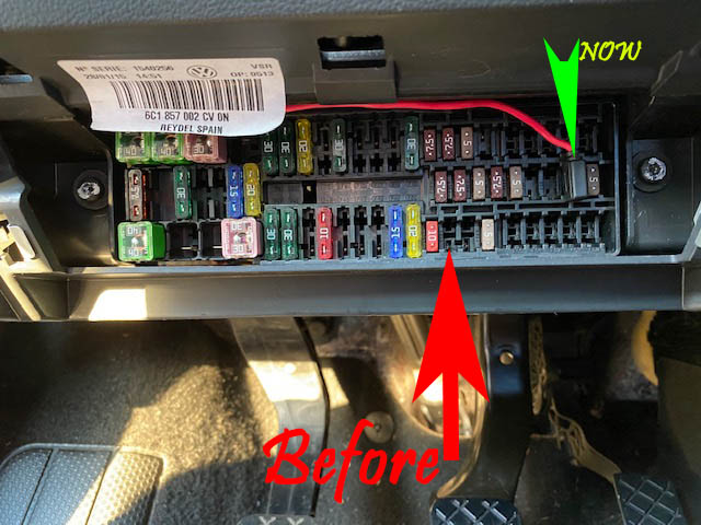

Bad surprise this morning, no battery
I think it comes from my wrong +12v after ignition (for park-assist and rear camera)
i found maybe a +12v after ignition on my photo, i'm good ? or i must connect on another place ?
Thanks !
Thanks !
- battery.jpg (91.39 KiB) Viewed 3175 times
- Posts: 6695
i suppose the easiest way to check this, is with a multimeter
i've got 0.0400 after ignition off, not 0v, could be ok ?
