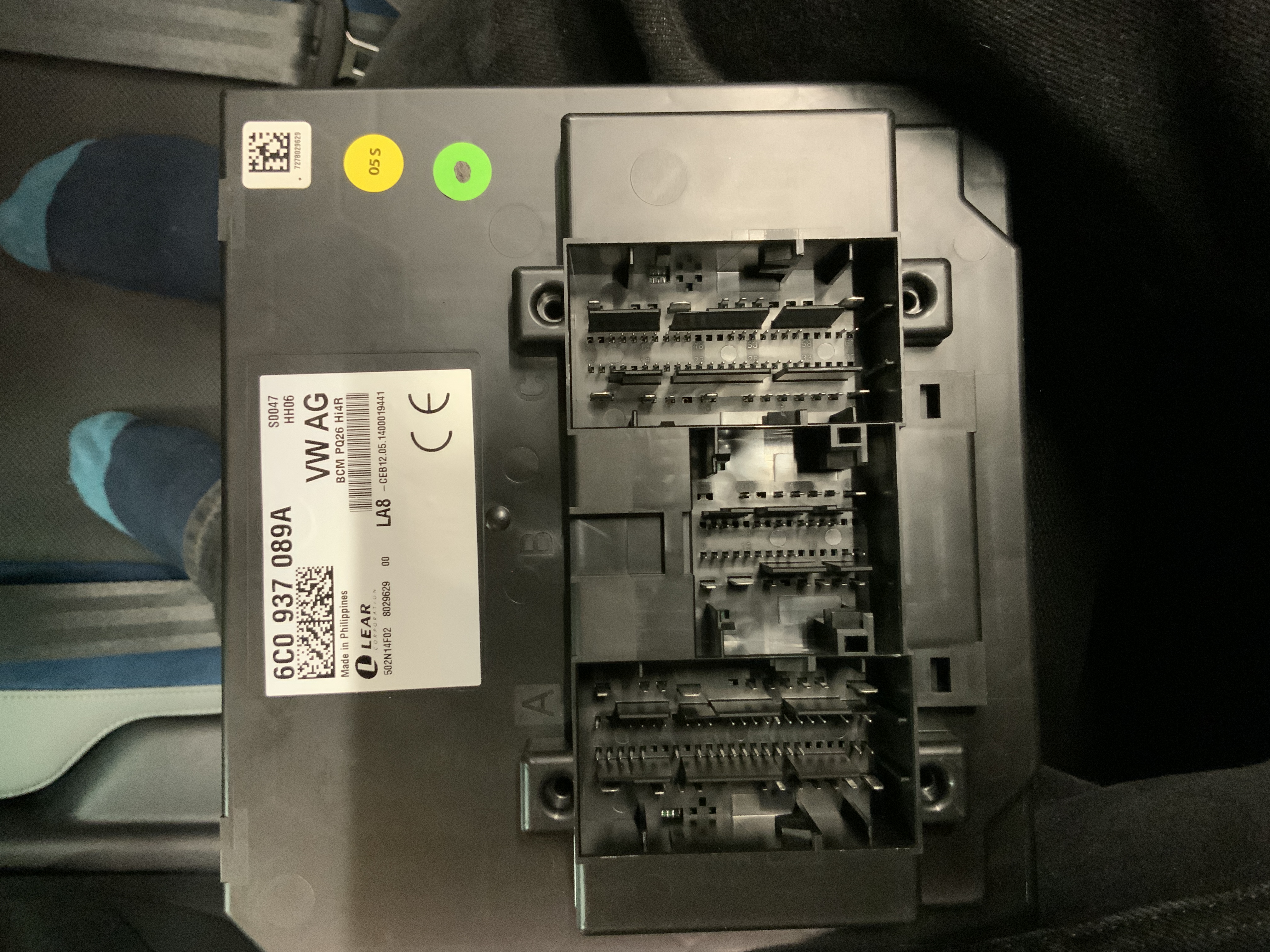

For info this is my BCM in a 64 plate SEL

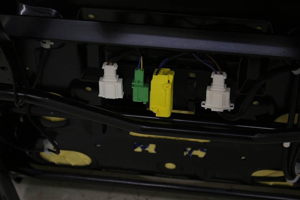

Sorry for re-igniting this post could someone tell me what these plugs are. I’m guessing the yellow is airbag, Green seat sensor for seatbelt warning? But what are the 2 white ones. Are they both for the heated seat. If so which is the Base and which is the Backrest. If looking from the front of the seat. My heated seat has packed up so I’m looking for help on how to determine which pad has failed. If I turn the seat heat on with 2 lights it shuts down after around 30 seconds. If I turn them on with one light it stays on. HEEEEEEeeeelp
