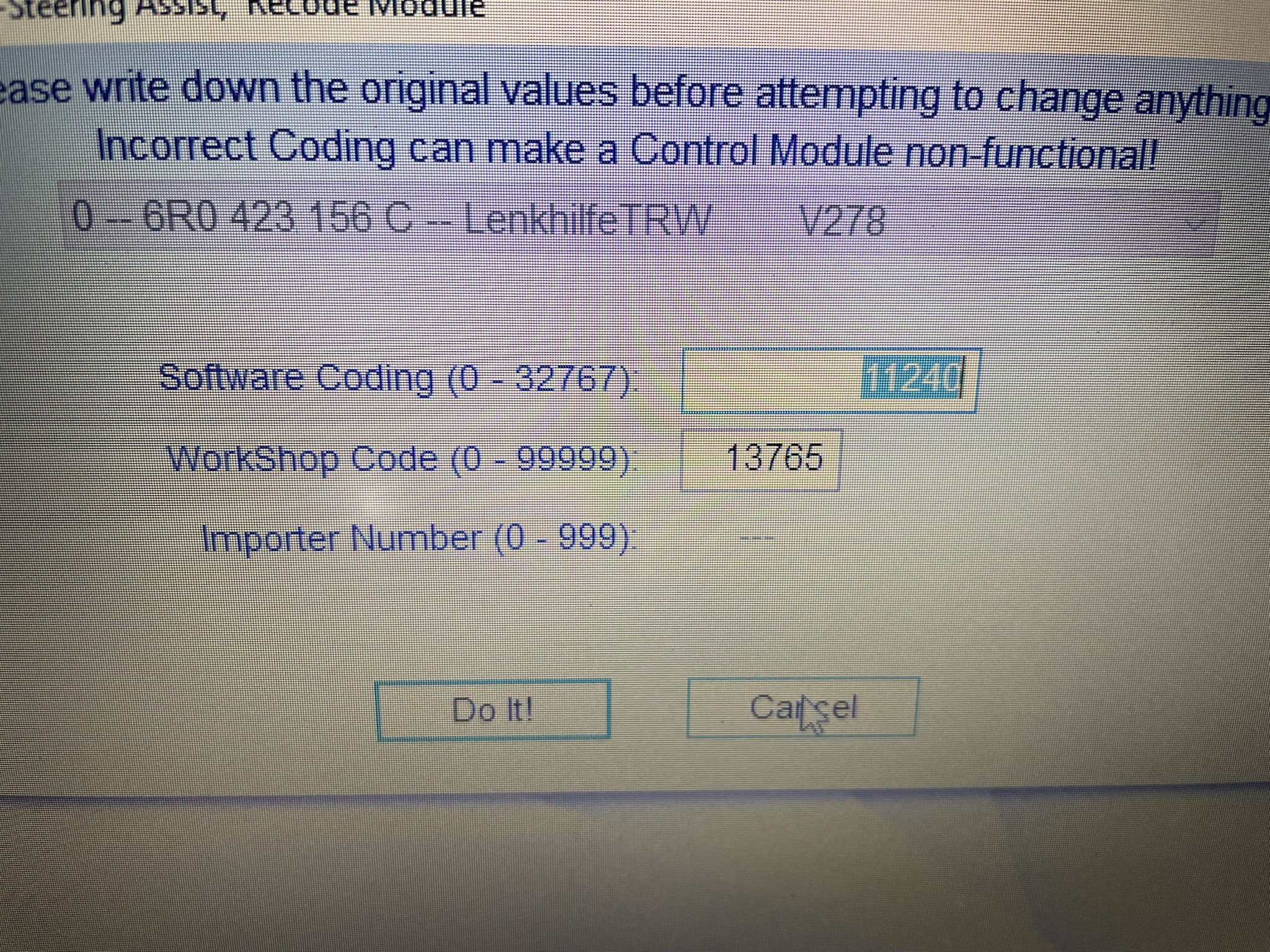

For some reason the steering is set on the lightest setting, i just want to change it to the proper setting as its a bit too light for my liking

It needs security login to change the coding, there is no long coding available so i need to change it via normal coding

thats power steering pump? Ypu dont need security acess pin to change the coding. just add the numbers
Re: Channel 44 vcds
So you can change the coding, right? It's the upper box.

I can change it but as soon as i press do it it reverts back to these values
Re: Channel 44 vcds
are you sure that you are subtracting and adding the numbers correctly?

Tried everything, never come across this and ive had vcds for years

go in options, test, make sure it says can ok and press apply then go and change the numbers.
