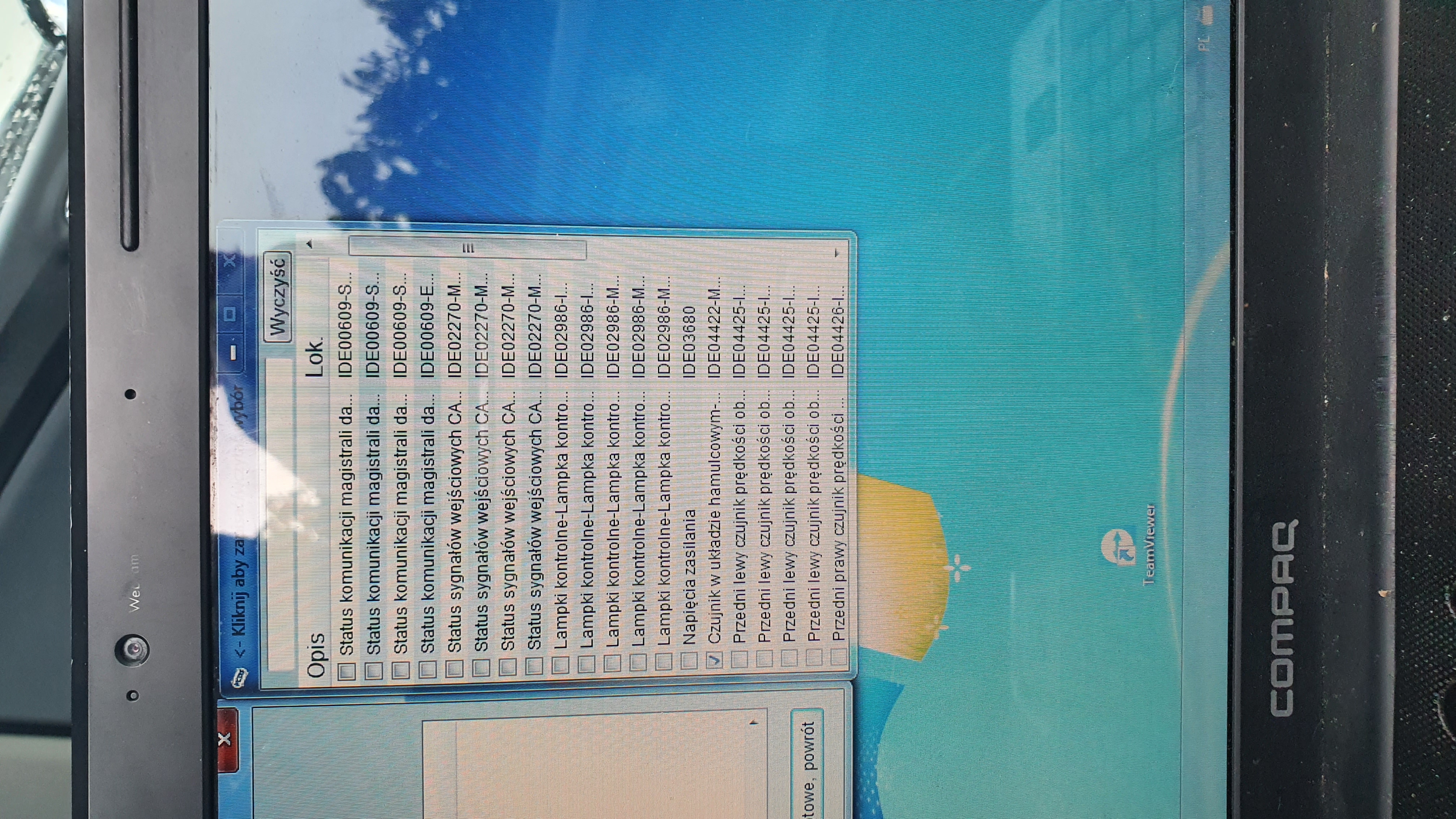

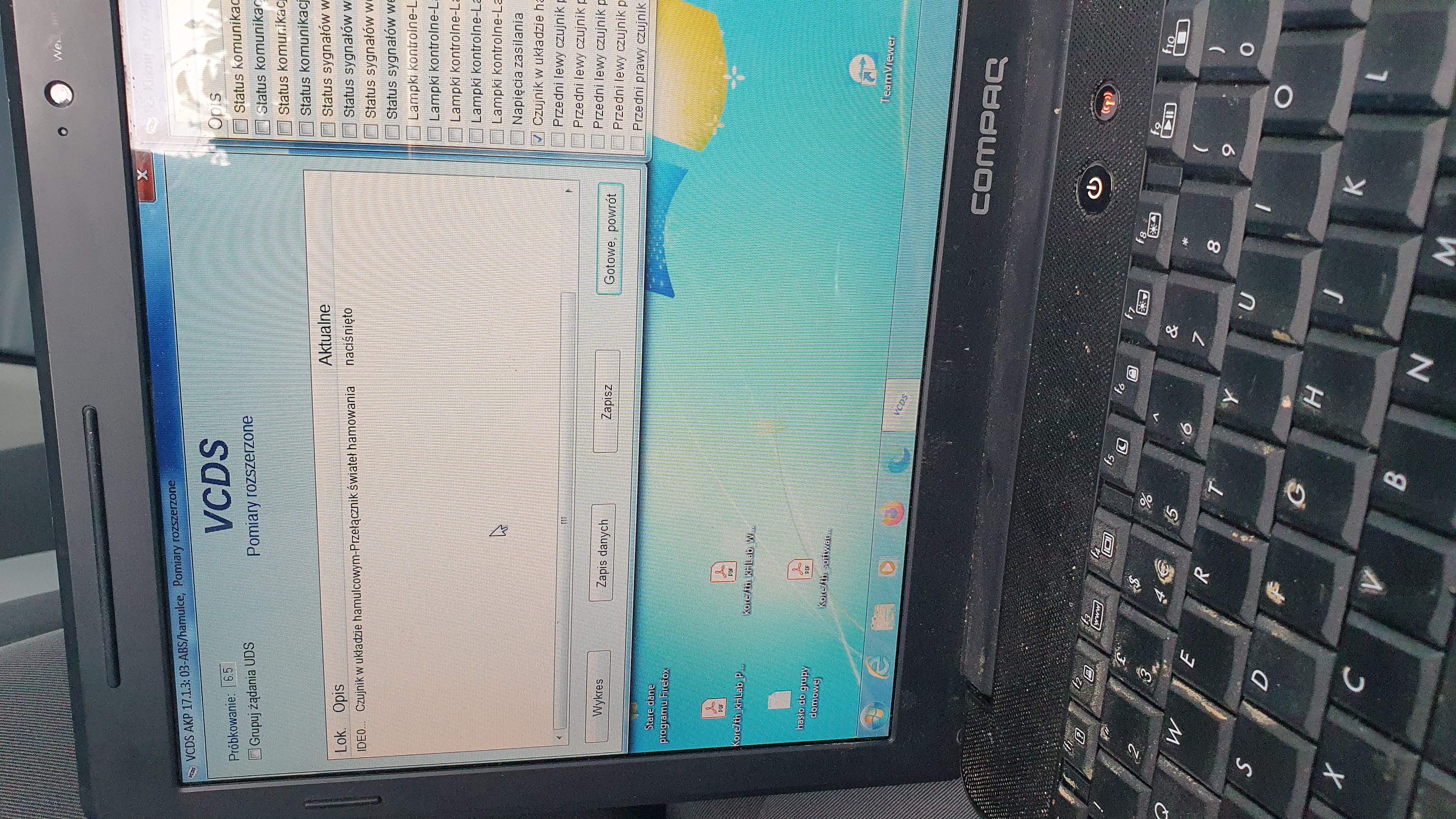

I went to check it again with Vagcom. There was not brake light sensor in BCM module in advanced measurement.
I found sensor in braking system in module ABA/ Brake.
I went to advanced measurements and found sensor in breaking system. I choosen/ticked it from the list and got information about it on screen. The first status was unpushed. When I pushed brake pedal , it changed to pushed status.

- Sorry but I have vagcom in Polish only
- 20220108_153250.jpg (4.71 MiB) Viewed 33788 times
- 20220108_153220.jpg (3.4 MiB) Viewed 33788 times
- Posts: 6693
Re: Brake light sensor issue
could you please translate what it means?

Yes. First position:
Sensor in braking system unpushed
When I push brake pedal:
Sensor in braking system pushed.
When I push brake pedal , status is changing to 'pushed'
- Posts: 6693
That's likely the pressure sensor in the braking system. Not the electric brake light switch.
