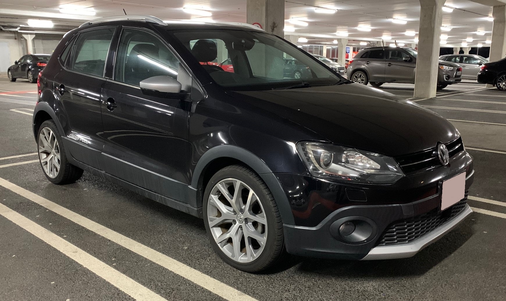

Hi all,

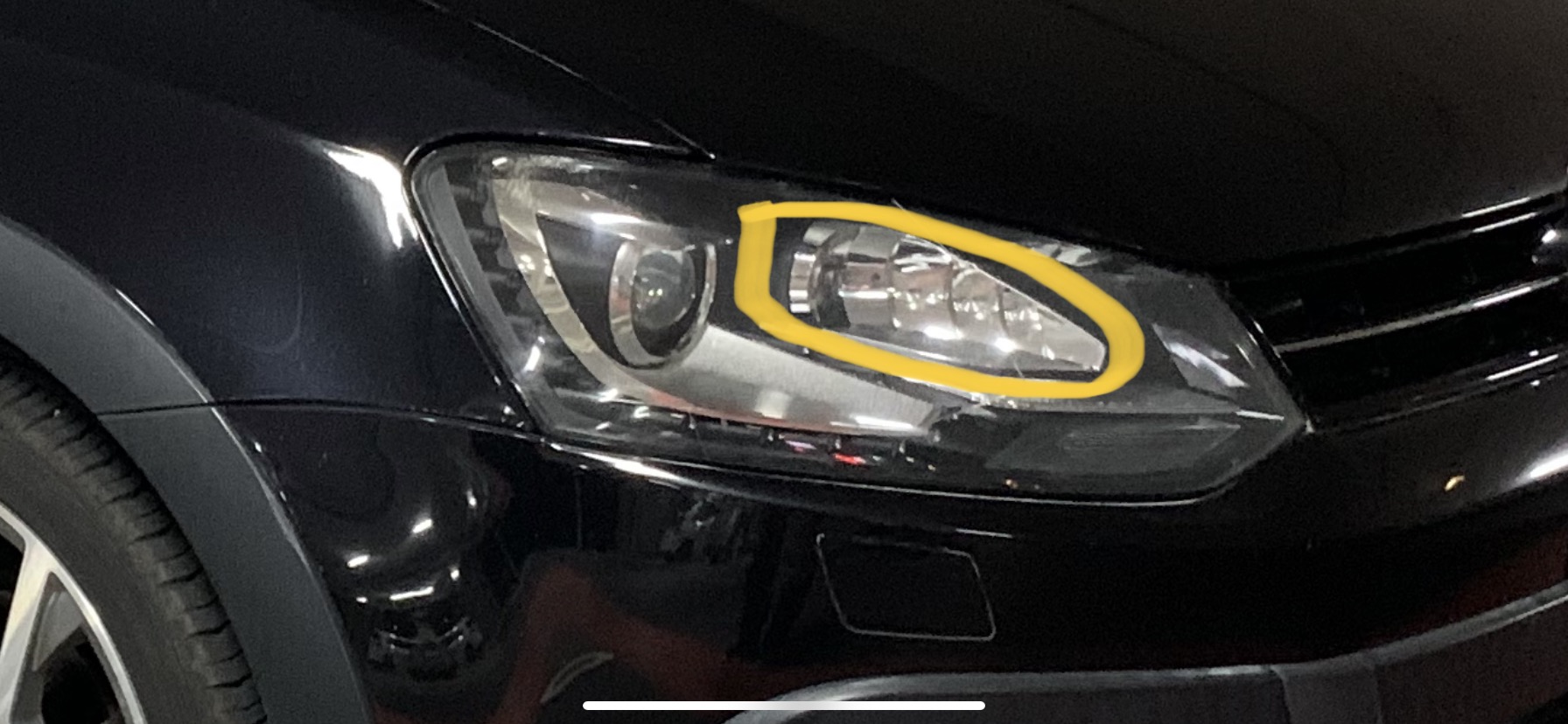

I picked up this 2015 6C 1.2 TSI Polo Cross for a family member, and have been slowly fettling it. I was getting it ready for its annual inspection, and I noticed one of the lamps (highlighted in the second pic) didn't do anything on either side, despite having a fairly hefty bulb installed. Thinking about it afterwards, there are no DRLs, which I would expect on a 2015 car. Are these meant to be DRLs? I activated DRLs using VCDS, and they didn't light up. Any ideas? It's a pretty big piece of headlamp real estate not to do anything :D I've searched both here and more widely online, and the OE xenons seem to be rare enough, so not much info.

Those lights are Static cornering lights(SCL).

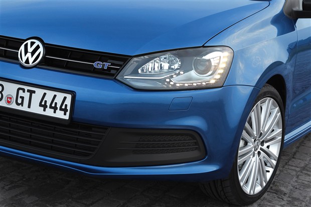

As @CarbonChaos suggested in the previous post, the DRL’s in the OEM bi-xenon headlamps are located down the outer side - and along bottom outer section - of the headlamp unit. I’ve marked the location in red on the picture below;
And you can see the DRL’s illuminated on the Polo Blue GT in the picture below;
