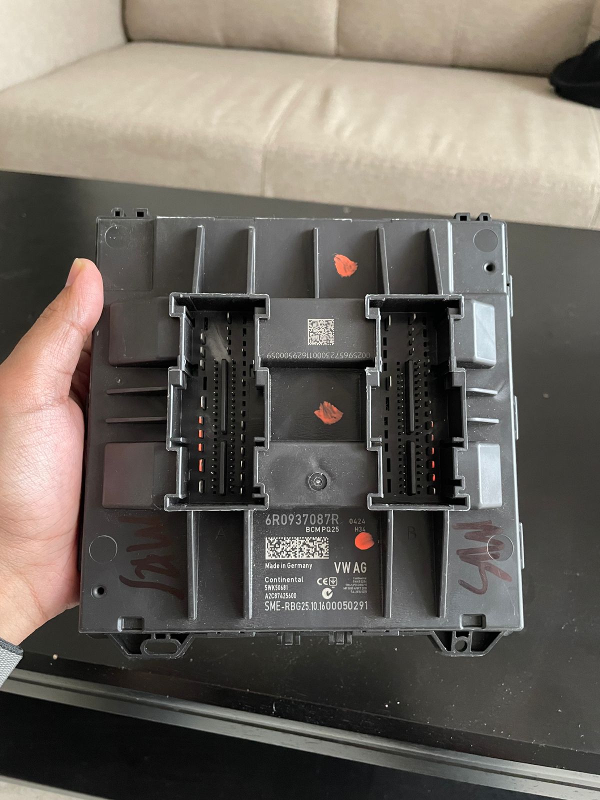

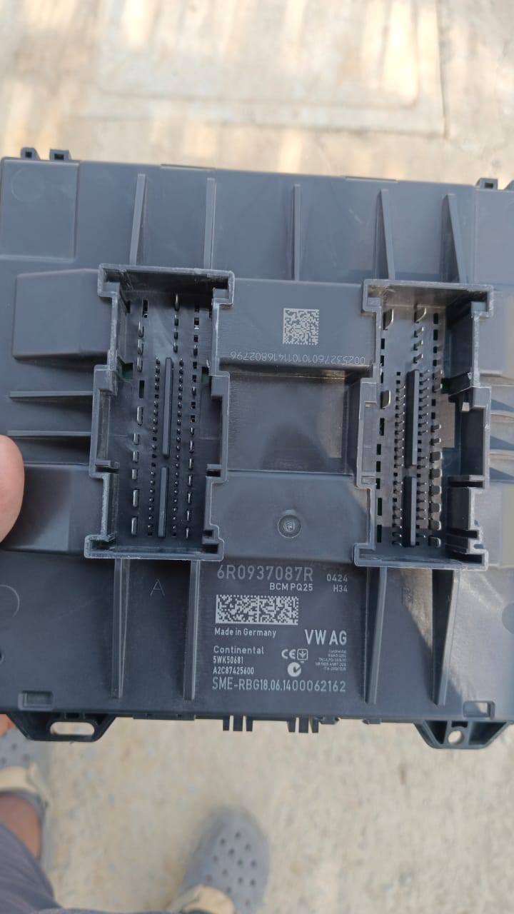

Yes it also says PQ25 on the BCM. I just need to know how to program this thing. Do you know if I can do it with this generic VCDS Cable and VCDS software?
https://www.amazon.in/Diagnostic-Cable- ... 1235&psc=1
old (original)
old (original)
new (used) to be programmed
new (used) to be programmed.jpeg (208.65 KiB) Viewed 20944 times

Car should start even you use brand new bcm.
Then focus on coding, errors etc
