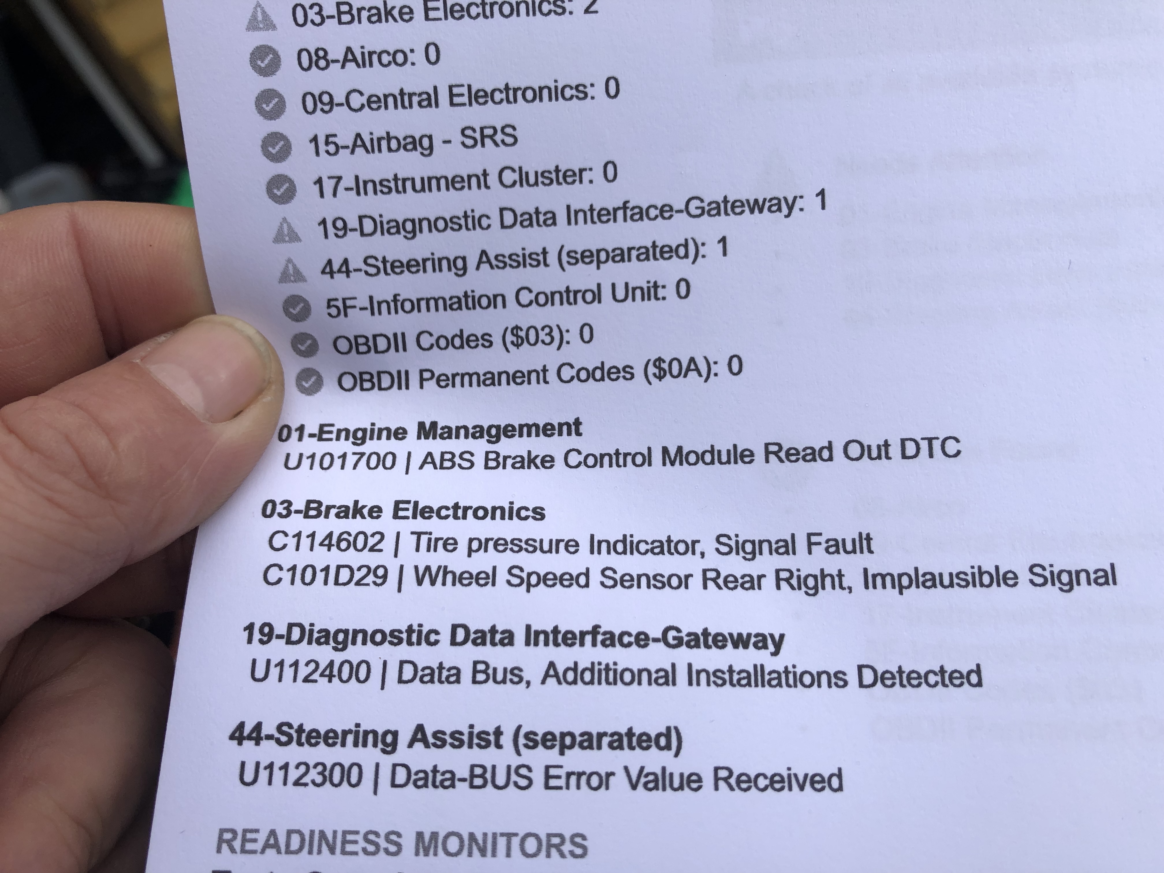

Hi everyone, I have fault codes
U101700, c114602, c101d29, u112400, u112300.
I have replaced a rear wheel sensor and rear brake shoes can anyone help point me in the right direction with my daughters car it is a vw polo 2015, 1.0 blue motion.

In what modules do you read these code? A longer description of the code would be good since these codes are very generic.

Is this what you are after ?
Re: Abs fault, I really need some help please
yes. so it might be worthwhile to check the cable that goes to the abs sensor and check for any damage.
