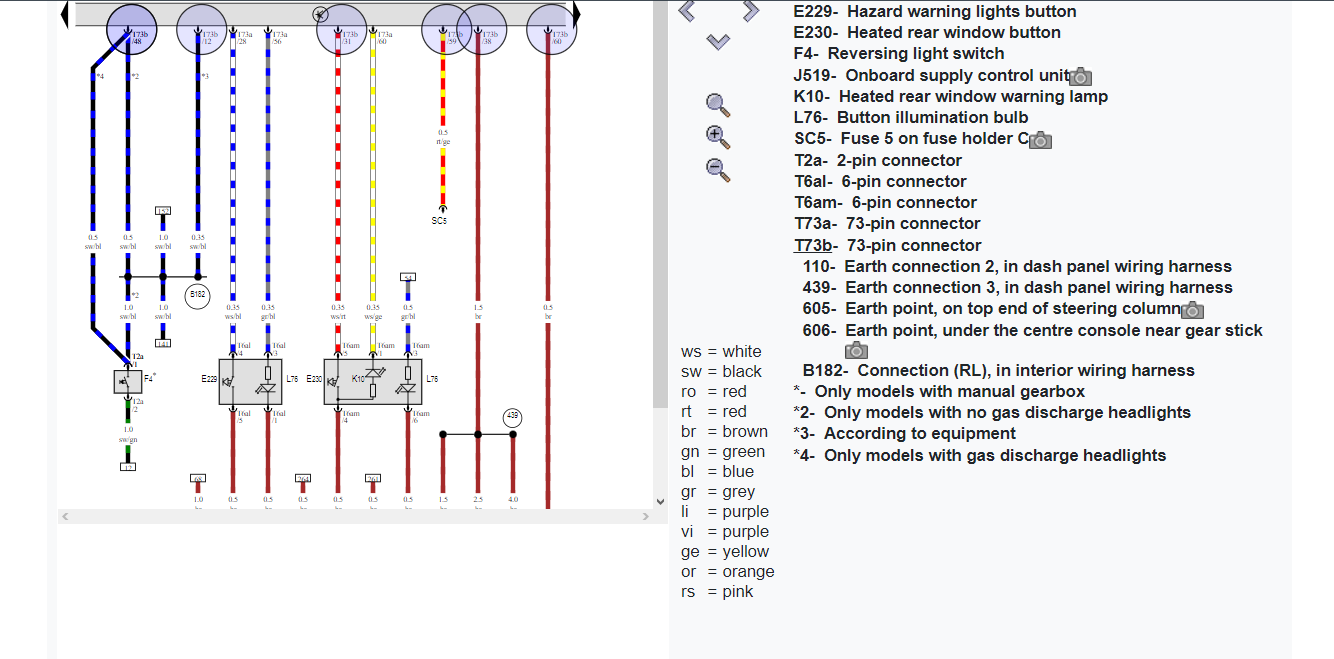

Re: Heated mirrors and heated rear screen
The long coding part is good, no one disabled it.
Id give that loom a look.
so fuse 24 is new
and fuse 53 new
There is a earth connection point on left C pillar for the rear boot lid electronics

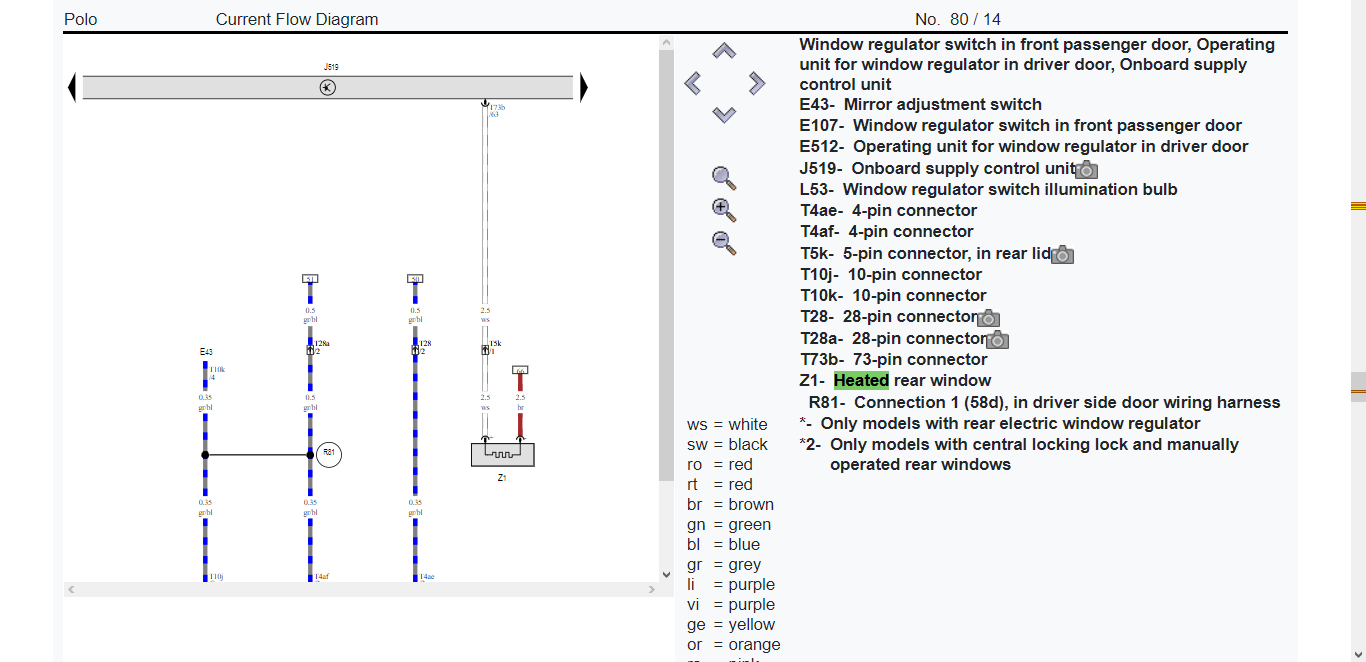

I’m at a loss, I’ve checked the loom to the tailgate and it’s fine, no broken wires. Changed the fuses again just in case and still nothing. It’s all very strange
All other tailgate electrics are working fine
