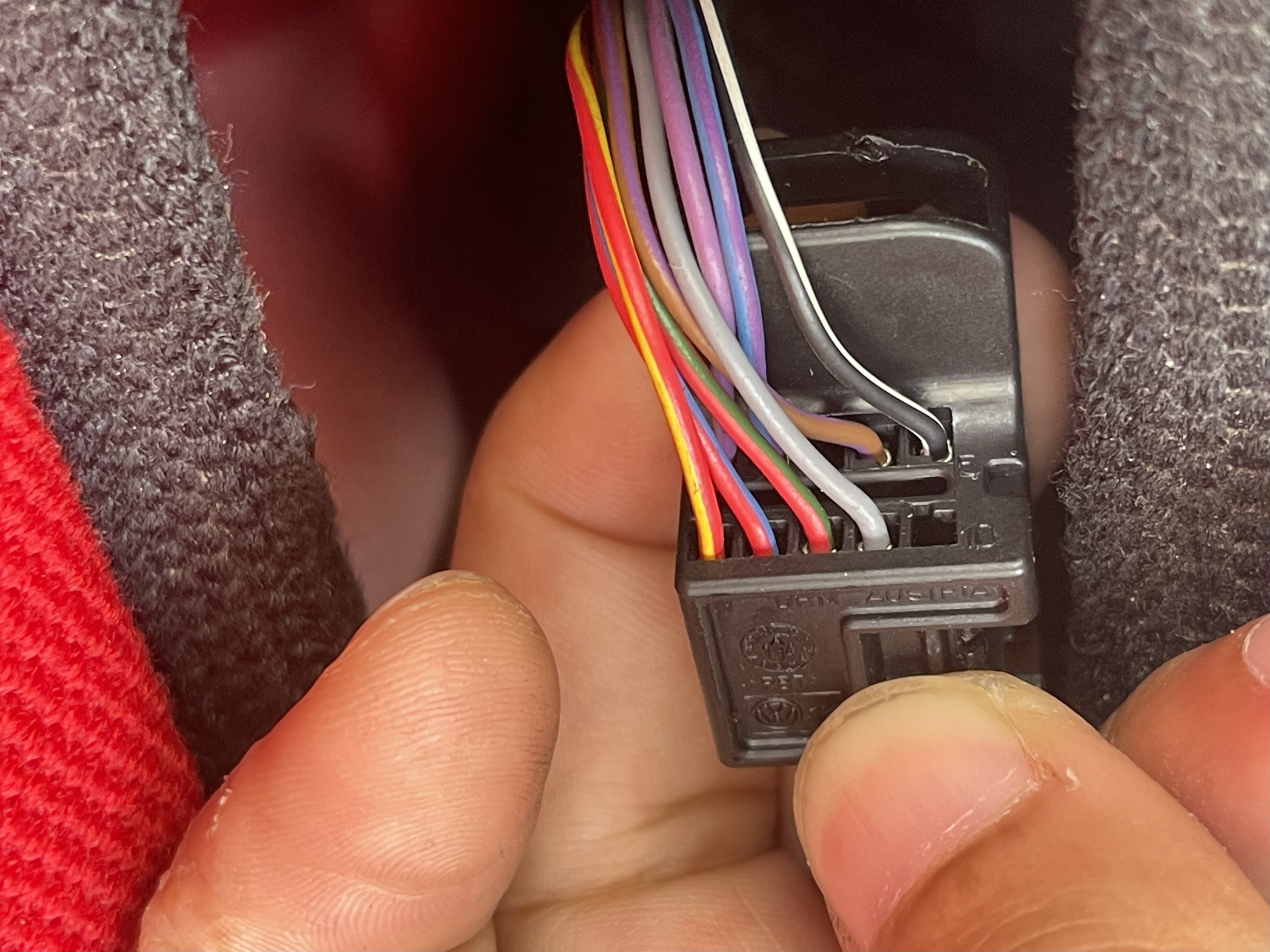

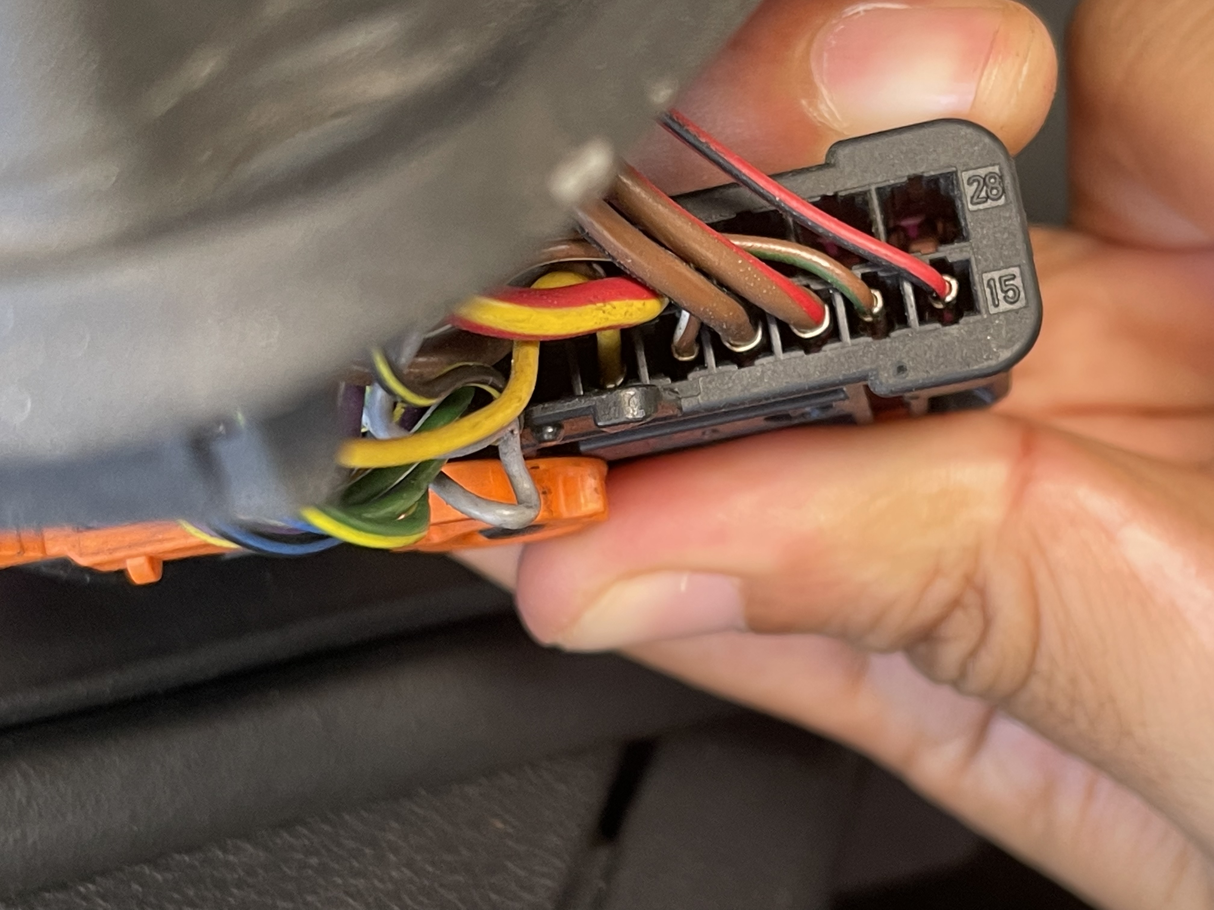

Hi all. Appreciate it if someone kind enough to share some detail pictures of a RHD polo driver right front door connector T28 and T28a. If possible,showing all wires from each pin out.
I am doing a rewiring for a suspected botch job

What i mean is, pictures like this, for me to compare

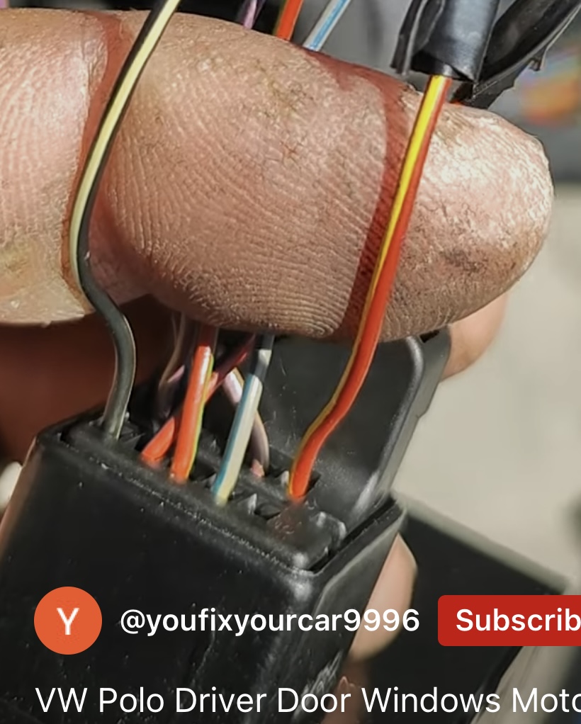

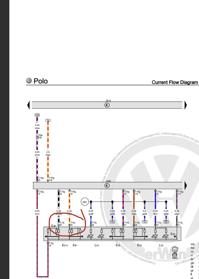

Just to update, i found out what is wrong.the wiring in the window switch’s connector was tampered with. Front window Left(t10j/6) and right (t10j/5) switch wire were swapped. Comparing mine with online pictures has help me as WD is confusing(both left and right labelled as t10j/5 )
I swapped them back and now they are working as it should.
Original wiring
My botched wiring
Confusing label

Well done!!🥇👌 Study and meditation help us improve. :lol:
It is not the first time in this and other forums that we have found 'printing errors' :mrgreen: in the W diagrams...
