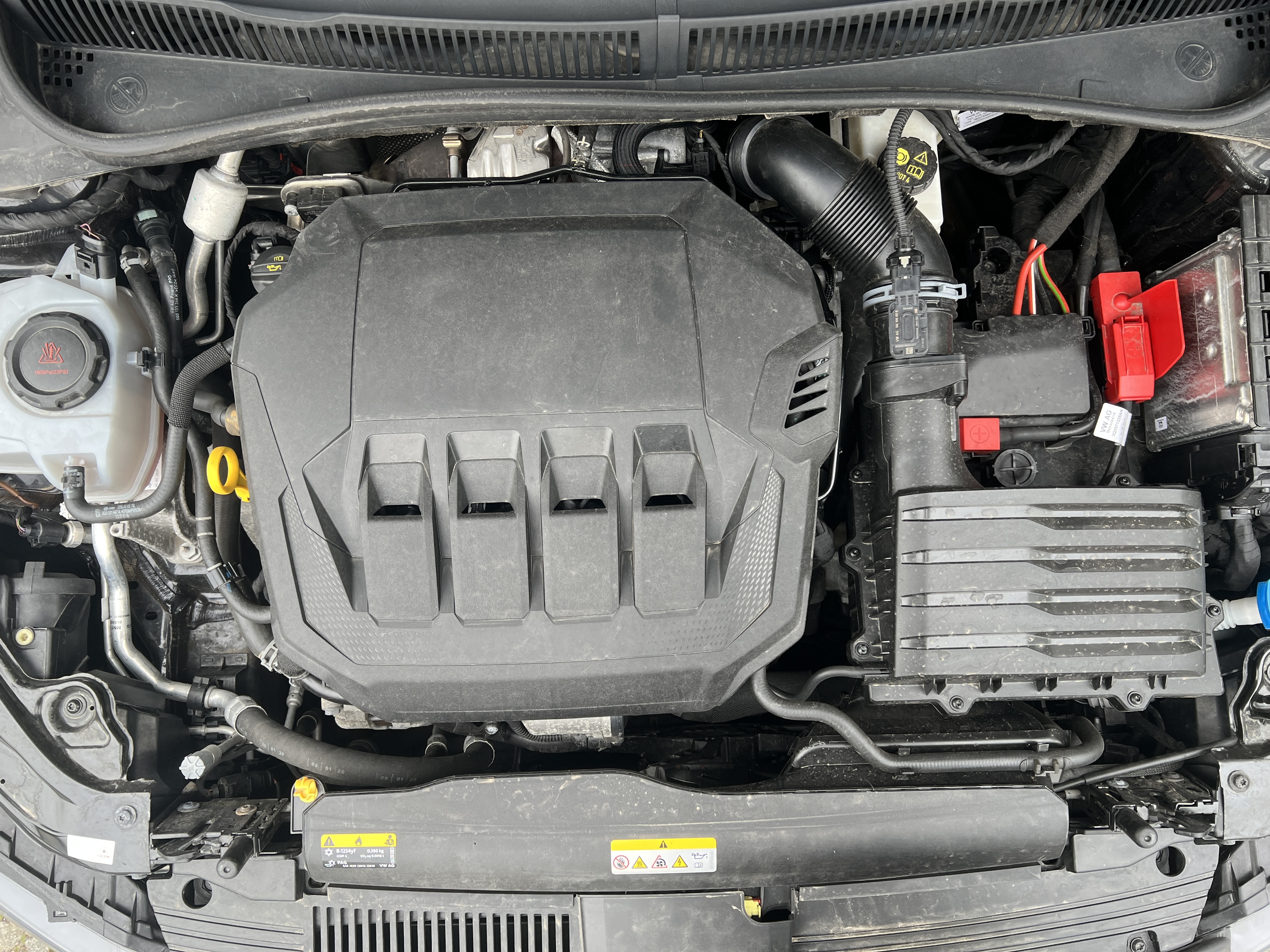

yes there is a big red jump start terminal next to the ECU on the right side (drivers left). you can use that as a plus.
for the minus you can use chassis, engine, engine mount, etc

Just had a look and found what you mentioned. There also appears to be a BIG bolt to the right of it marked -ve.

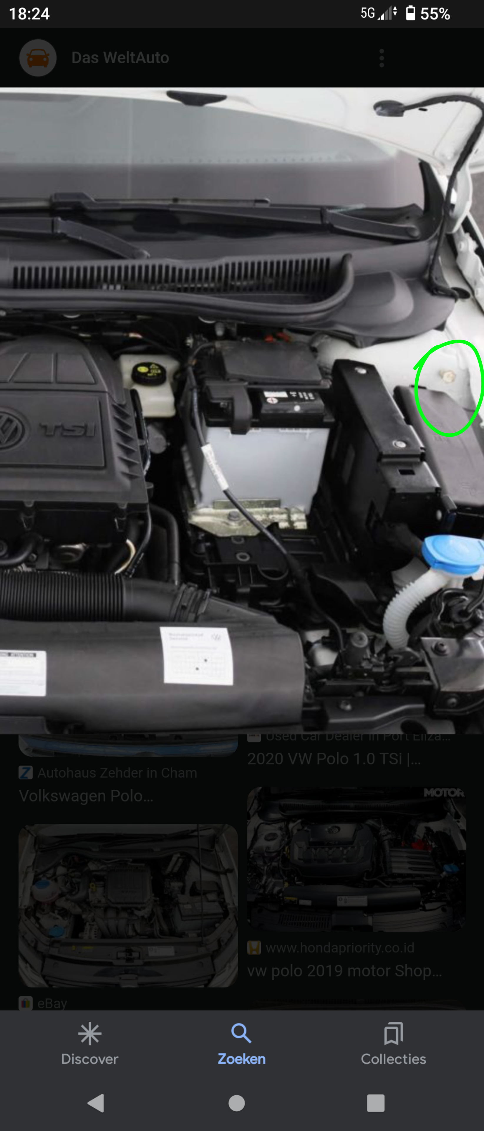

Can you tell me where did you exactly plug the negative ? I can’t find anything, that’s standing out..Image

Can you draw some points on the photo, so I can be sure ? Thanks! 👌🏻

There should be a big knob like stub in the right side just beneath the parafan of the windscreen.
That's your minus.

That's the one :)
