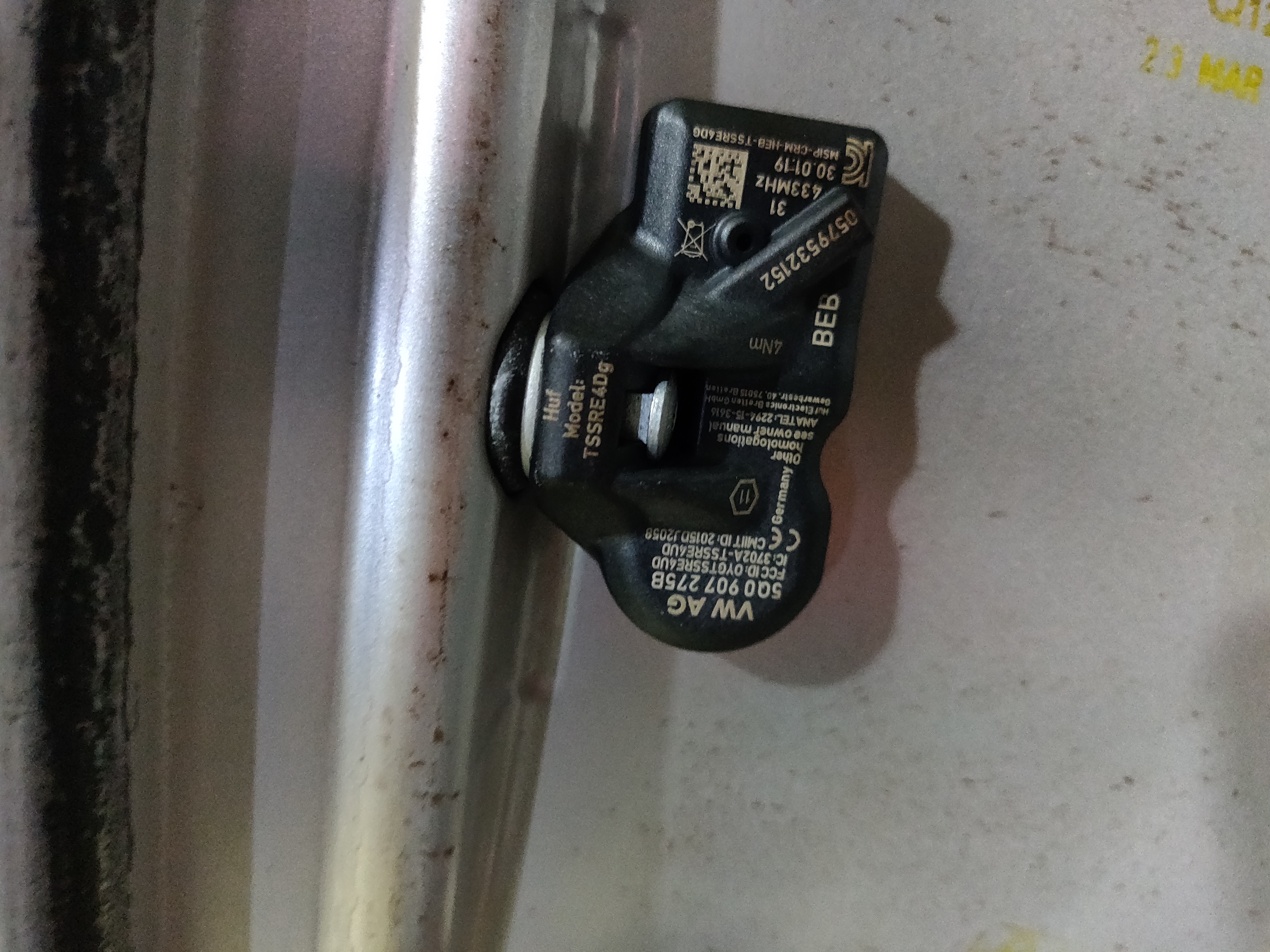

From the combined experiences of me and a few of my friends who have purchased TPMS kits, sensors from Aliexpress, there are quite a few knockoff sensors on Aliexpress, which are nearly 1:1 in appearance to an original TPMS sensor. Replica sensors have every line of text you'd expect on an original sensor e.g. VW AG, HUF etc. but they did not always seem to work in a similar manner :cry: .
The most notable and traumatic difference was with respect to how easy or difficult it was to pair them. An original set of sensors should pair with the TPMS module within a few minutes of driving, while some aftermarket sensors just refuse to get auto detected. They needed to be manually paired by matching the sensor ID and physical location e.g. Left Front, Right Front etc. by determining the sensor's actual ID.
Here is a picture of my the factory TPMS sensor present on my father's Tiguan, which I clicked when I was swapping the tyre due to a bulge. This sensor was black in colour, making me believe factory 5Q0 sensors perhaps came in both Black and Orange.
Thanks to the great culture on this forum, I am inching closer to starting a thread on my father's car with every passing day.
Re: Patil's T-roc 2020 1.5Tsi evo+Dsg7 RHD
Yes, the factory 5Q0..B sensors on my Passat were indeed also black.
