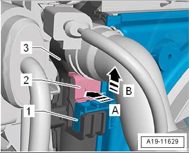

I attempted to remove and replace the main fan over the weekend but was unable to do so as the turbo to intercooler boost pipe has a clip which one of the main engine harnesses is tied to. It protrudes just enough to get caught on the hub of the primary fan making it pretty much impossible to get out without risking damage to the radiator. Probably no more than 1cm of plastic
As for getting the fan pack off of the radiator it's probably the easiest part of the job. Push the tab on the radiator in and pull up on the pack and it just pops out. There does seem to be a sequence to it as the driver's side wouldn't come out until the passenger side was unclipped.
Video for an example:
https://www.youtube.com/watch?v=df7k9U5 ... bW92YWw%3D
Workshop manual diagram: I imagine for those without the 1.8TSi this job would be much easier as it seems they used water to air charge coolers instead of intercoolers for the likes of the CJZD 1.2TSi so no intercooler pipes to get in the way
For the 1.8TSi If you can get the turbo to intercooler pipe off then you won't have any issues. Or if you take the front end off and put the front clip into the service position, but that's a lot of work unless you're taking the front off already.
