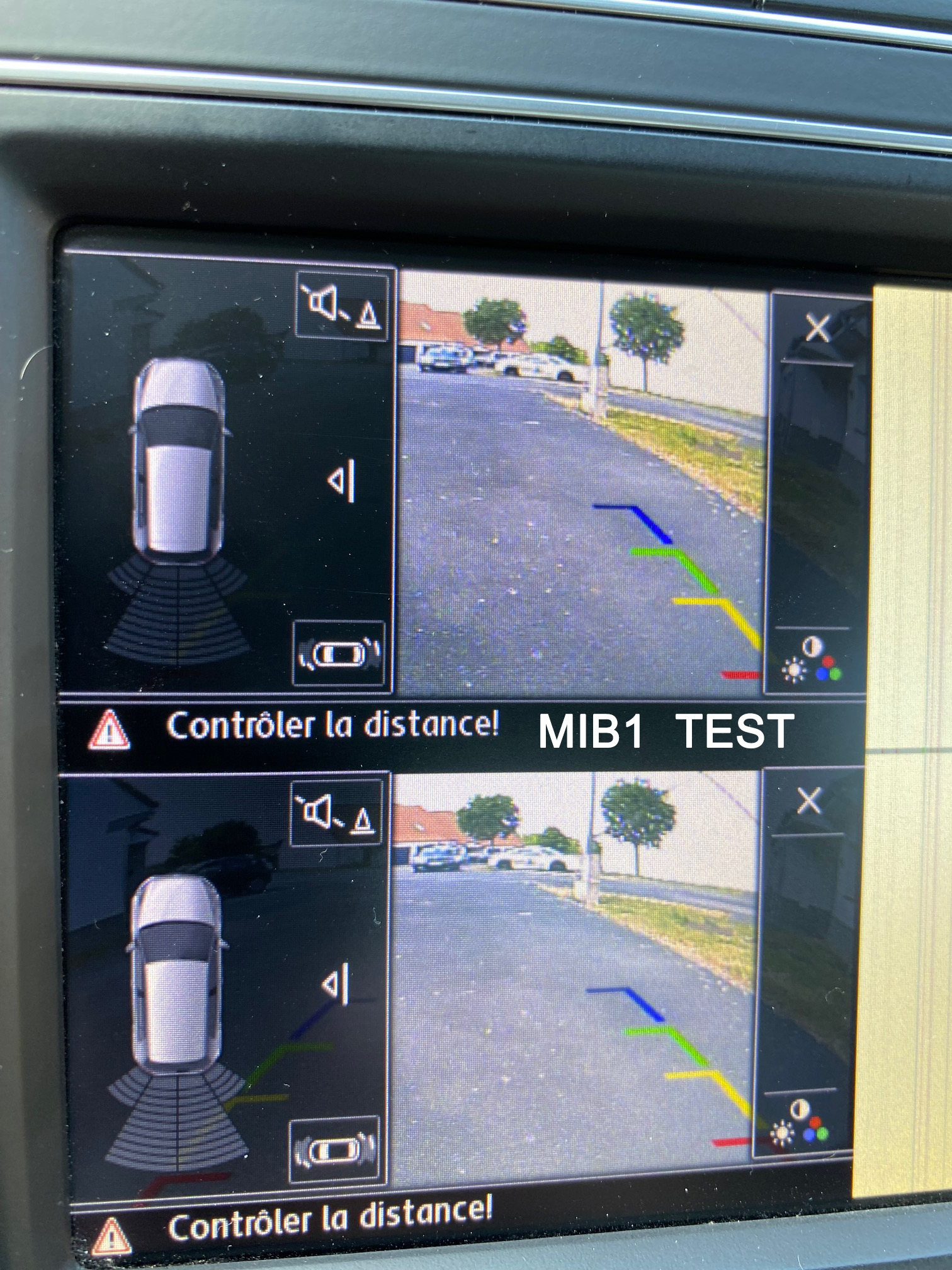

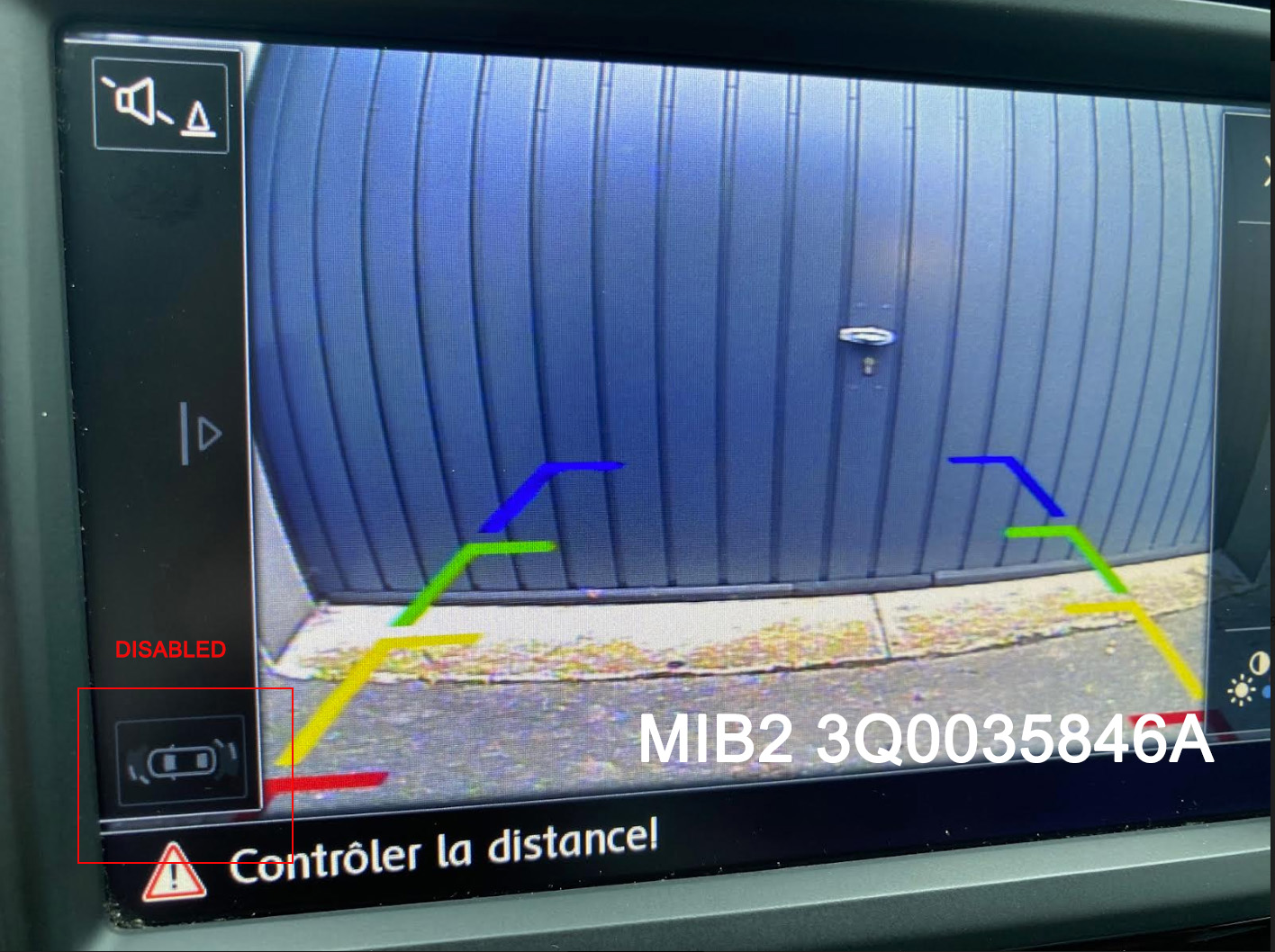

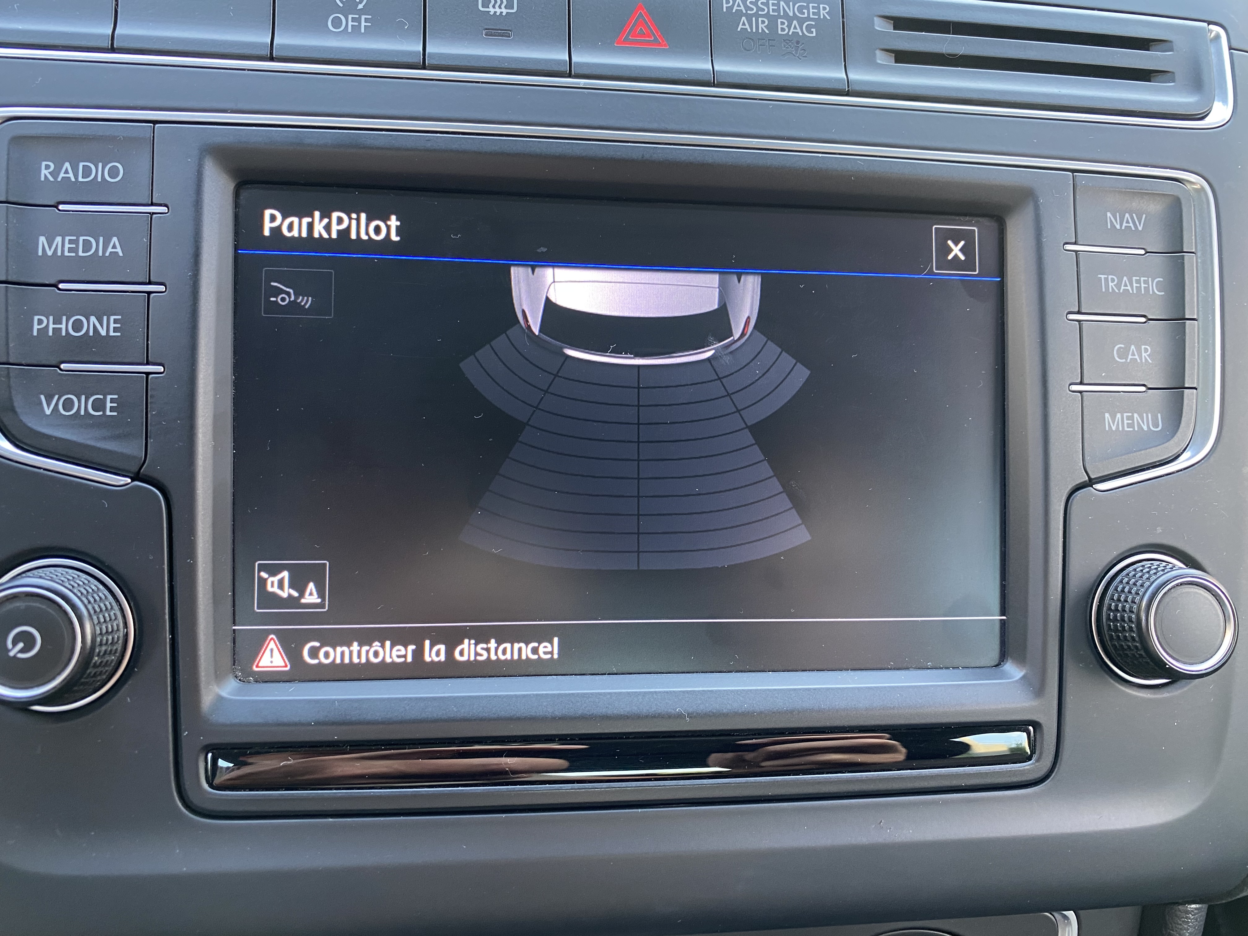

I retrofited RCD330 Carplay (Ali) to a mib2 3Q0035846A on my Polo 6c 2015.
All works like expected except park assist and rear camera (static in rear logo). I can have in same time OPS PDC and rear camera.
I made a test with a mib1 and same coding and it works, (except screen resolution for sure ..)
My question is, does the mib2 3Q0035846A is able to show in same time pdc incrusted and camera ?

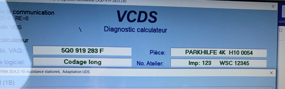

here is my log any idea ?
unit defective ?
park 10
IDE00001-Production mode,Deactivating ,3
IDE01165-Park assist activation tone,On ,1
IDE01169-Audio lowering request,On ,1
IDE02332-Deactivate production mode,0 ,3
IDE03782-Switch-off speed for parking assist,15 km/h,1
MAS01426-Rear parking aid buzzer: volume,Stage 4 ,1
MAS01427-Speaker frequency for rear park assist,Stage 4 ,1
unit defective ?
park 10

Is your Pdc module compatible with mib2?
Re: Retrofit mib2 3Q0035846A problem
Hi !
Ha ? You think it could be not compatible ?
Works with mib1 ir’s true ..
But i suspected a defective mib2 unit (only for park)
I bought the kit here it’a 5Q0919283F
https://www.carsystems.eu/new-vw-polo-6 ... d1248.html
maybe i can buy another one ? If you have a good ref that must works (8k i would update from 4k)
