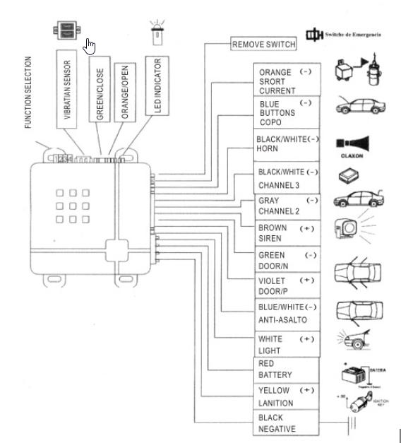

Hello i have polo 6N2 and the central locking pump 1H0962257F and i want to install central locking alarm with remote control .Can anyone help how to connect it ?
