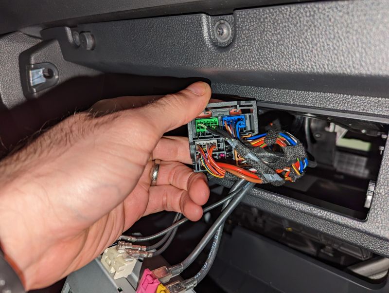

I am planning to retrofit:
OEM wireless phone charger
OEM blind spot sensors
OEM LED tail lights with dynamic blinkers (currently I have stock LED tail lights.

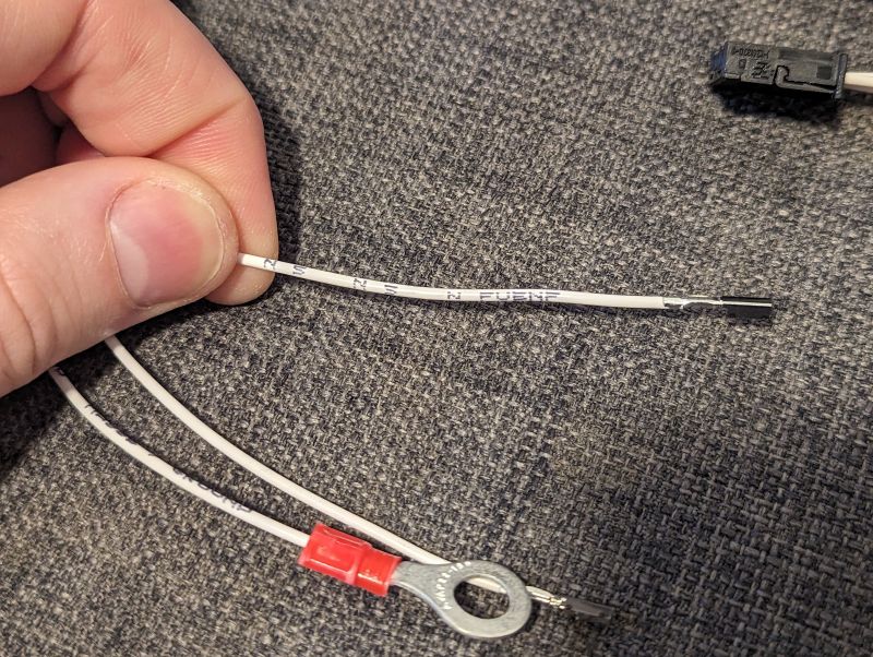

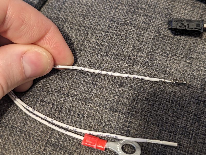

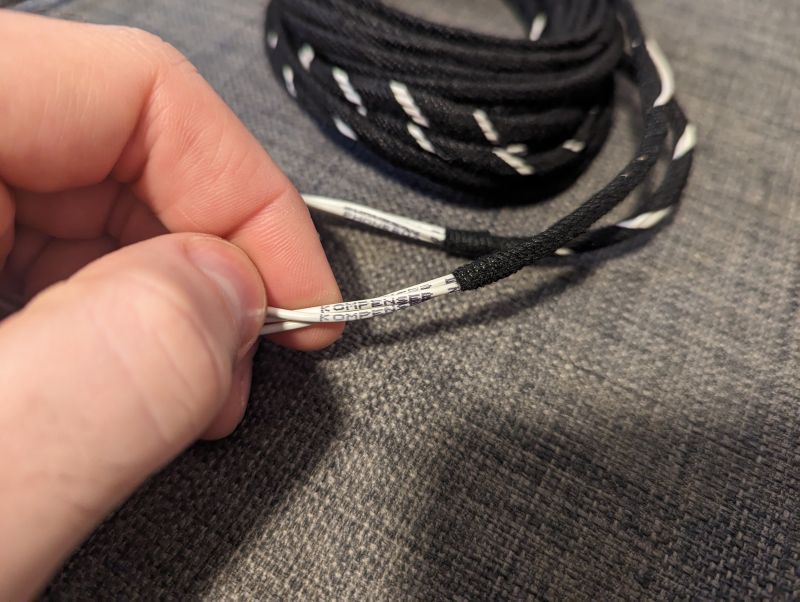

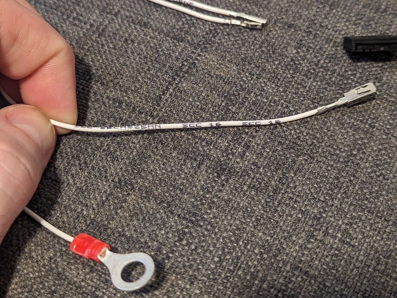

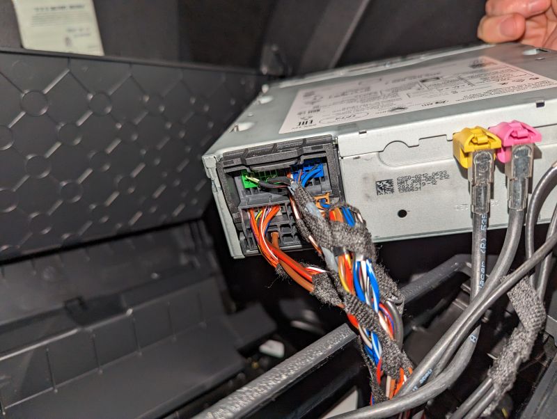

I am starting with the wireless charger. I bought a kit from a German website. They send it with a OBD coding dongle and wires. Unfortunately there is no manual for this retrofit. The location of the charging module is self-explanatory. The outdoor antenna should go on the back bumper and there should already be a mount preinstalled. I am not sure about the signal booster. If I understood @ciclo post correctly, the booster goes somewhere near the taillights.
The N5 and N11 wires go to the grey connector on MIB3 unit. And the SCC 16 goes to fuse 16 in the Fusebox C, at the drivers side (left hand drive car). I am not sure how to do this. Do I take out the whole fusebox, is there a free connector or something on the backside of fuse 16? Or do I need to use "fuse taps" or do I need to make an additional fusebox? I have checked the fuse diagram for the T-Roc, and yes Fuse 16 is for the USB-C slots and the wireless chargers.
But I want to know and prepare everything before I take the car apart.

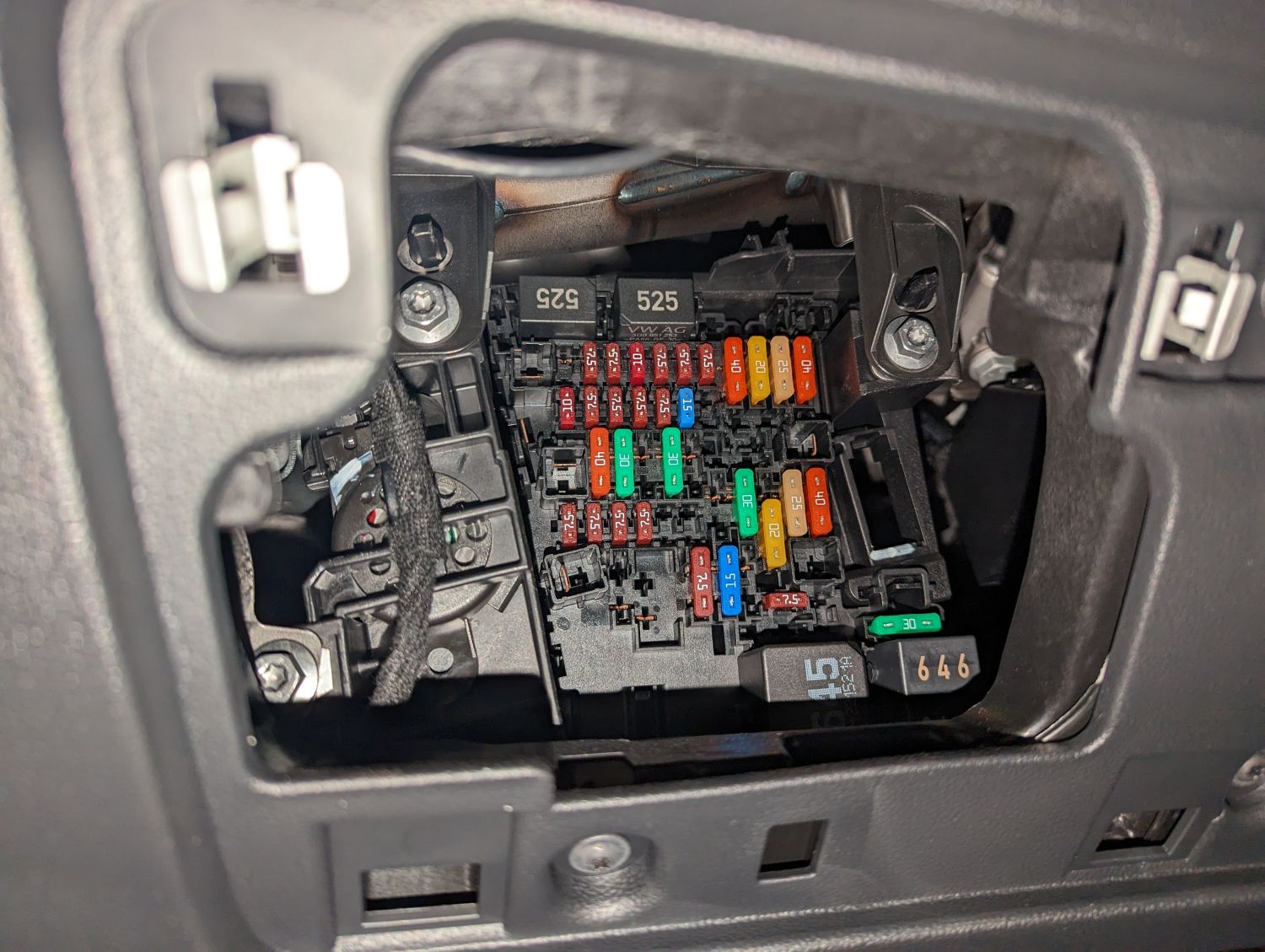

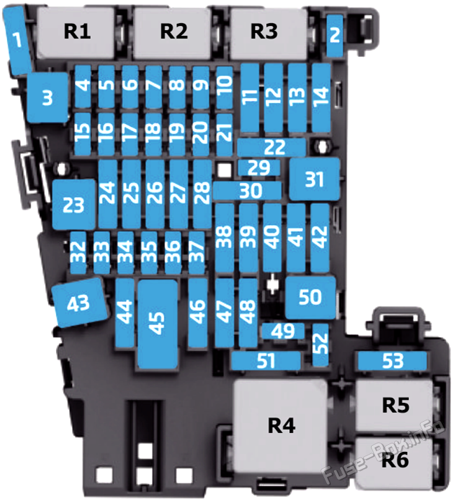

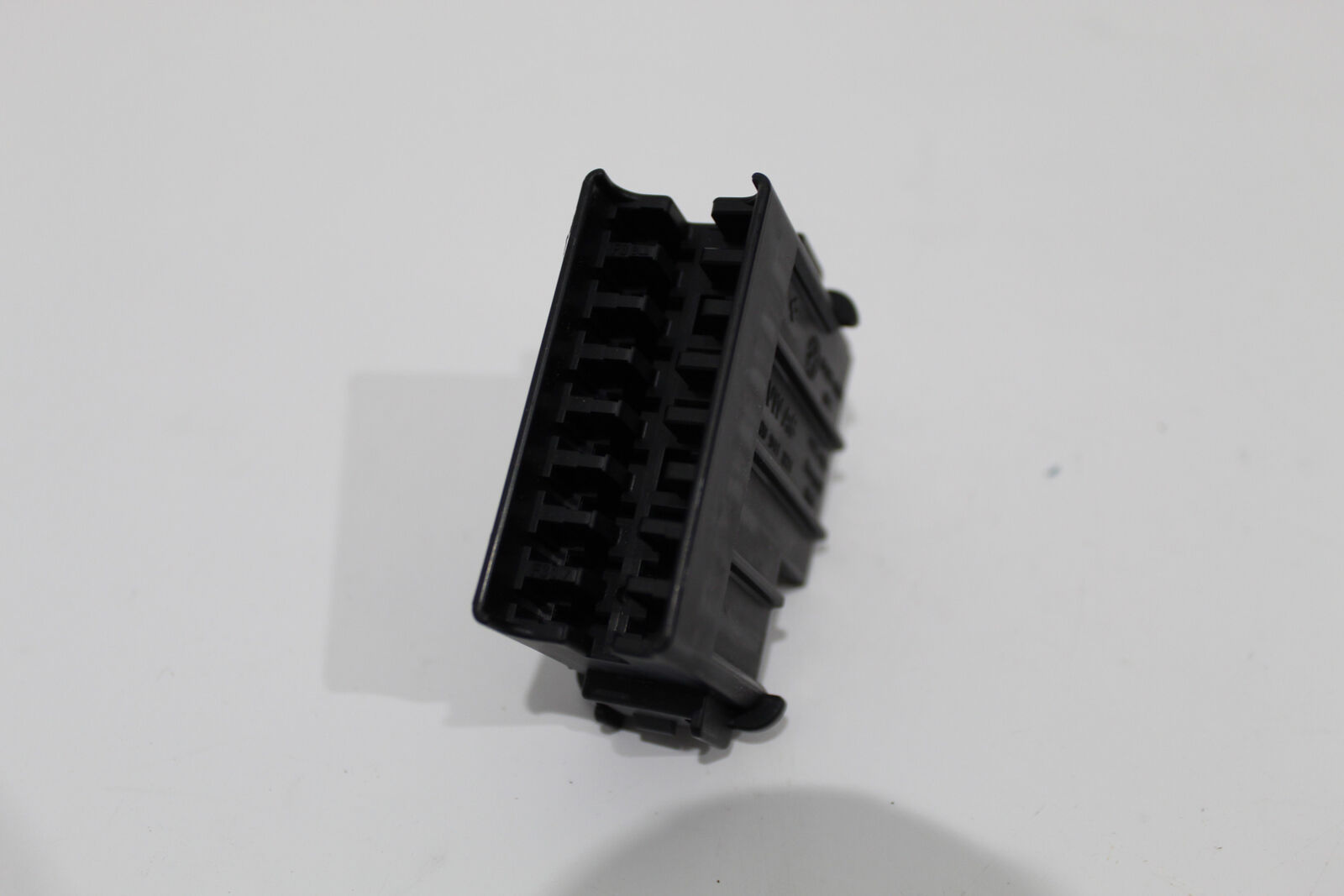

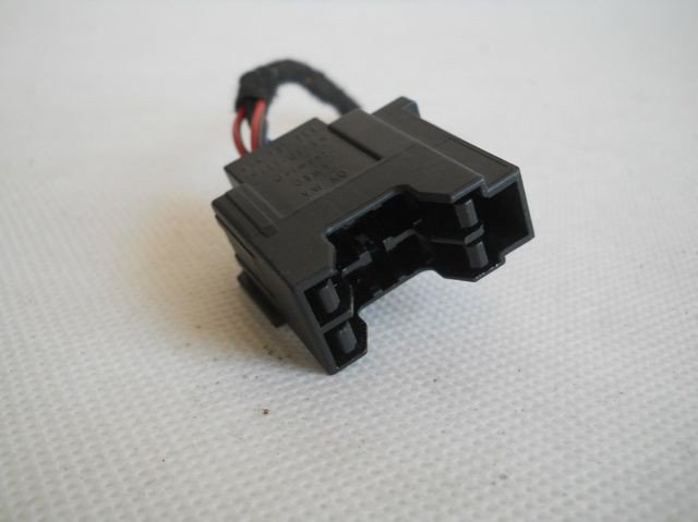

Thank you for your reply. I have managed to find the location of all parts. I want to make the additional fuse box before I start. But my fuse box is on the drivers side. And the spare fuse looks different then the one in Ciclo's post.
On google I found this two version: 5Q0941824 and 6R0937530
But I am not sure if either of them is the part I am looking for. One has only 2 fuses, and the second one, I am not sure if there are any fuses or if it is just some type of a connector.
Photos of my fuse box on the drivers side (left hand drive) and 2 options I found on ebay bellow: 5Q0941824 6R0937530

You need Fuse holder (2 fuses) 6R0937530 and/or (4 fuses) 6R0937530A. The price of both is same. 5Q0941824 is not compatible.
I can see a 2 fuse holder slot in front in your fuse carrier, you can use it.
Also there will be more fuse holders in your PDC module bracket attached to fuse carrier. For more details read here viewtopic.php?p=579233#p579233

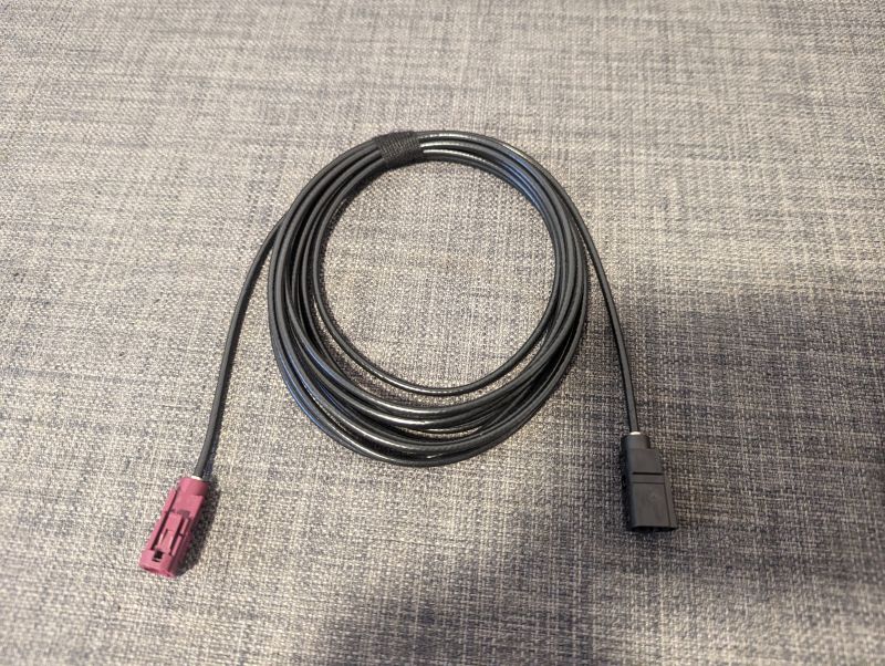

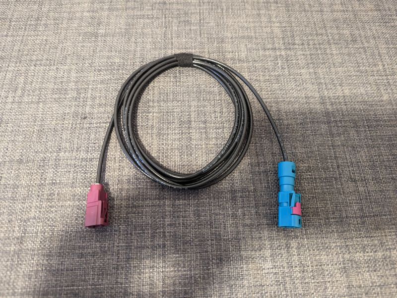

Finally got some time to do some work.
I have installed additional fuses as per Ciclo's post.

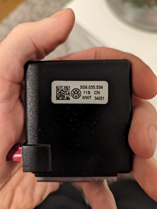

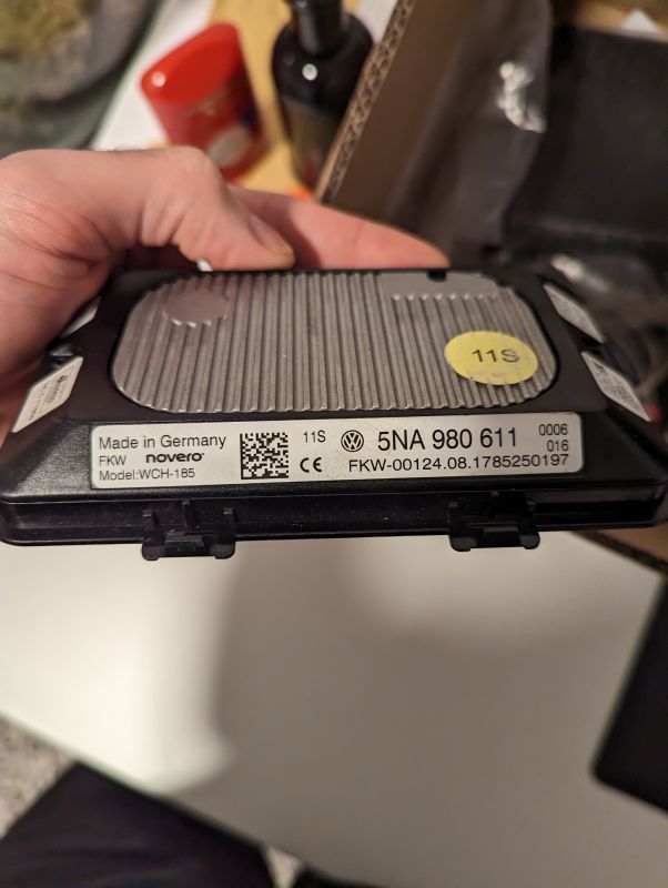

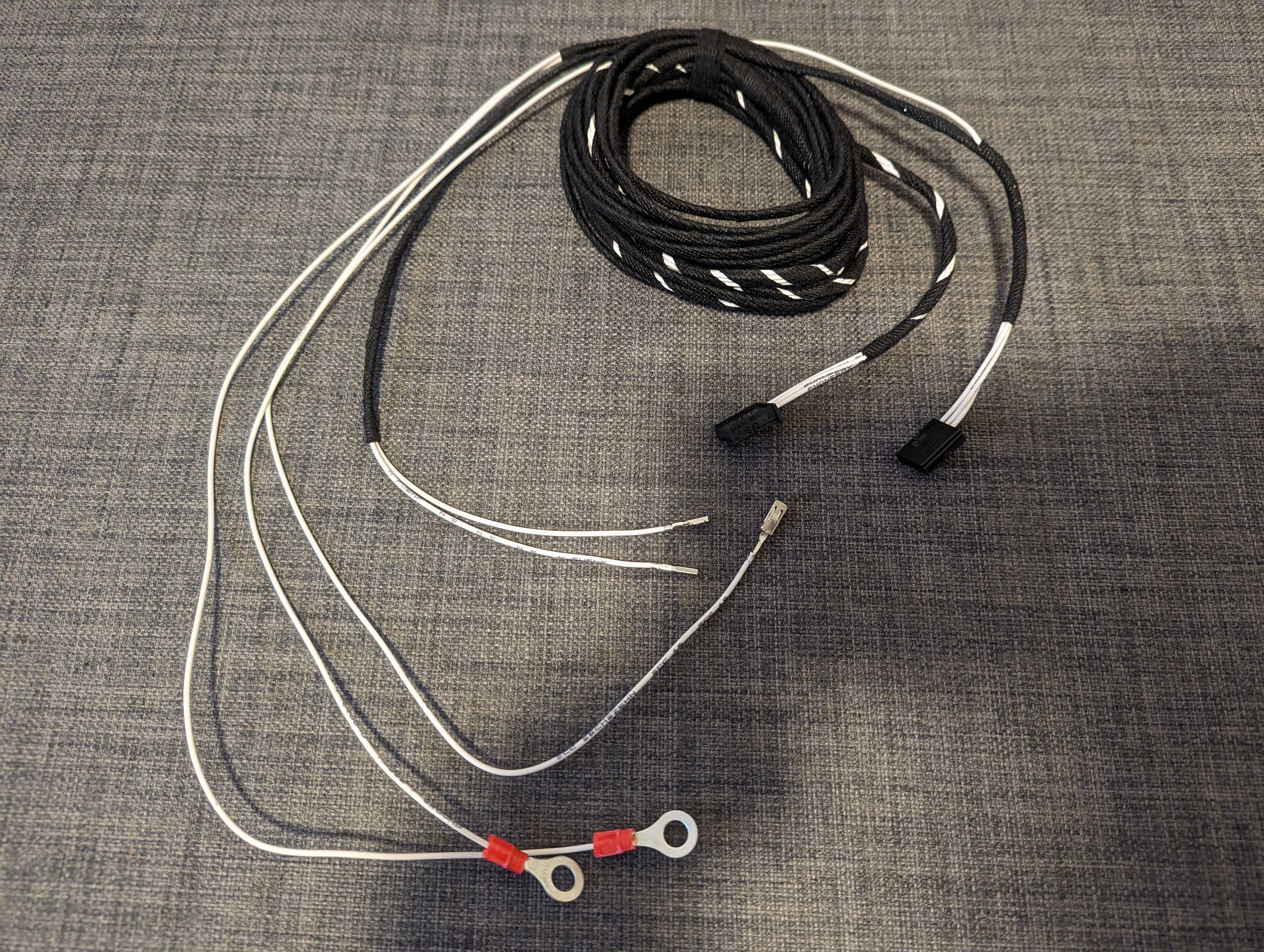

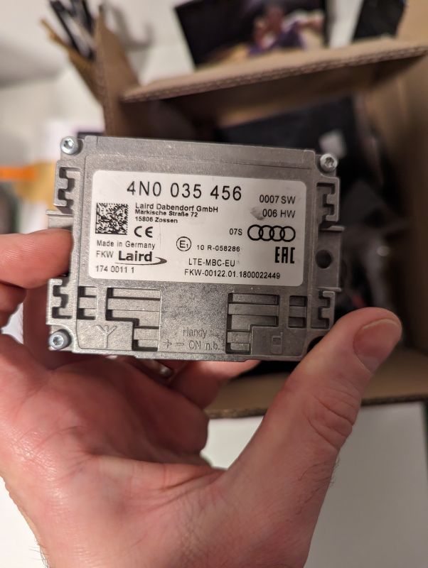

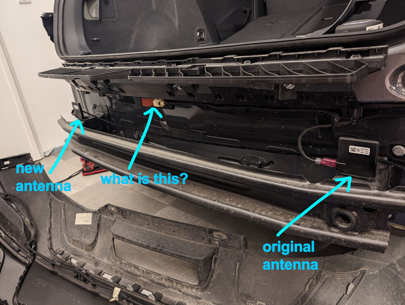

Installed the charger, amplifier and antenna. And connected all wires. I bought a ready made kit from K-----c. The wires with the special plastic connectors could have been 10cm longer, wouldn't hurt them
Interesting thing was, when I removed the bumper. There was already an antenna installed, same like in the kit. Didn't follow the wires so I don't know where it is connected. Could be for the built in eSim and internet services?? Any way, this was on the right side, so I installed the antenna from the kit on the left side
Although there was already an antenna installed, there was no amplifier. And on the location of the amplifiers, there were to holes, but no screws or nuts, so I had to get creative
After I finished everything, I connected the battery back. And it was like Ciclo said, Christmas three dashboard. But after a few 100 meters most errors corrected, the 2 remaining I have cleared with OBD11.
After that I have inserted the coding dongle that was in the kit. The LED lights on the dongle indicated a successful coding. Car off/on and charging was working!!
But there was no icon or text indication on the Car screen like in Ciclo's post and K-----c website. So I tried OBD11 and VCDS with Hex-V2.
Tried the coding from Ciclo: module 5F, Byte 15, Bit 0 ON, Bit 1 ON and Bit 5 ON. But still no luck. There charger is charging but there is no indication in the car...
Maybe the long coding is different on MIB3?
the original antenna on the right and the new antenna on the left:

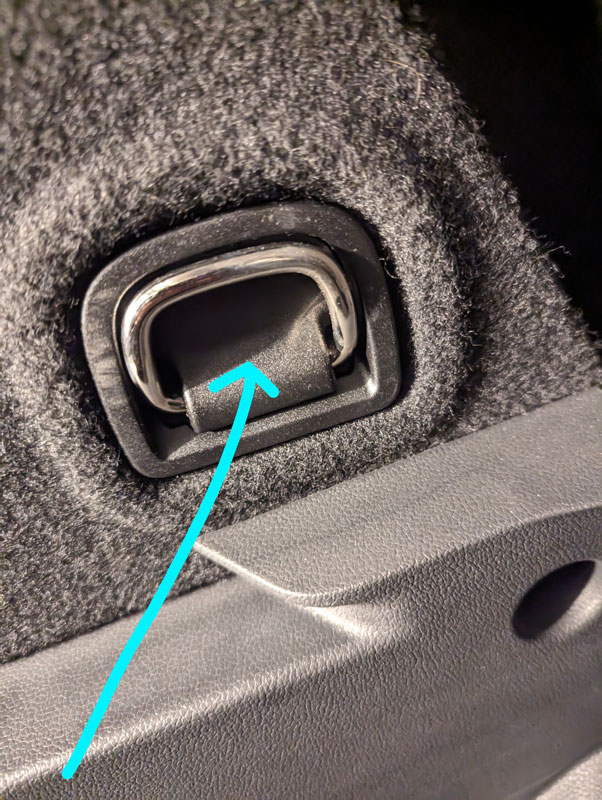

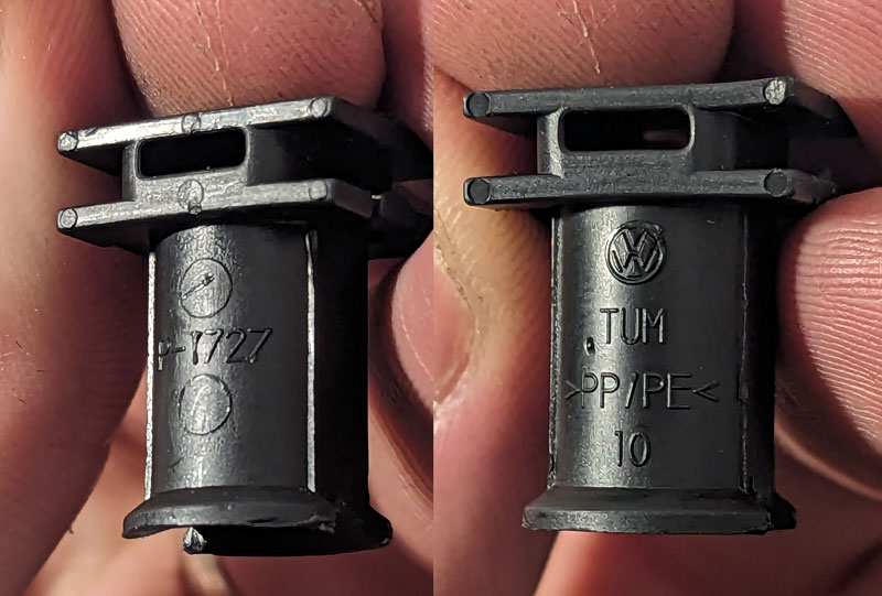

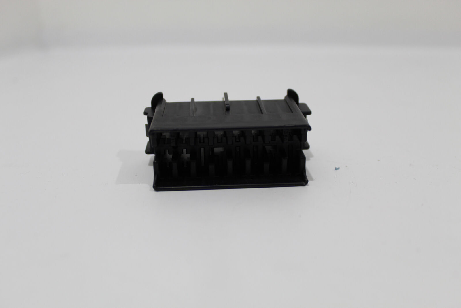

I have broken this small plastics piece that hides the screw of this holder in the luggage compartment. Is it possible to buy just this plastic piece? After finishing I have found this part. Don't know where is it from? Maybe some part from the rear bench? The log from OBD11: I can also post the log from VCDS if it makes more sense?

I just realized the wiring in the kit from Kufatec has no wire that goes to BCM. Is it possible that it is not needed? What does it do? If I have to add the wire, I have to buy some pins to insert into the black connector on the charger and a pin that goes into the BCM connector? Where is it located?
After more testing. I realized that the charger is not working correctly. When I put the phone on it. The phone screen show that it is charging. Also on the car infotainment screen when I am in the APP menu (android auto), the battery icon gets the lightning symbol, meaning it is charging. But it stops after 1-2 seconds. Then after some time it starts again, but only for 1-2 seconds. And this goes on and on... Like it sends only a small impulse and stops...
I compared it to charging via USB cable... The battery icon with the lightning indicator is present always. It doesn't disappear.
Maybe the issue wasn't coding after all. maybe it is the missing wire?
EDIT:

Middle one could be for kessy.
On my polo I have the same antenna, I do have kessy
