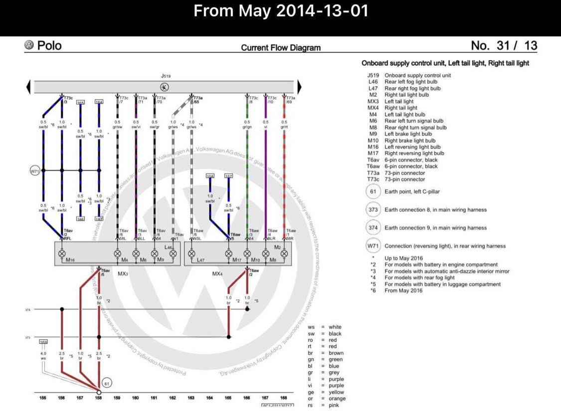

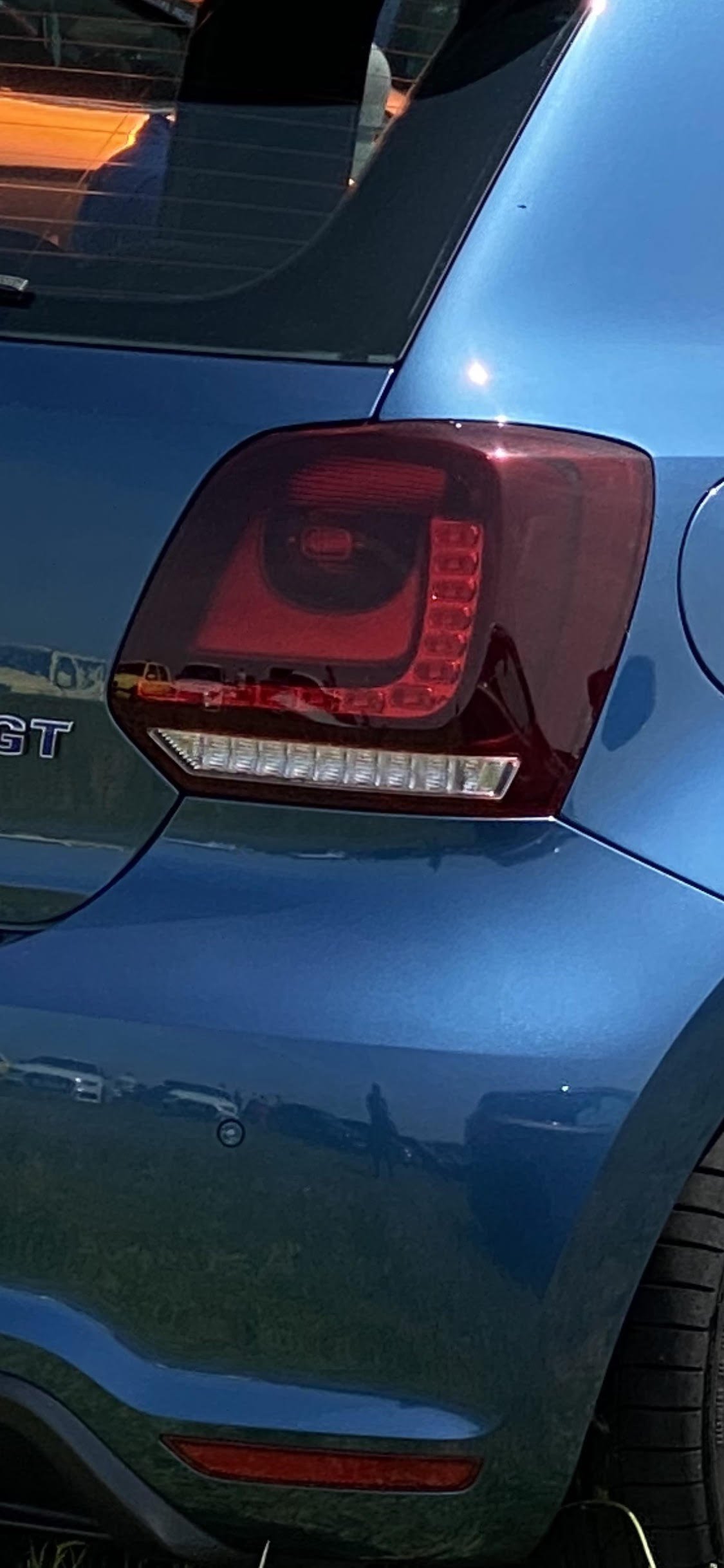

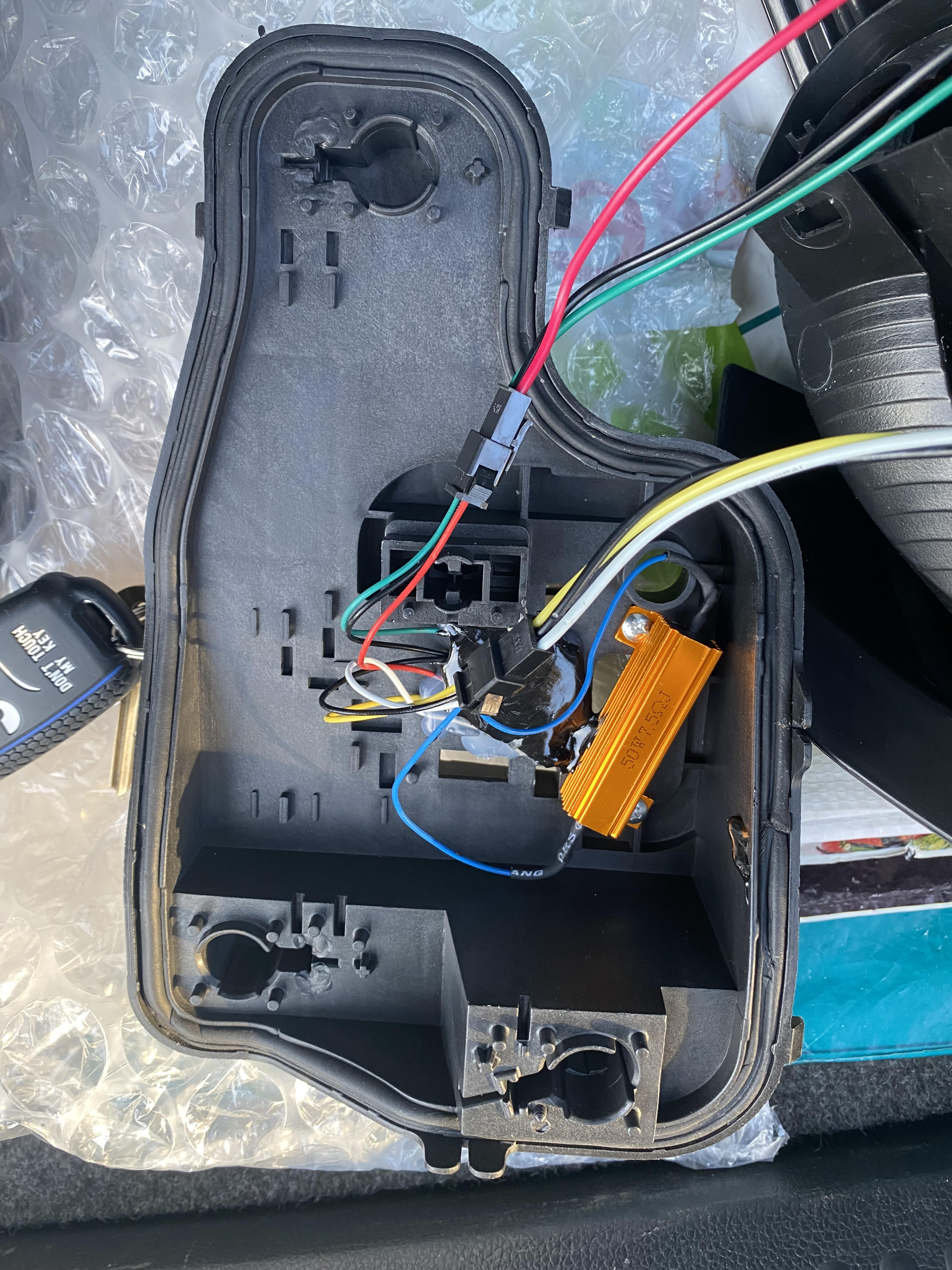

Can't get rear fog-light to work on my 6R Blue GT after upgrading the BCM
Aquavalver
- Posts: 474
- Drives: 2013 Polo Blue GT
- Location: north-east Kent
So last year I fitted some LED rear lights, that were meant to have been UK insurance approved. Anyway, a few days later I realised that I had no reverse light or fog light. I took the lights off and then realised that the pins on the RHS rear light matched the plug on the end of the LHS loom and vice-versa! So then I obviously realised that the lights for actually for LHD cars! Anyway, I got a friend of mine (who lives up the other end of the country) to make an adapter loom for me and then everything worked fine apart from the can bus warning light on the clocks.
Back in early March I found a retro-fitter/coder and he fitted my 6C carbon fibre steering wheel and of course I needed to change the BCM for the steering wheel buttons to illuminate. The BCM was a 7E0 that I bought from Ciclo back at the end of 2019! Everything worked fine apart from the rear fog light. The guy that fitted them wasn't able to get it working and it was dark and late by then. He said he'd look for the wiring diagram to see if he could sort it. Anyway, he found the diagram and said that on the old BCM, it was pin 6 for the rear fog light and on the new BCM it was pin 65, on plug A. He was very busy for while and it wasn't too important at the time needed the rear fog light working, but as my MOT is due in a week, I contacted him and went to see him this morning to get it sorted. However when pin 65 was used, the rear fog light was on permanently and the sun-visor vanity mirror lights did not work and he was not able to sort the problem. I include the wiring diagram and the scan he did.
I have an aftermarket Alpine Apple car play headhunit -iLX-705D which is why some of the radio faults are showing.
Can anyone help with the fog light problem and also what do I need to remove the canbus warning light because if have LED rear lights?

The reason why I liked this design of LED rear light is because for 1., most people when changing the rear lights choose these V-Land (Audi A1?) style ones which I'm not so keen on, 2. They kinda match the factory Bi-Xenons in their style (which I still have to fit at some point) and 3. Not many people seem to have them and I like to try and be a little different!
They are all LED and there does seem to be a resistor, if you notice in this photo.
Only slight problem is that the retro-fitting/coding guy is about 1 1/2 -2 hour drive away each way, so it's a bit of a trek and fair bit of fuel to keep going to him.
- unnamed-323.jpg (1.29 MiB) Viewed 7985 times

- Location: Earth β₯, Spain.
Re: Can't get rear fog-light to work on my 6R Blue GT after upgrading the BCM
Thank you very much for the image!
By the way, the wiring diagram you posted is for the Polo 6C...
Here you find any diagram you may need for 6R, etc.

It may also cause the canbus warning light.
It is necessary to return to the original wiring installation!!!
A new BCM coding is also essential!!!
In economic matters nothing is written, the experts make conjectures that are not valid for everyone.
Never lose hope, and try to be the one who writes your future.
- Due to installing the WRC bumper and removing the fog lights and DRL... and then not coding the BCM.
- Also possible due to the new wiring your friend did for the aftermarket LED taillights... as I understood these aftermarked LED taillights are for LHD and your BlueGT is RHD.
The rear fog light does not work with the original taillights because you have it coded as if it were an LED version (Byte27), the rest of Bytes for rear fog light is correct!

Thank you. The canbus warning light didn't come on after the WRC front bumper was fitted, but when the led lights were fitted. When I re-fitted the original rear lights, I also removed the adapter looms, so it was as it used to be apart from the BCM.ciclo wrote: Thu Jun 29, 2023 2:10 am The canbus warning light is due to incorrect coding for the current installed equipment.
Never lose hope, and try to be the one who writes your future.![]()

Yes, I understood all that
, although pin T73a/6 was touched during this process to feed its wire erroneously/mistakenly from T73a/65, with the possibility that it was not installed correctly later.
We need a diagnostic tool to rule out possible causes of failure and 'investigate' why the rear fog light now doesn't work with the original taillights.

Notes:
- The canbus warning light could appear when you requested (intentionally or not) from the light switch the front fog lights function or the BCM managed the static cornering lights function without having the front fog lights installed, which does not necessarily have to match with the bumper installation.
Your BCM was not coded correctly after the WRC bumper installation, and I can assure you that due to these conditions the diagnosis explodes (warning light + detected faults).
- Fault overlap is possible.
It is a contradiction that the MFD (from factory in the 6R BlueGT) does not report the exact failure of some lights when the canbus warning light comes on
... well, the 6R has several contradictions, even in the wiring diagrams (erWin) some diagrams are missing (a bit enigmatic
e.g. Full wiring installation for Polo 6R "7L3" (without start/stop system) with factory bi-xenon.

Sometimes we forget the simplest things, for example, until the diagnosed fault (DTC) is cleared with the diagnostic tool the light that caused the fault will not work.
