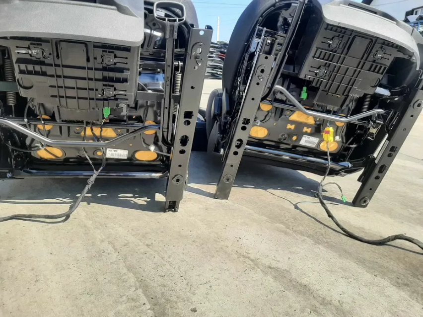

Hi I found this nice interior from a 2017 Cross and I wonder if it will fit the 6R. I know there are some compatibility issues between 6R and 6C occupancy sensor. Would this be a problem?

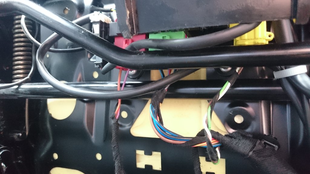

I've attached a photo of the wiring under the seats for reference.
Also do they have heating? I can't figure it out from the wiring

Green connector is for seatheating
Yellow one for airbag

No these seats do not have seat heating! The green connector is seat belt, yellow is airbag and blue will be passenger detection.
I think you'll get away with removing only a part of the seat upholstery at the front or the rear. No need to remove it all.
You probably will have to remove at least one of the longitudinal wires holding down the fabric and then you can slide the sensor in between.
Ideally you must remove all to properly glue down the pad, but if placed correctly, friction only will keep it in place allright.

My bad.
On the 9N3 was it as follows
Yellow: Airbag
Green: Seat heating
Red: Seatbelt (only drivers side, French polo's were optional equipped)
:oops:
Re: Polo Cross 2017 seats in a 6R
That's alright. At least yellow was correct :D
