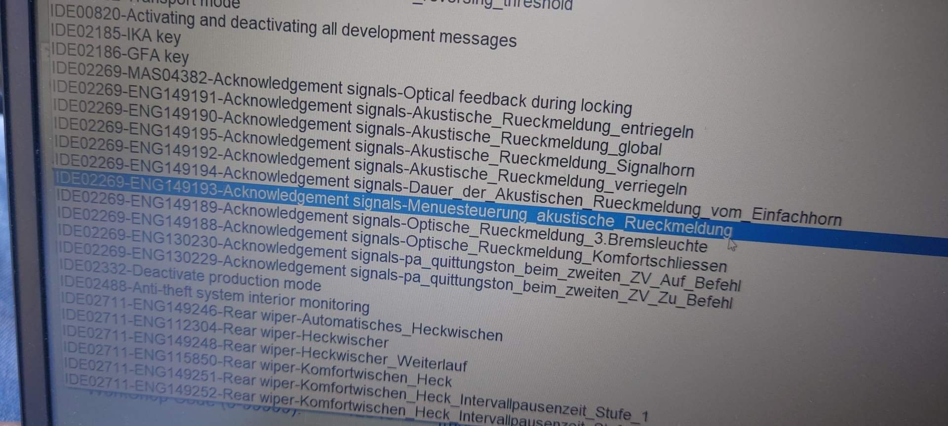

Dauer should be set to short.
All should be set to active {akustische ruckmeldung)
Menuesteuering active.
Possible need to reset the radio to factory settings
GTI 2020 should display a box to check under open and close menu

Maarten wrote: Sat Sep 09, 2023 6:42 pm received_1280826459325920.jpeg
Hi Marten,
Thanks. I’ll have a look and have a play about.
Appreciate the screen grab. My German isn’t great 😂

Akustische ruckmeldung = audible comfirmation
Dauer = lenght
Menuesteuering = check box in radio menu
Entriegeln = opening
Verriegeln = closing

Maarten, thank you for taking the time to clearly explain.
Everything working 👌🏼. Even managed to leave open/Entriegeln switched off as I just wanted the close option enabled. Having the ability to control through the MFD means I can disable when parking late at night.
Really appreciate your help. I am sure others reading this will too.

For future reverence, the checkbox only appears in the pre FL models of the AW.
From modelyear 2022 (new front and tail) there is no longer a check box under open & close in the radio module, so for them it is either on or off via VCDS/OBD11
