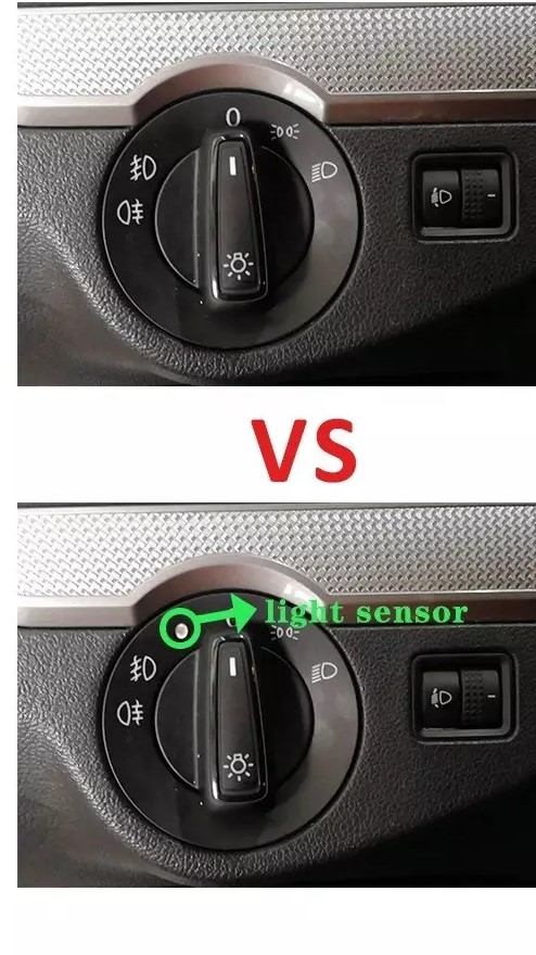

Good day . I would like to ask for help. I want to install xenon on Amarok 2.0 bi turbo 4.2012. light switch 1K0 941 431 BD, I have lights 2H1 941 015 T, 2H1 941 016 T, BCM old 6R7 937 087 M, new 7H0937090B BCMPQ25, VIN: WV1ZZZ2HZCA056596. THANKS FOR HELP

Re: Amarok Oem Bixenon retrofit
well thank you . I will then try to use this switch
- Posts: 8982
If you use that light switch with that aftermarket light sensor, you will have diagnostic failures or malfunctions with the lights.
In this case, first install the BCM Max and the bi-xenon headlights so that everything works correctly (a fault-free scan).
Then and only then, you can install that light switch to verify its operation.
From what we have learned on the forum, those light switches are designed to work with non-Max BCMs, they could hardly work correctly with BCM Max.

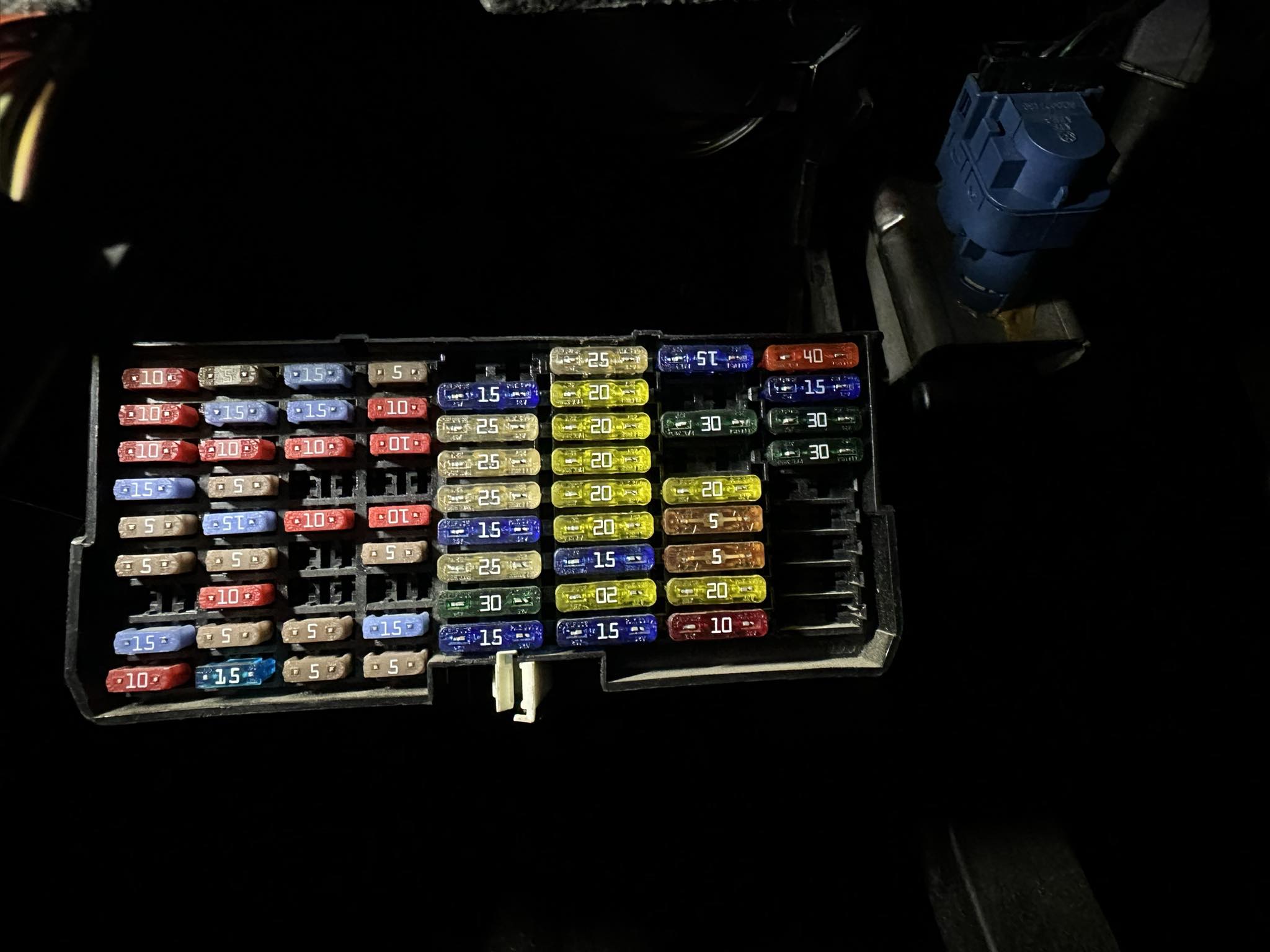

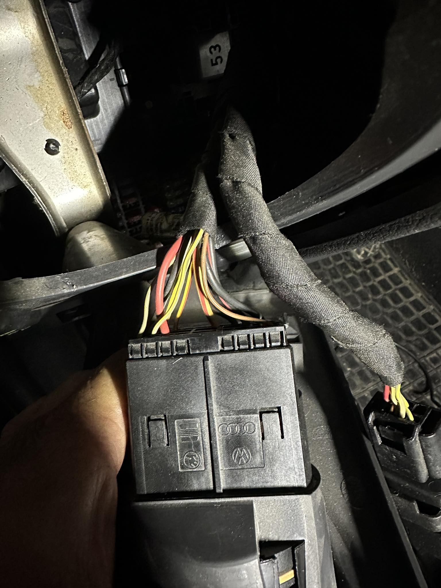

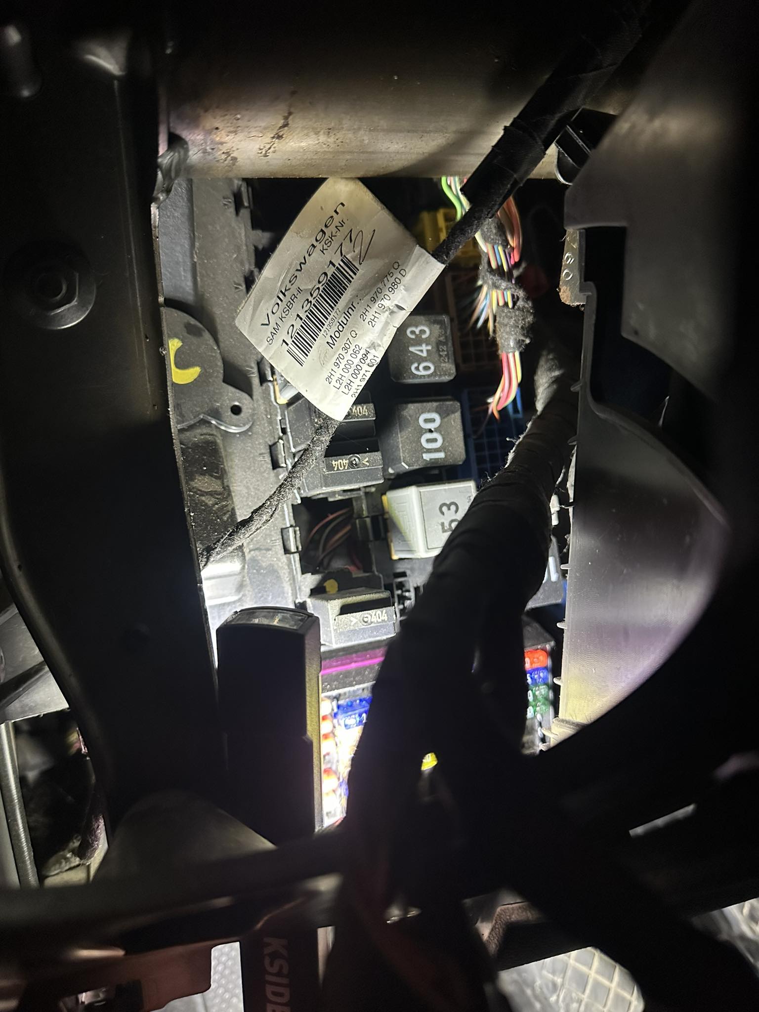

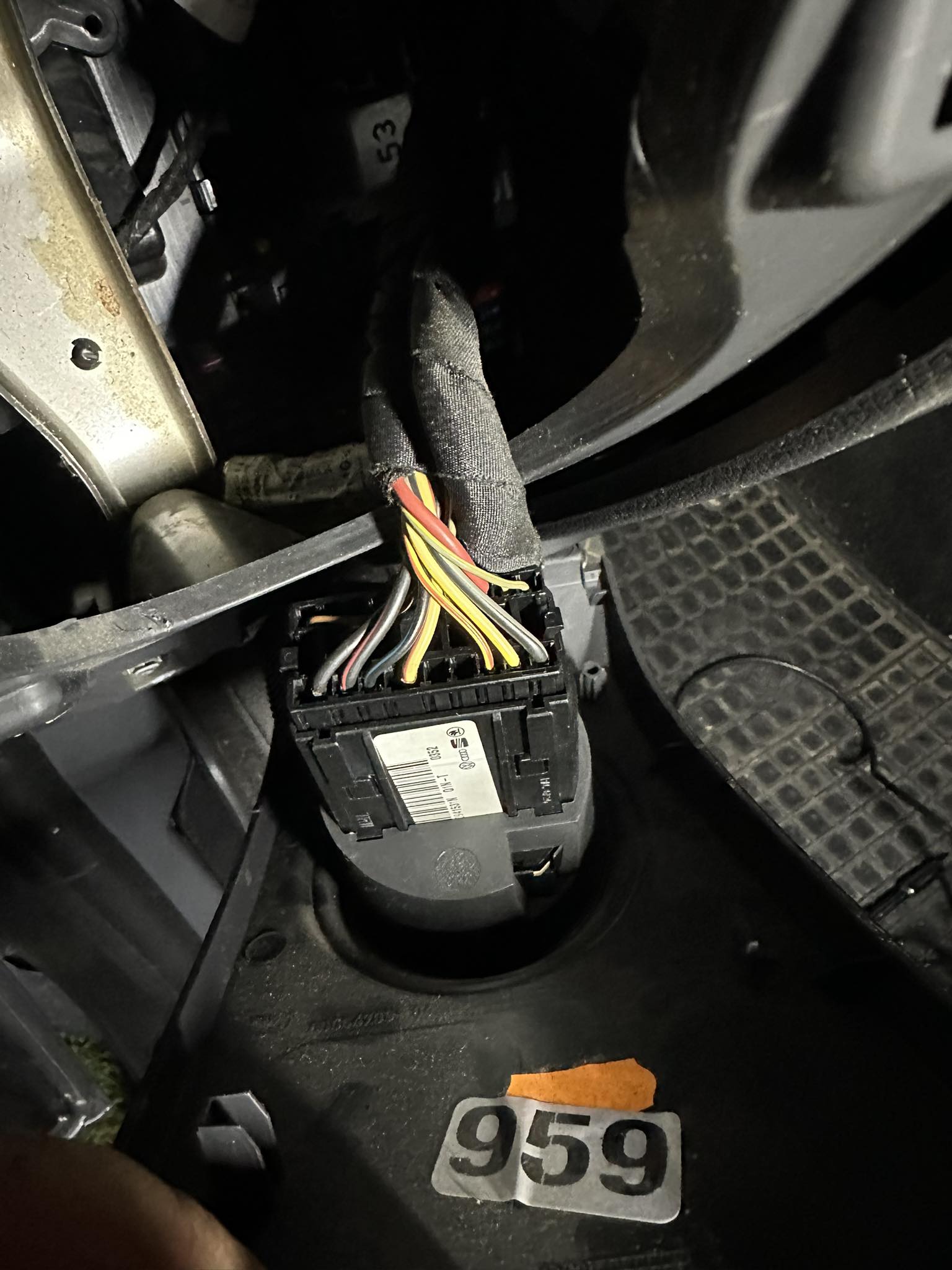

good day. connection according to the forum. dipped beam lights do not work. I do not get 12 V on fuse 55 and 29. only direction lights work, daytime led lights, parking lights, please code them. thank you
