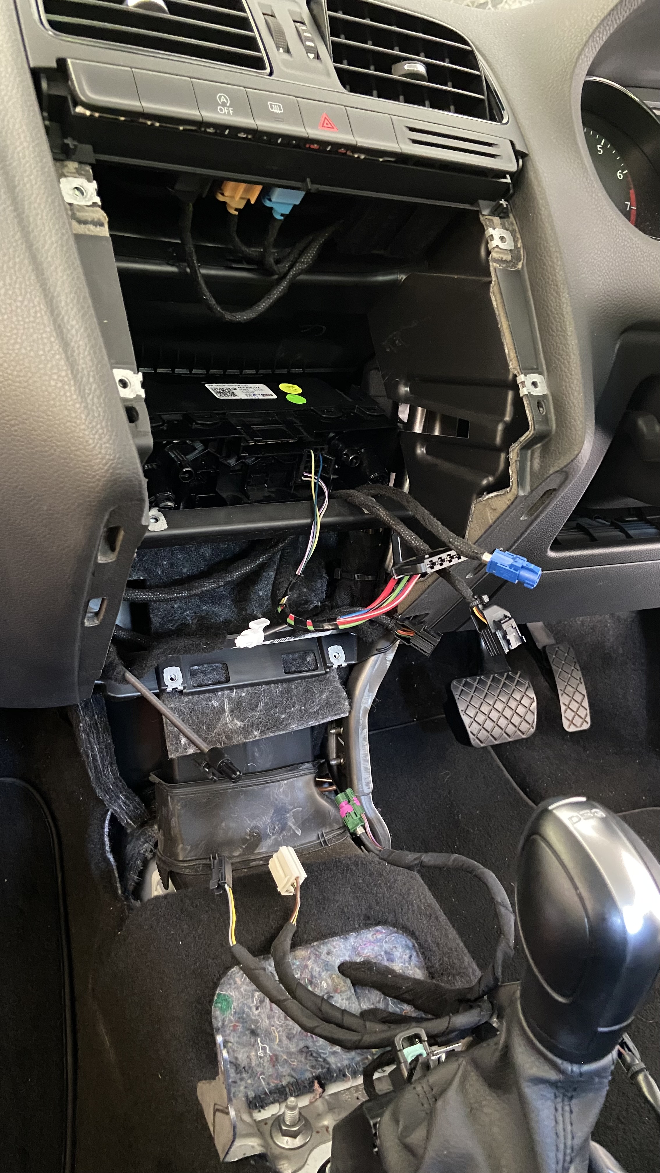

I had really good success with taking out the interior + seats to clean today:
It’s all back together now:
I wonder why VW uses metal that develops this rust over time:
It’s really annoying to see when they should have coated it or used a different metal that is more rust resistant. Is there anything I should do to treat this surface rust?
I noticed this panel for the passenger footwell storage compartment was not clipped onto anything:
Does it look like it’s missing a clip on the body?

That rust is known to us.
I think like you, I believe that it begins to originate at the moment in which the visible welding is made, although logically it is not visible at that moment.
Whatever method you use to remove/clean it, remember that it is an interior part and that harmful/unpleasant odors will subsequently be produced from any product you use when the vehicle is closed. So don't put too much effort into the process of removing that rust, put more effort into cleaning it.
That lower A-pillar panel/trim is held in place by two clips. Each clip consists of two parts. They have a tendency to get lost. :)

I think I’m probably going to leave the rusted bits. Attempting to clean them is probably more trouble than it’s worth.
The part number for the clips looks to be right. I’ll get some ordered because like you said they appear to have vanished.
