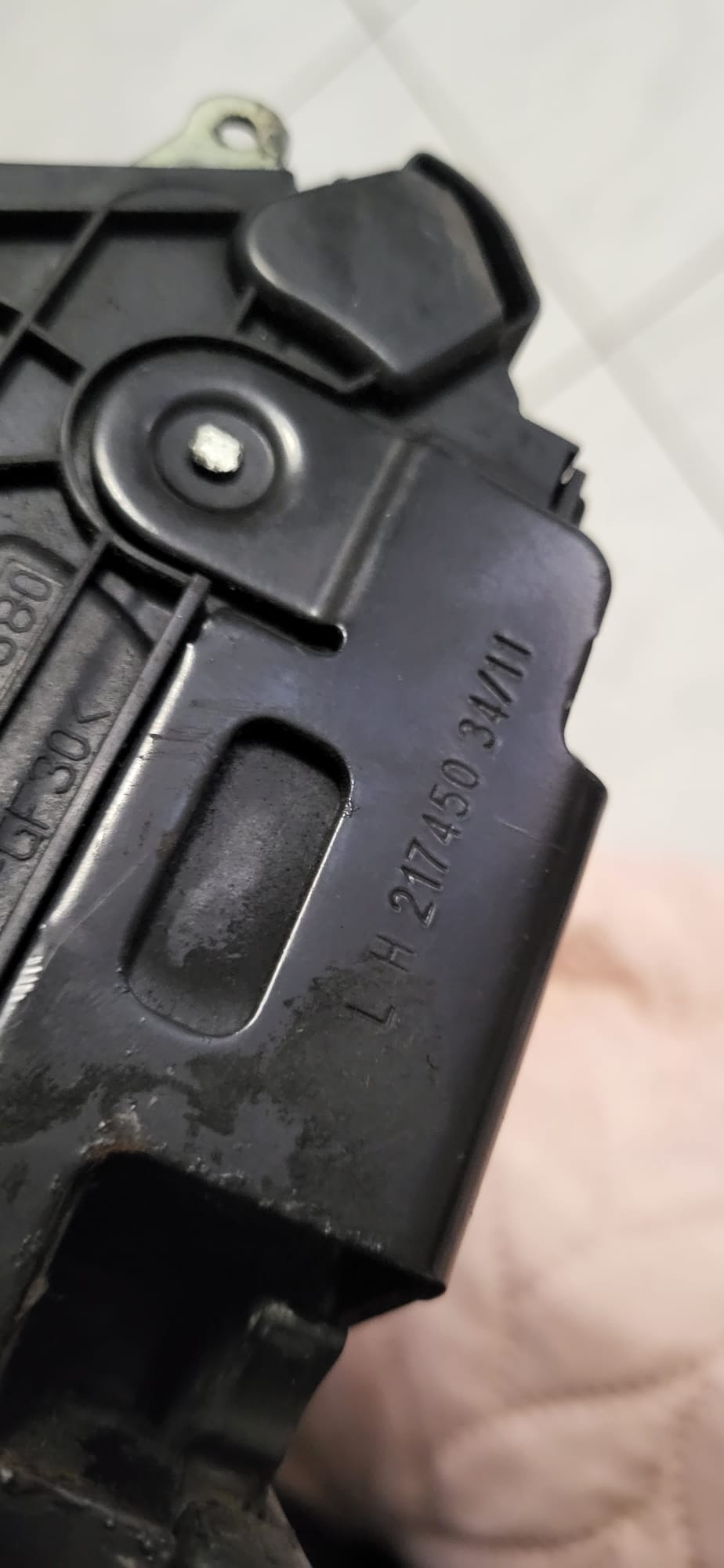

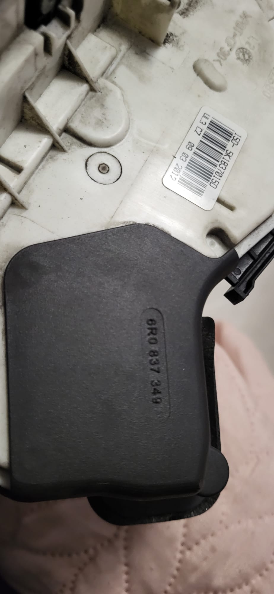

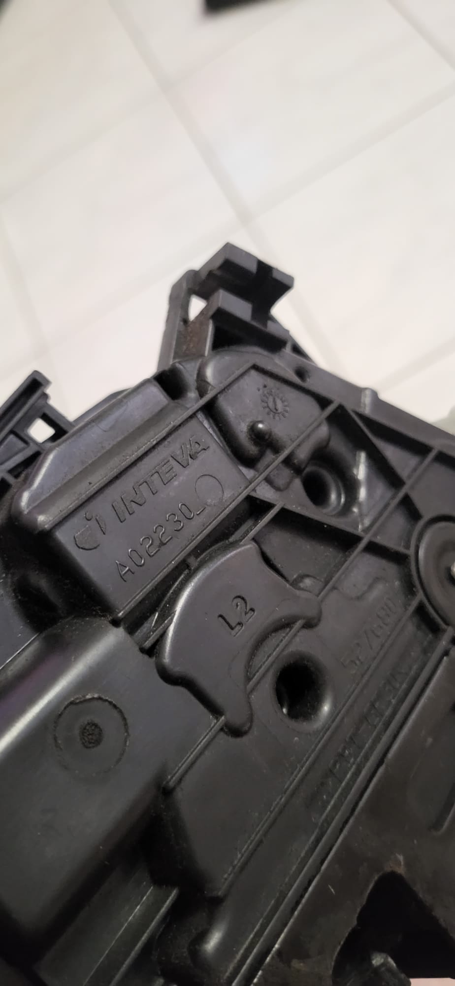

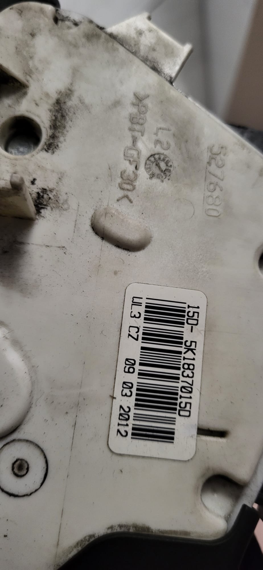

Here are some photos of the original one. What should I look for specifically?
- WhatsApp Image 2023-12-09 at 02.42.00.jpeg (92.09 KiB) Viewed 3925 times
- WhatsApp Image 2023-12-09 at 02.42.00 (1).jpeg (92.75 KiB) Viewed 3925 times
- WhatsApp Image 2023-12-09 at 02.42.00 (2).jpeg (110.32 KiB) Viewed 3925 times
- WhatsApp Image 2023-12-09 at 02.42.00 (3).jpeg (127.88 KiB) Viewed 3925 times

When I check the partnr 5k1837015d, I notice alot of other models also use this door module. So let's say I buy it from a Golf mk7 instead of Polo, could that cause issues? Or does it really need to be a 2 door polo?
- Posts: 9037
Re: Weird central locking issue
You can buy the 'D' or 'H', I don't think you will have problems due to the donor car as long as it is an 'original' part, but I can't guarantee it 100%, you will have to take a chance.
