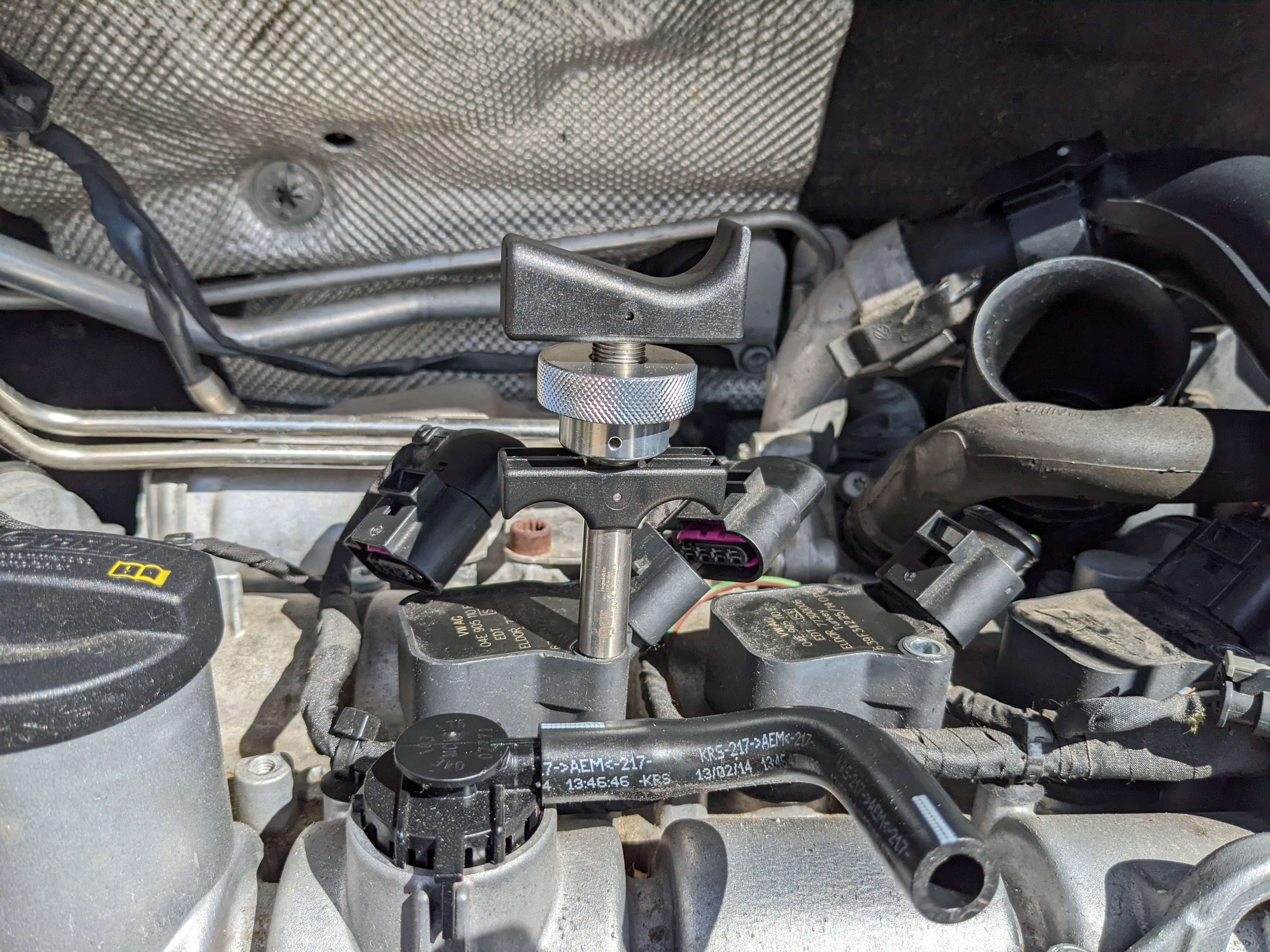

To remove coil pack, do it when engine is hot. Otherwise, rubber will stick to the end of the spark plug and the lower part of the coil igniter will stay in the hole.
This is the special tool to remove coil pack.
BGS one, found on eBay:

Tools worth having for this job:
- the special coil remove tool. Can do it by hand if they're not stuck, but it's worth it to have and not need than to need and not have.
- long socket spark plug, but a regular 16mm plug socket will do. Try and get a magnetic one.
- hose clamp pliers. No more fumbling with channel locks! :)
- silicone paste or plug boot lube
I was lucky and didn't need coil removal tool this time. Just used cable ties.
https://www.amazon.co.uk/BGS-9094-Ignit ... B075DMDLRS
There are others, but not sure on quality. BGS seem to have a proper one.
