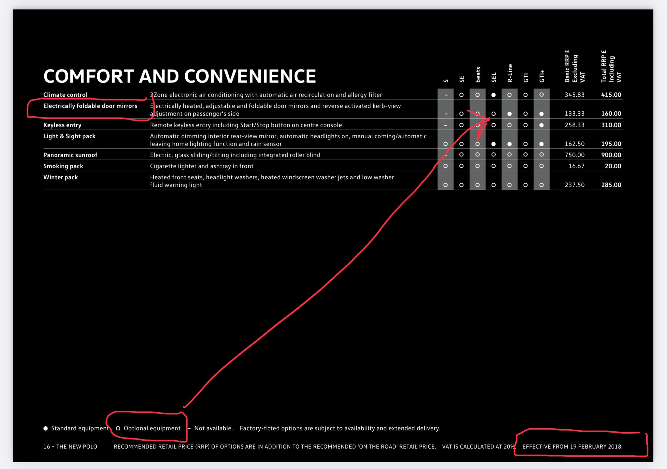

The dipping kerbside mirror was an extra cost option on a 2018 SEL model (it was only part of standard equipment on the R-Line and GTI+ models) - see screenshot below from the Feb 2018 Polo price and spec brochure;

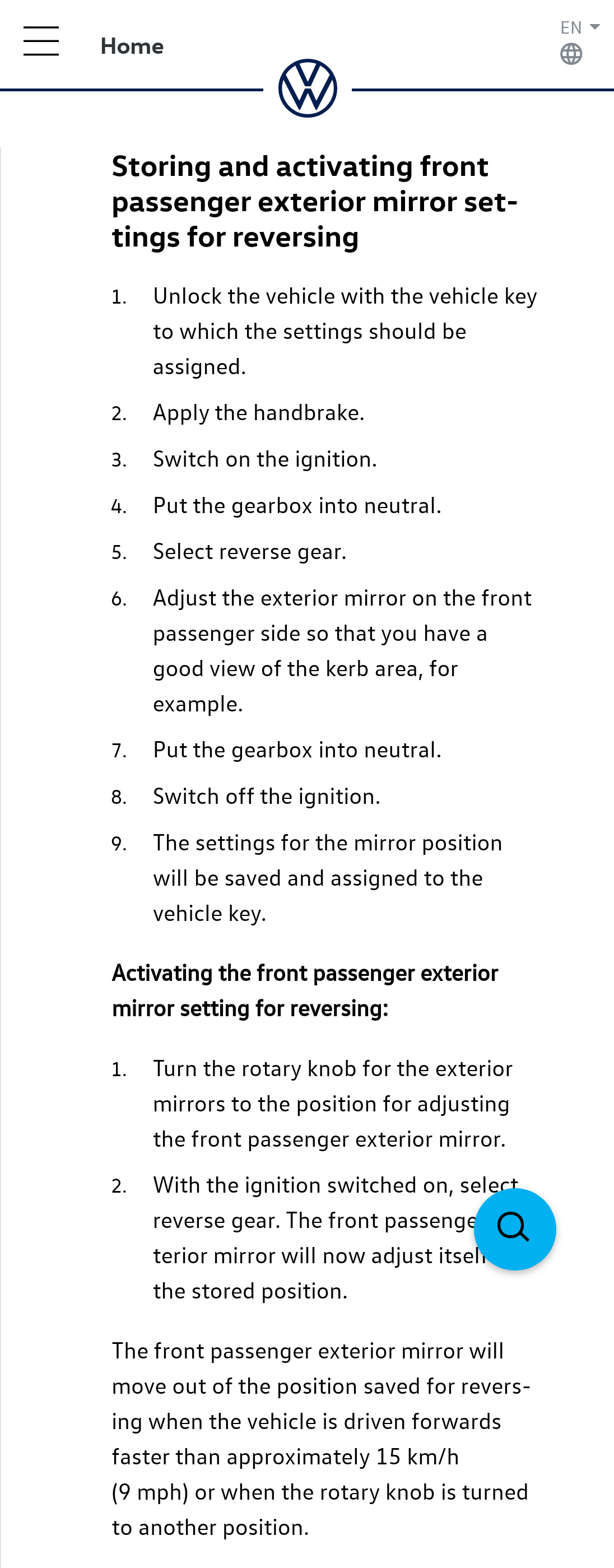

If your mirrors have the electric folding function, then you should also have the dipping kerbside mirror. If your car does have this [dipping kerbside mirror] option, then it needs to be set up before it will work irrespective of whether or not it is ticked in the vehicle settings menu(s). From memory, the procedure is as follows, but best to check your owner’s manual in case I’ve got the sequence of steps in the wrong order;
Once set up, the mirror adjustment control on the driver’s door needs to be in the ‘L’ position when reversing for the mirror dip to work (I keep mine set to ‘L’ unless I use the mirror heating function or fold my mirrors in when driving in/out of my garage). After using, the mirror will return to the pre-dipping position when you switch off the ignition or drive forward and the speed of the car reaches approx 9-10 mph.
- Switch the ignition on but do not start the engine
- ensure the mirror lowering function is selected in the vehicle settings
- Set the mirror adjustment control on the driver’s door to ‘L’ (i.e. the kerbside mirror for a right hand drive car)
- Select reverse gear.
- Adjust the nearside / passenger side exterior mirror to the required position so you can see the kerb
- Put gear lever into neutral
