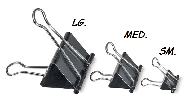

just to add today i used a large binder clip, take out the skinny metal springs from one binder clamp.
use silver part
Insert it in the cigarete lighter in the groove on the right and left, and then just put your key blade in the middle so the two metal pieces spread out a easily pull up. no need for force. Then remove the connector from the lighter.
To remove the right ring use a small flat head screwdriver and insert it in the clips they are at 12 and 6 o'clock. Work one clip then lift a bit, then second clip lift, then first clip etc .... no need for force.
1.2w bulb
