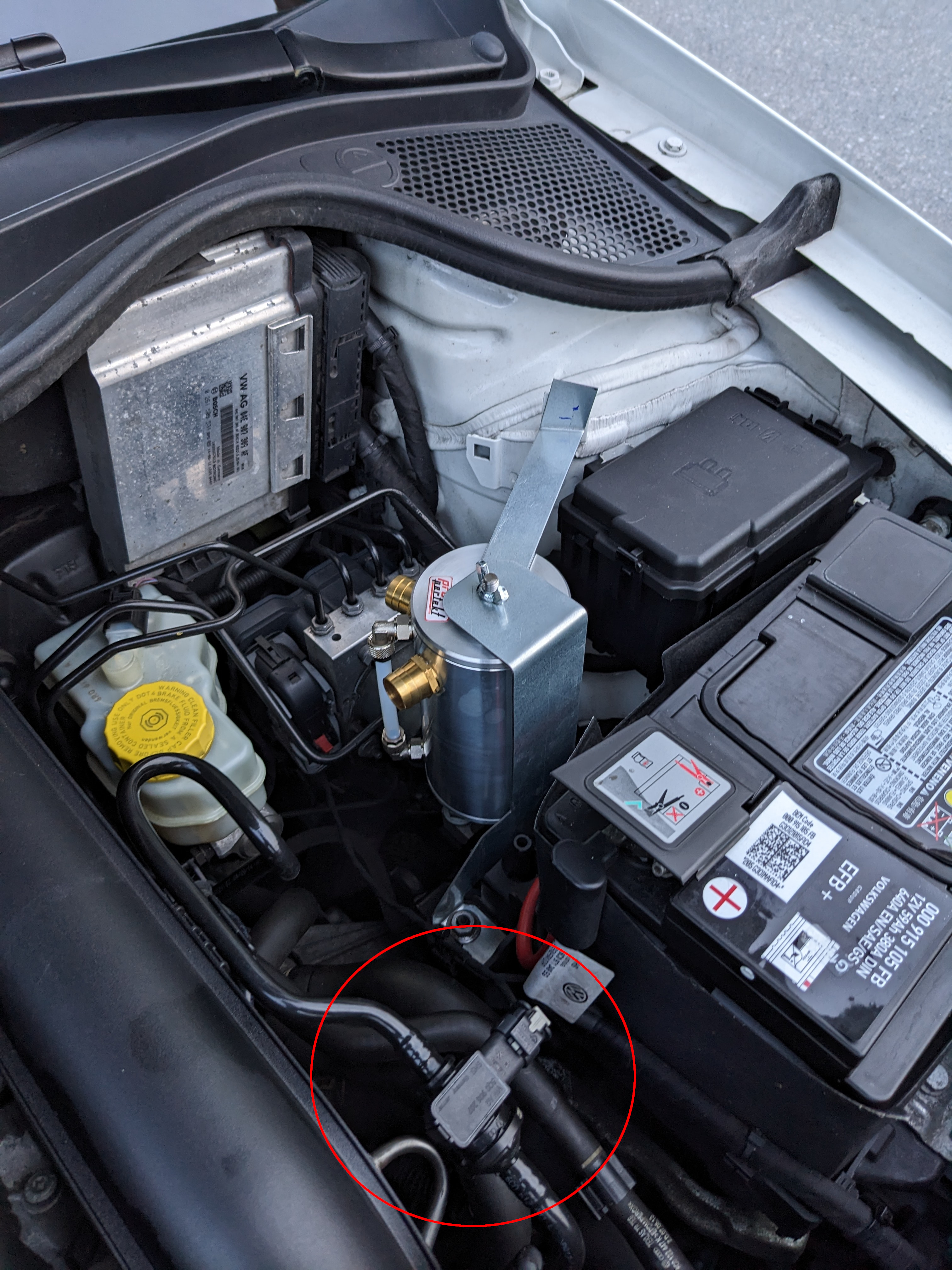

Just looking over pics again.
What is the purpose of this sensor:
It is brake vacuum or booster pressure sensor. Just curious as to what it connects to and what it is used to control.

Post by Le_Combattant »
You are right, It is brake vacuum line ;)

Post by 2226 »
lol well yes, it's a vacuum line. But what's the pressure sensor for?
Can't quite tell from the option codes applicable to CJZD equipped vehicles.
Brake Vacuum Pipe Tube sensor.
Why ?
I don't know :?:
