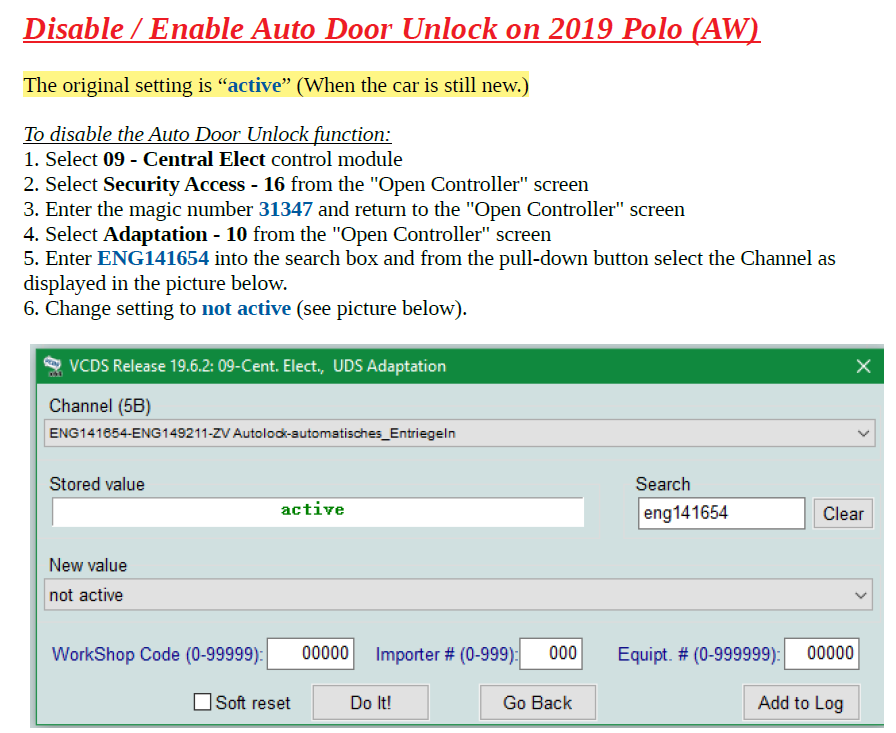

Hello Simonz,
You can disable the "Auto Door Lock at Speed" using VCDS:
1. Select "09 - Central Elect" control module
2. Select "Security Access - 16" from the "Open Controller" screen
3. Enter the magic number 31347 and return to the "Open Controller" screen
4. Select "Adaptation - 10" from the "Open Controller" screen
5. Go to this Channel: "ENG141654-ENG149210-ZV Autolock-Automatisches_Verriegeln_bei_Geschwindigkeit"
6. Change setting to "not active".
This works on my MY20 Polo 1.6 Conceptline.

On the other hand, if you want to disable "Auto Door Unlock when Remove Key", follow the instruction below using VCDS:

I've been trying to do this on a 2020 GTI+ using the above with VCDS.
The setting takes but the car just seems to ignore it and the doors still lock when you hit ~10MPH.
I changed the ENG141654-ENG149210-ZV Autolock-Automatisches_Verriegeln_bei_Geschwindigkeit to not active
Can anyone shed some light?

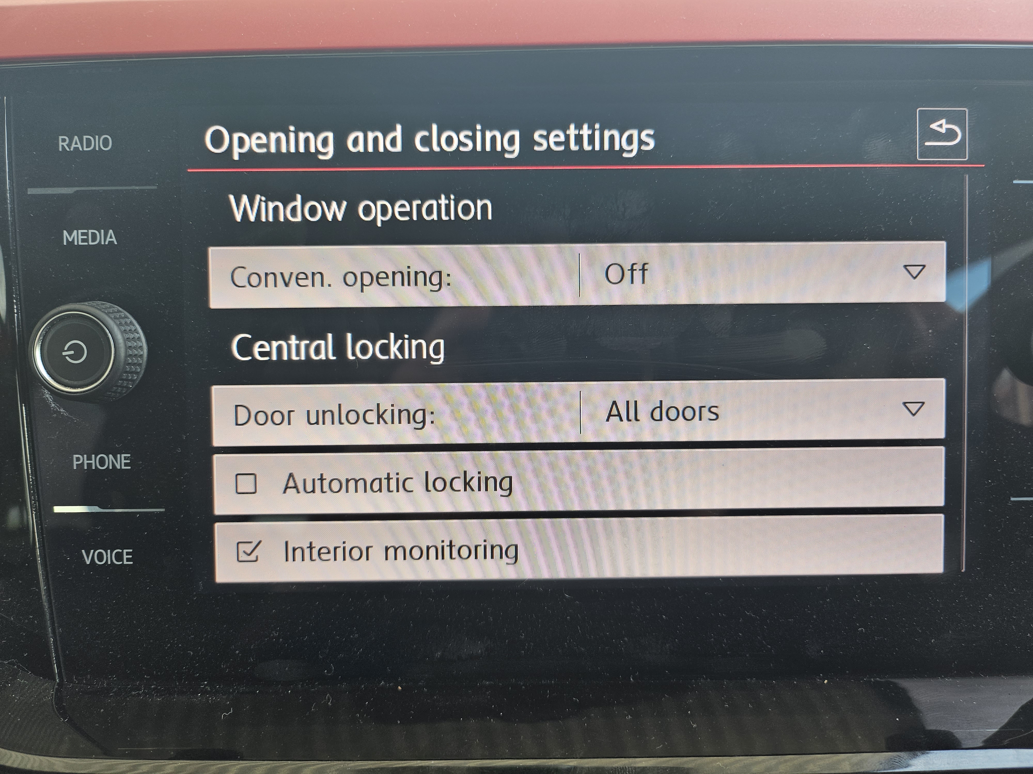

I can adjust this in the radio menu in my car, it's under locking and opening

Maarten wrote: Fri Apr 12, 2024 12:15 pm I can adjust this in the radio menu in my car, it's under locking and opening
That option doesn’t exist on my pre-facelift 2020 GTI+. I had a T-Roc as a courtesy car in 2019 and that car did have the option to enable / disable auto locking in the car settings via the infotainment screen.
Not being able to disable it has never bothered me. If the enable / disable option was there, then I’d have enabled it anyway 🙂.

Probably only the MIB3 models then?
Not sure, both my Polo and my T-Cross (2021) have this option.

Found the solution!
Changed
ENG141654-ENG149214-ZV Autolock-Menuesteuerung ZV Autolock-Unlock
I can't remember what the option was called, something like optional or similar. It's obvious anyway.
That puts the item in the menu, where it should have been in the first place, IMO.
This is on a 2020 GTI+ keyless. I love VCDS!
