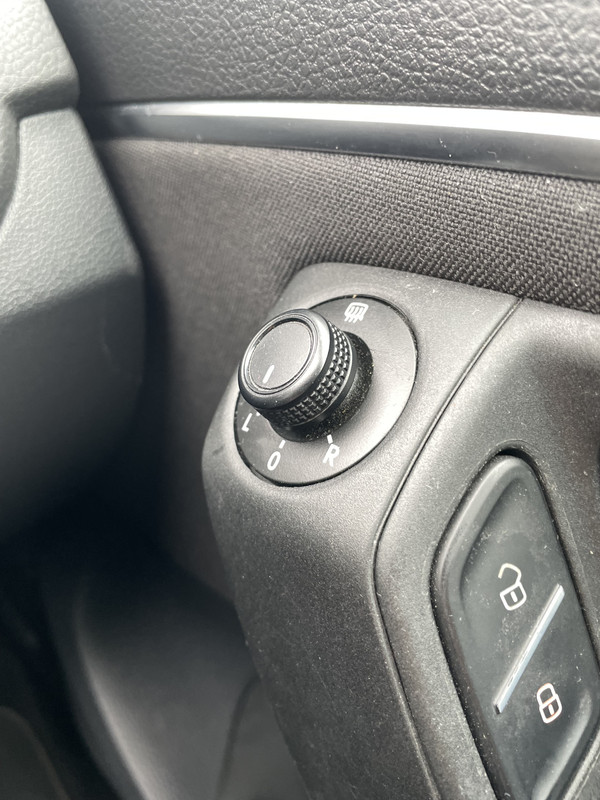

Forgive my ignorance but does this come under manual (6XB) or electric (6XD)? lol.

Posts: 9037
Re: Polo 6C wing mirror glass (UK)
6XD, obviously.
For manual adjustment there are no switches or electrical wires, it is done by means of flexible metal cables and with your own strength you move a knob so that the mirror moves.
It is similar to the driving force of some semi-ancient ships that used slaves to row in the galleys, that is, in the case of manual mirrors you are the slave. :lol:

I asked as I never seen any Polo 6C with manual adjustment so wasn't sure if I was misinterpreting or something! Okay thanks, I'll just try remove and refit the glass itself but will see how it goes
